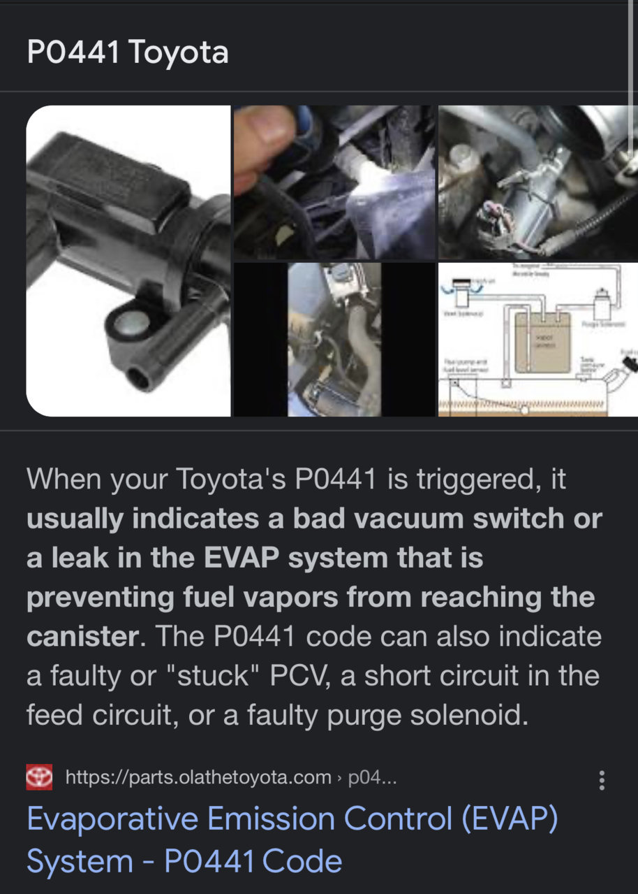

    My truck now has 35k miles and for the last few thousand miles my truck has intermittently thrown the p0441 code for improper purge valve flow or something like that. I clear the code and it will go away for a while (weeks at a time) and then come back at random.
    The only thing I have noticed is it seems to happen when it's cold outside (below 10ish degrees) and rapidly warms up during the day to above freezing. Any ideas? Is this just a quirk of the tundra? The thing that bothers me is that it just started this year and didn't do this last year.

    Not sure which truck you have as there’s nothing in your profile there. As previously mentioned, fuel cap. Secondly, if you’re filling your truck up, then squeezing another couple squirts of gas in to “top it off real good”, you’re damaging the fuel vapor containment system in the truck. Fuel is backing up into the valve that is supposed to contain the fuel vapors (EPA stuff) and ruining the part.

    just posting this for anyone that may come across this in the future. I ended up going to my toyota dealership (hate those places) and they tried to charge me $200 diagnostic fee, plus $220 for the purge valve solenoid, plus labor! I had to stand my ground and may have said a few choice words. In the end, they let me drive my truck away without paying for anything.... though they did not give me the part. I ended up ordering it from sparks toyota for $75. It's a simple 5 minute job... if that. Not sure why mine was bad, but apparently it was. Since replacing it, the issue has resolved itself and gone away.
