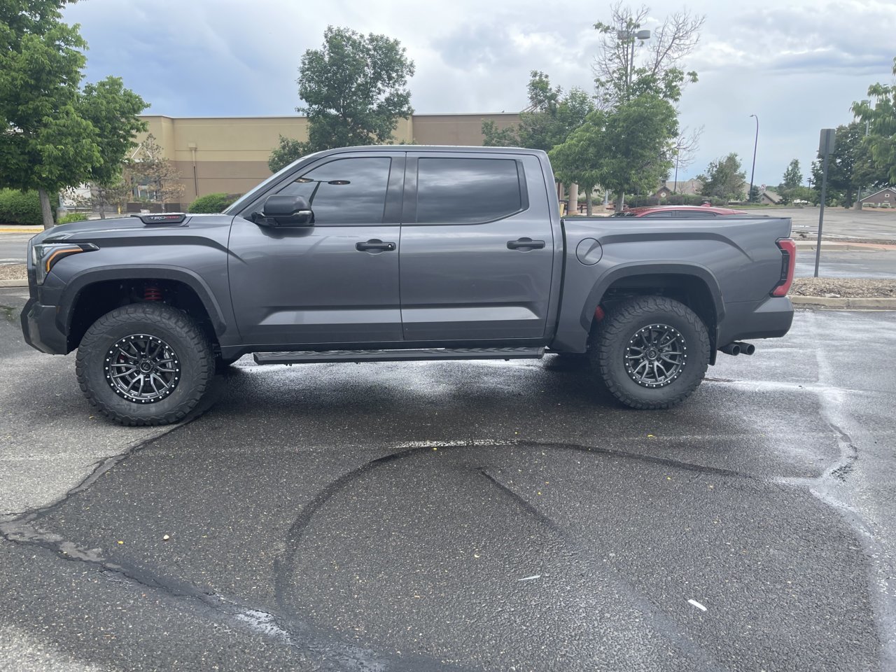

    35 x 12.5 x 18 BFGs, no rubbing on stock Pro suspension, very happy!
    I know it doesn't really show in the photo, but there's a quarter inch gap between tire and mud flap, no rubbing at all.

    no mods at all? Good thing about K02's is their 35x12.5 is actually 34.5" in diameter i think.

    No rubbing? Put it in reverse, crank the wheel all the way left or right, and go over a slight bump, like at the end of your driveway.

    Yup, BFG's run small

    Yep, no rubbing at all even at full lock over bumps, its a tight fight, but as some pointed out, KO2s are not true 35s, they are indeed 34.5" OD.
    This is a stock TRD Pro, didn't want to modify suspension at all, so very happy with this setup!

    I am getting my 23' Tundra TRD Pro in August and plan to also put 35s on the OEM TRD Pro Wheel. From what I have read, it is an 8 in-wide rim. On your truck it appears you put the KO2 35 which has a 12.5 inch wide tire. Is this a problem that could cause an easier blowout etc? Apologies as I am new to mods etc.

    Some tire shop might not install them for liability reasons.

    I've read you don't want to put 12.5" on 8" wide wheels. They should be at least 9" to support that tire size.

    I also just but 35s on stock rims I believe they are 8.5inch wide

    I added a 2.5” Pre Load Collar on the front, 1” puck on the back from Westcott Designs, 18x9 Fuel wheels with 35” BFG K02s, had a slight rub on front mud flaps at full lock, removed flats with zero issues.

    How is the ride quality with Westcott spacer, also they say 37's will fit the pro with the 3/1" lift? Did you look at that at all?

    I think the ride quality didn’t change much, if any. If I remember correctly, Westcott offered 2.5” in the front, now the website has them listed as 3”. I didn’t consider the 37”s, Westcotts description said 37”s would have required some mods to the wheel wells
