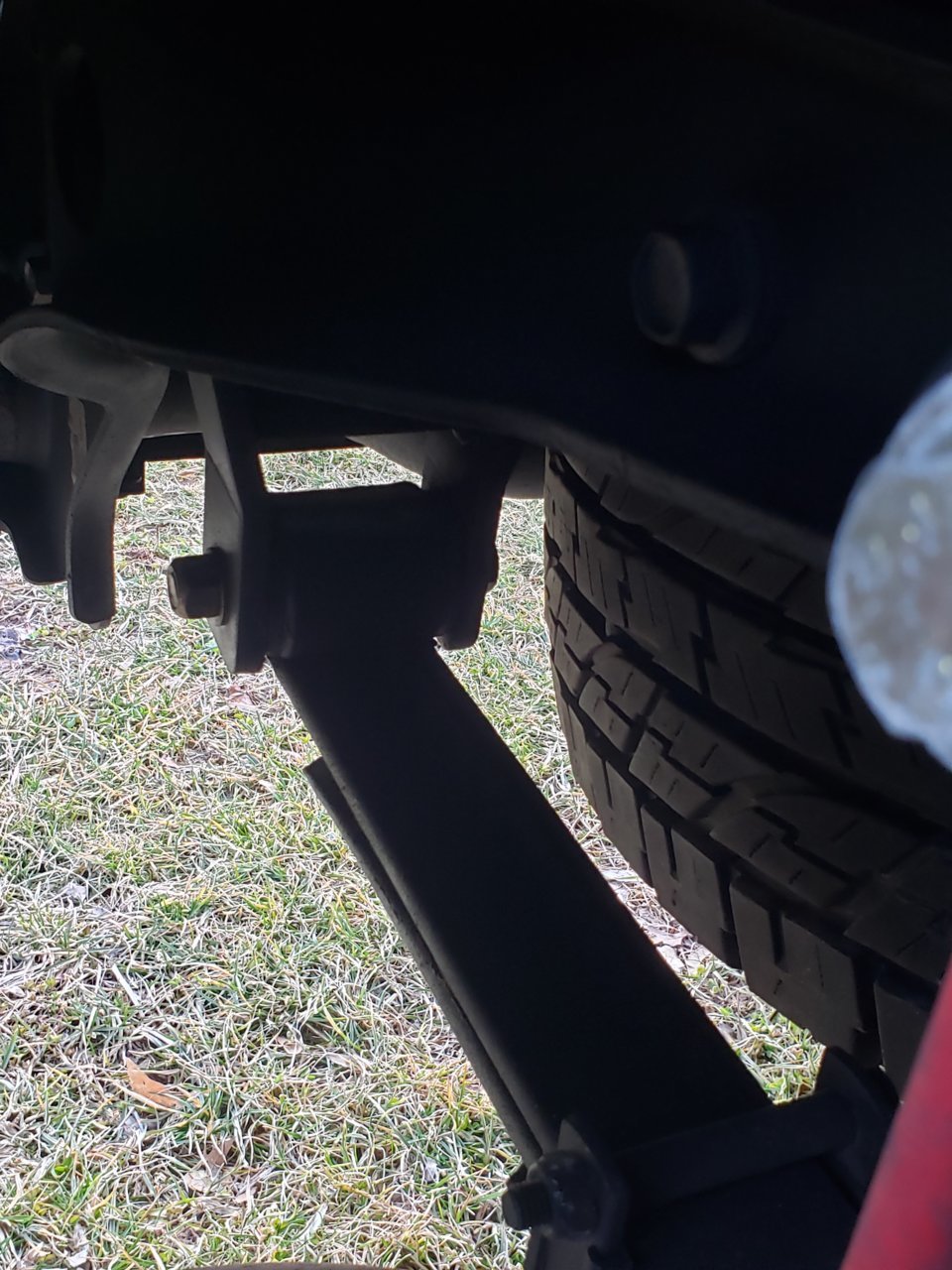

    Nice, how much space would you estimate in between tire and shackle bolts? Also is that a 35x12.50?

    Actually a 295/70/18 STT PRO 34.8x 11.5 got that size so I could use stock spare rim. About 3/4 " if I lift it real slow .On truck are 35/12.5/20 , and most 35's really only measure about 34.5 - 34.8.

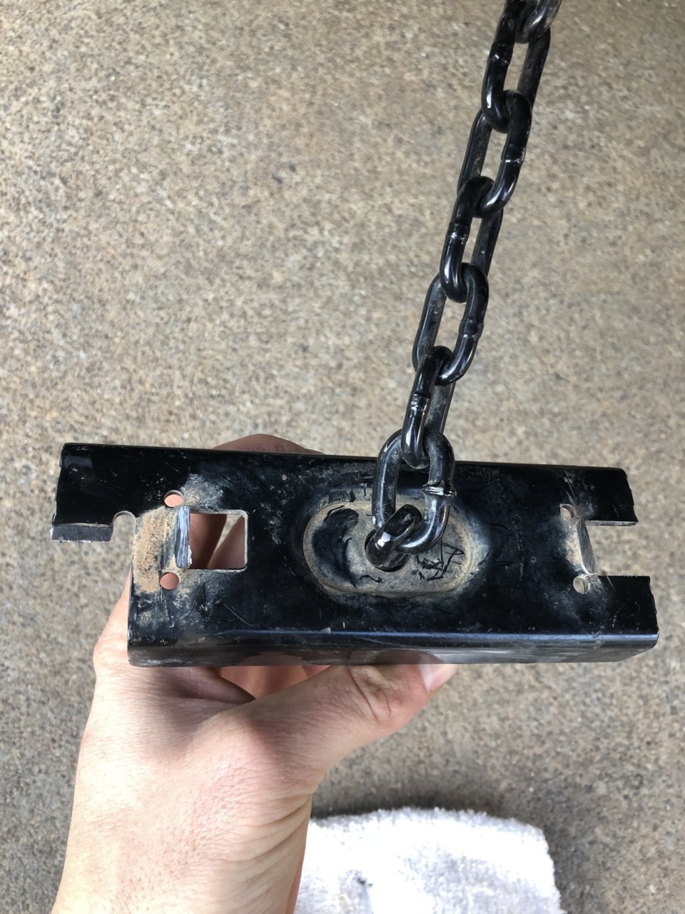

    I wouldn't worry about it , just raise it slow and line it up , tighten up and check it every now and then. Almost forgot did you cut out the brackets already, that lined up the original spare?

    Yes I drilled out the rivets and removed the tabs completely. Thanks man

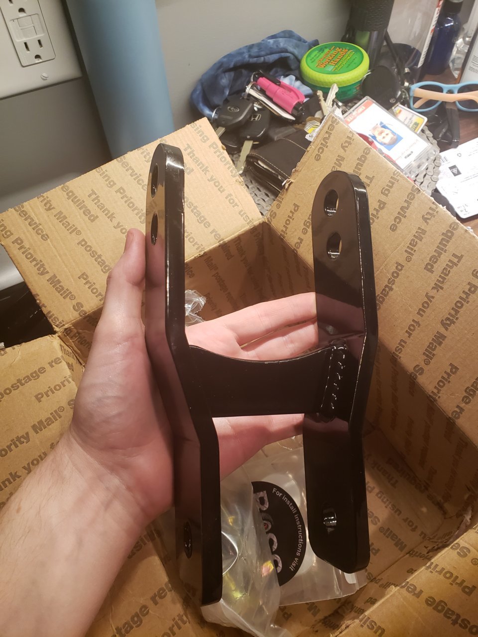

    Haha I understand. I actually only set mine to 1" of lift with my Dobinsons leaf pack to keep some rake too. It is a super beefy shackle. I snagged this picture when I was leaving work. I was in my nice clothes though so sorry I didn't climb under the truck :D I can always get more pics and maybe a measurement for you tomorrow.
    The first picture is when I received them, just so you get the idea of what they look like in real life.

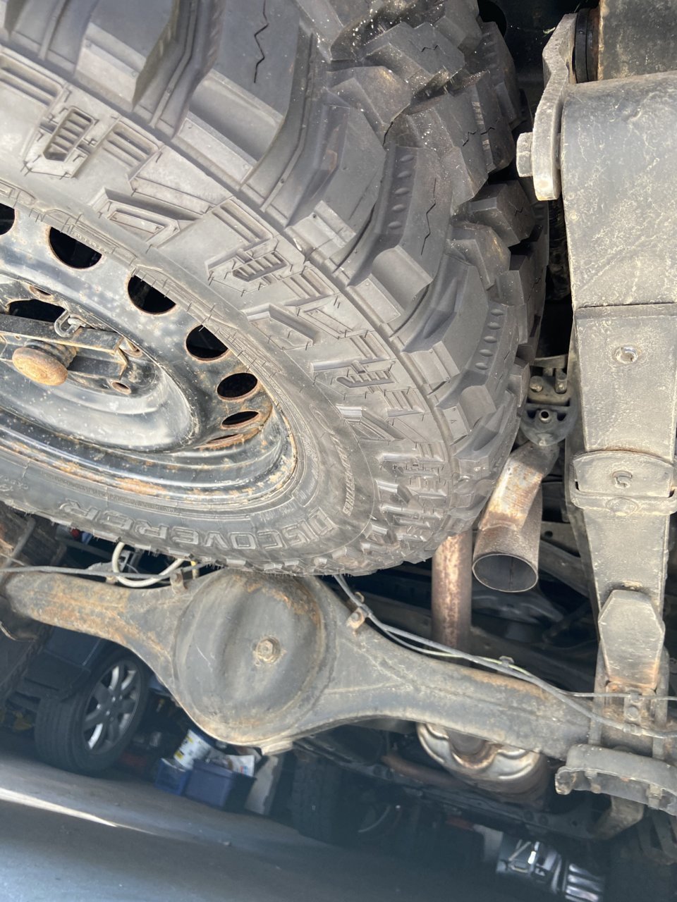

    i bought a full size spare wheel cause the price was right. Exhaust doesnt need to be dumped, but i might cut it at the last hanger for better clearance off road. I cut the tabs on the tire pulley (part that actually holds the wheel and put some adhesive foam on it to prevent marring up the wheel. Also put some foam tape up on the cross members where the spare’s sidewall hugs against. Hate the marks it leaves on spare tires. We’ll see if it worked
