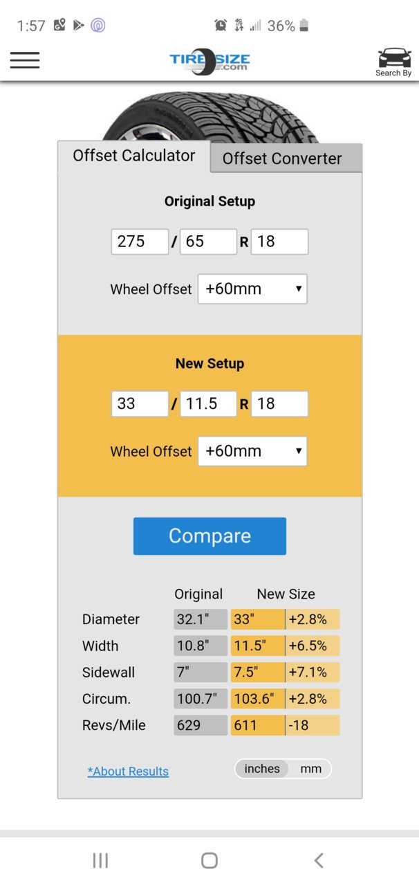

    Turn your steering wheel left full lock. Measure clearance. Input your current wheel and tire size to give you some comparison.
    18x8 +60 (TRD, Toyota Oem)
    33×12.5×18

    How accurate is this? It’s saying the factory size is 33.6? I thought it was 32.1?

    What size tire do you currently have?

    275/65-18 +60, trying to put 33/12.50-18

    Original is 32, 33 is there new.

    Yea I got it now, I had the numbers reversed. I think it would fit height wise, just don’t know if it would hit the upper control arm
