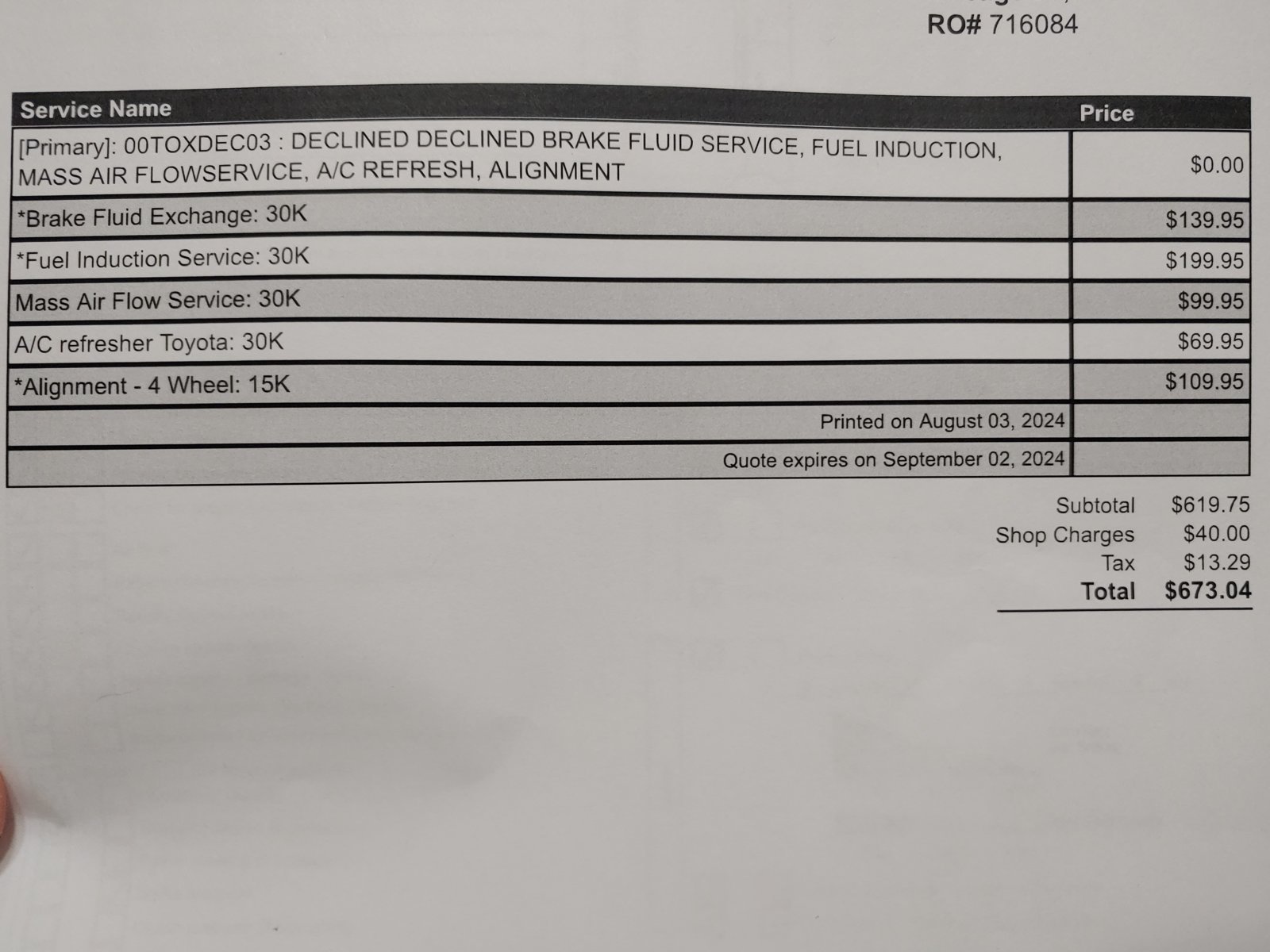

    Hello everybody. Hope everyone having a great Saturday so far. I took my 2021 sr5 crewmax for oil change this morning. Service adviser when he was checking me in was talking to himself saying " I wonder why they put this on your last service visit" I asked whats that. He was explaining my last service visit which around 20k and was only checking fluids and rotating tires. But service advisor back than requested 30k service which includes everything in that attached picture. He said not to worry about it since your truck has only 25k as of today but we highly recommend doing all these on your next visit. So they just change the oil today.
    I always traded my vehicles before doing any kind a services like this but I wanna keep my tundra as long as possible. Please look at the attached picture and let me know how important to get them done and also which ones I can do at home myself. Unfortunately total price they gave me close to half of my paycheck. Im not really great on vehicle maintenance but if I have some directions I believe I can do it.

    You can do everything but the alignment at home pretty easily for a fraction of the price.

    Thank you for the quick response. I knew I couldnt do the alligment but do I really need it? I mean truck drives straight not pulling either side there are not any uneven wear on tires.like I said I'm not really professional or have much knowledge about it.
    And do I need any special tools for the rest of the things if I decided to the at home myself?

    I work as a service advisor at Concord Toyota in California.
    based on Toyota’s guidelines for service intervals and how I sell services to my clients
    Brake fluid exchange should be performed every 3 years or 30k miles. This is preventative maintenance. Brake fluid is hydroscopic and will build up moisture in the braking system over time, which lowers the boiling temp of the brake fluid making it easier to overheat and experience brake fade. Also heat will make the fluid break down and turns it a maple syrup color. New fluid should look like light colored apple juice.
    Alignments once a year, 15k miles, or as needed if the truck is pulling. More so if you are off roading or drive on California roads as we also consider this off-roading.
    fuel induction service is really only needed on high mileage services, if at all, I won’t ever sell these unless the truck is having drivability issues or poor performance.
    mass airflow cleaning every 30k is really only needed if your off-roading often. Same goes for a throttle body cleaning.
    as far as A/C services, I don’t recommend touching it unless your having issues or excessive odor (that musty wet laundry smell)

    Brake fluid service is very important. Every two years for this guy regardless of mileage.

    Always interesting to hear different experiences in these matters, including from a current service advisor.
    Here is the list I was given recently for 30k service when I went in for an oil change at 27k miles -
    Alignment - $169.99
    Fuel Emissions Service - $259.99
    Brake Fluid - $159.99
    Power Steering - $209.99
    Front Diff - $169.99
    Rear Diff - $209.99
    Transfer Case - $169.99
    Oil Change + tire rotation - $129.90
    total - $1479.83 + tax
    I didn't have any of this done at 27k as this particular dealer seems to be more aggressive in pushing such services. From what I've gathered in the past, fuel emissions and power steering fluid might be recommended but certainly not necessary at 30k miles. And for whatever reason, the cost of differential and transfer case fluid is considerably higher at the smaller town local dealer - about 3x the cost of a dealer in a larger town.

    I don’t recommend power steering fluid service until 60k miles, even then, most times it still looks good.
    doing the diffs and transfer cases at 30k is somewhat dependent on how the truck is used. I’ve watched that fluid get changed at 30k on a truck that never touched dirt and it still looked dirty. But I’ve seen similar fluid at 60k on a truck that off-roads often. From what I’ve seen I’ll be doing mine at 30k. These are drain and fill services so easy enough to do at home.
    my advice, crack the fill port open first and make sure you can remove the plug, THEN crack open the drain. Last thing you wanna do is drain it all out then realize the fill port is seized or stripped.
    those fuel emission services are bullshit. If you’re worried about carbon build up on the valves buy high quality gas and throw in a can of sea foam in the gas tank every 3 months.

    $140 for a real brake fluid exchange? I'd pay that. I have a feeling the only fluid getting exchanged is what's in the MC reservoir. It takes me a couple of hours to complete the job and over 1 qt of fluid. But I am cautious and not on the clock.

    I believe thats what they do just drain the reservoir and refill. Not sure how much fluid goes in there but you might be right $140 not bad after all.

    Hell, I'd do that for 10 bucks. A proper way to exchange the brake fluid involves pushing or sucking fresh brake fluid from the MC to the caliper bleeders and it's a lot of work. Sucking old fluid from the MC with a turkey baster and refilling with fresh for $140 is a rip off. That's a 5 minute job.

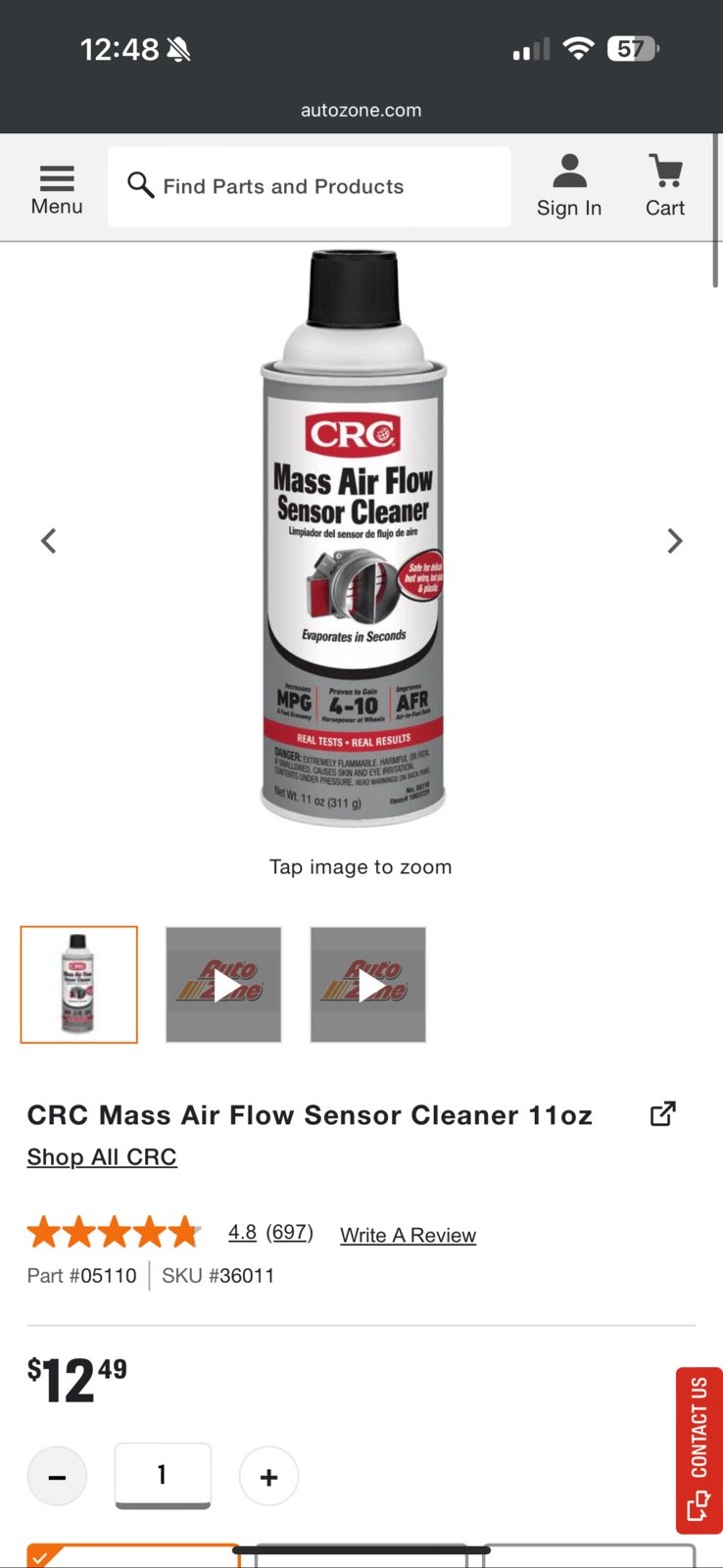

    49
    I watched similar video little while ago and I couldnt believe how easy to clean and maintain that sensor. Definitely not gonna let dealer do that. I'm not really good with vehicle maintenance but I can spray some cleaner and let the cleaner do its job lol.

    its sort of like how dealers charge (at least mine tried to before I started doing my own maintenance) 90 bucks to change the cabin air filter. It’s easy money for them for folks who don’t know better unfortunately.
