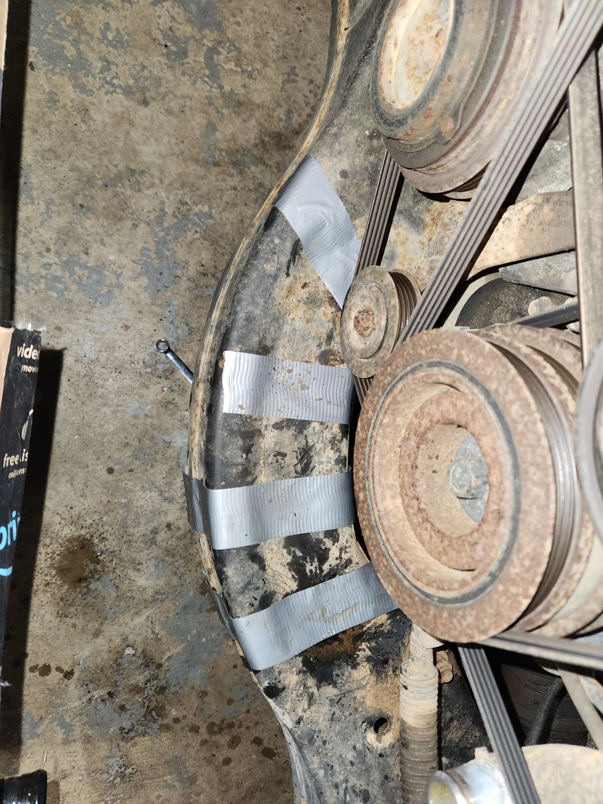

    I know this is a long time coming, but thought I'd just follow up. This is as much for my own edification as it is for anyone who comes across this thread.
    I ended up going with the Timmy the Toolman tutorial (https://www.youtube.com/watch?v=vHC46ypHxWc&t=6247s). It's a bit lengthy, but he really gets into it. He has a part 2 addition to the the video that explains how you should bolt on the tension pulley by a handful of threads and then tighten it after the belt is on.
    But he did miss one thing I think was critical, he didn't go over making sure where the belt needed to be set up on the crankshaft gear. The line on the belt needed to be lined up with the dot on the face of the gear. The first pic shows this. I added a little piece of tape to make it easier to see.
    I would also highly recommend getting the harmonic balancer wrench he uses. It's easy enough to use the engine starter to break loose the bolt. But when putting it back on and getting something like 270 ft/lbs of torque, it requires the specialty tool. I ended up wrenching it as best I could by putting the truck in gear with the e-brake on, but still didn't reach the recommended torque. I'm likely pretty close, since I've been driving for a while now with no problems.
    Another thing is that I had ordered the Aisin timing belt kit from RockAuto. But after reading some of the posts here that you should only use OEM Toyota belts, I went to the dealer and got a belt. Upon inspection of what was on the truck for the last 100K miles, it was an Aisin belt and water pump. Neither of which had any noticeable imperfections. That being said, I went ahead and just used the Toyota belt anyhow, but I don't see any reason to not use Aisin products.
    The other thing is to make sure to close off the holes in the front cross member. I learned that the hard way. Thank goodness for the magnet grabber!
