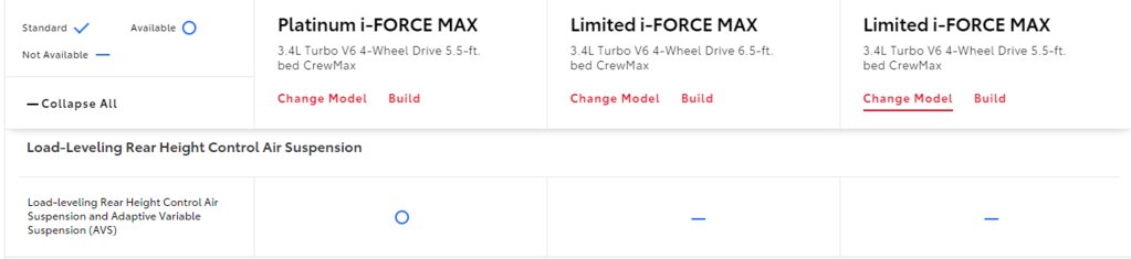

  14. Oct 18, 2024 at 1:13 PM
    slip sinker
    slip sinker [OP] New Member
    Jan 23, 2018
    #12389
    34
    2018 Silver DC 4WD
    This is what I was looking at. Says available on Platinum but not Limited. Maybe there's another package.
  15. Oct 18, 2024 at 1:23 PM
    Breathing Borla
    Jan 21, 2020
    #41531
    6,615
    Northern Illinois
    ya, thats load level AND AVS, only the top dogs get that
    there is only a load level system that doesnt have to have AVS
