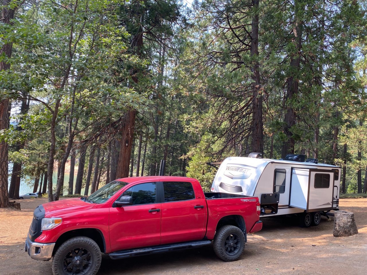

    Hi all. I have a 3/2 lift using 2" blocks in the back. I recently added Airlift 5000s to help with ride quality while towing. It stiffened up my non-towing ride a good bit (even un-inflated) even though I am using the cradles in the bottom instead of bolting top and bottom. I believe the cause of this is the internal jounce bumpers in the bags being higher than the stock ones. I am debating adding Toytec shackles in the rear at 1" to hopefully help improve this. I cannot find any images with 3/3 lifts though, and not sure how I'll like it - the rake might help with the tow too....I am already swapping out my 7-hole Blue Ox shank for a 9-hole to help lower the ball so height shouldn't be a problem. Has anyone done this or otherwise have input? Obligatory pic attached.

    I just thought of something. I think that picture above is aired up and is higher than my normal stance. If I want to know how it looks I can just air up my bags to be an inch higher :). I think it will look pretty good. basically a 3" lift with factory rake. I'm hoping this is a truly my do-it-all truck.

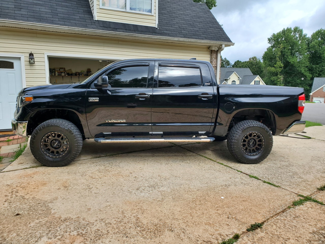

    I used 2" shackles and 1" blocks... My truck rides just like stock. 20200828_104719.jpg
