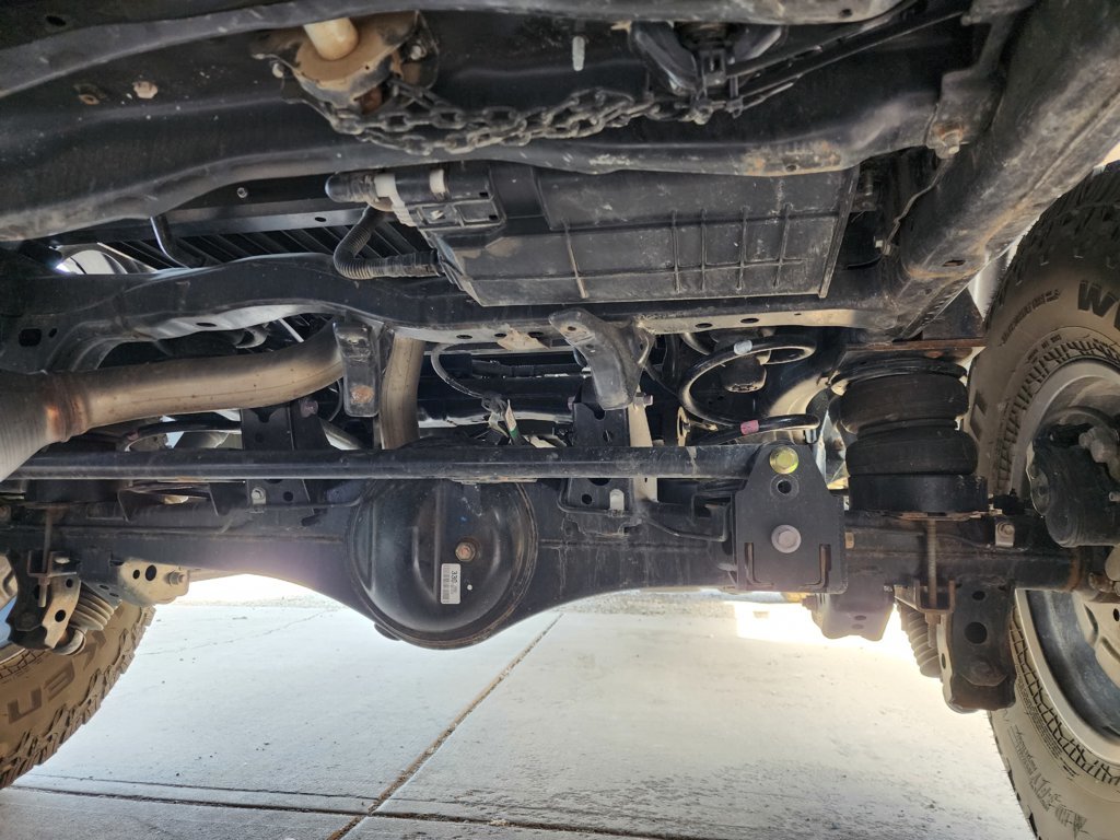

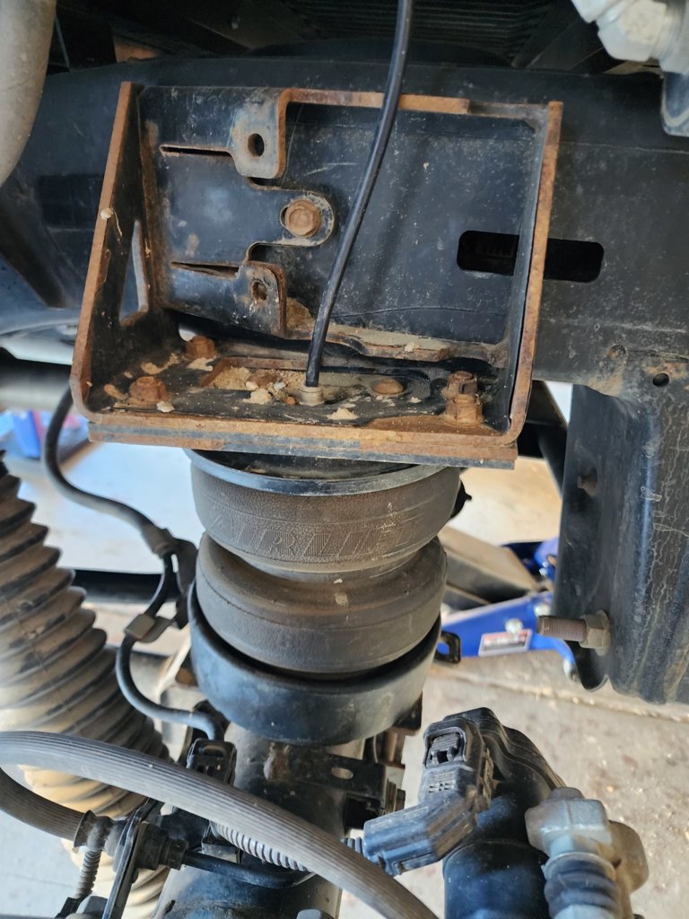

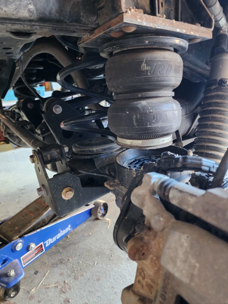

    I have the airlift 5000 with the jounce bumper in them on cradles, it lifted my rear ~1 inch. I don't have the TRD lift but icons up front. The bag and cradle setup works great for me, down travel retained, just enough lift and heavy load support at the push of a button.20241105_112405.jpg 20241024_143118.jpg 20241024_142734.jpg 20241105_112311.jpg

    Thanks for the feedback and pics. Do the bags rest in the cradle when unloaded and wheels on the ground? Also any noise or chatter from the bags slapping the cradles on dirt roads or anything?

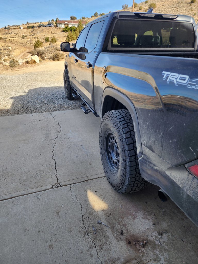

    The bottom pic is ride height with 5lbs in bags, no load in the bed. I live 3 miles up a dirt road and no noise, that I can tell, from the rear suspension. Very happy with the setup.

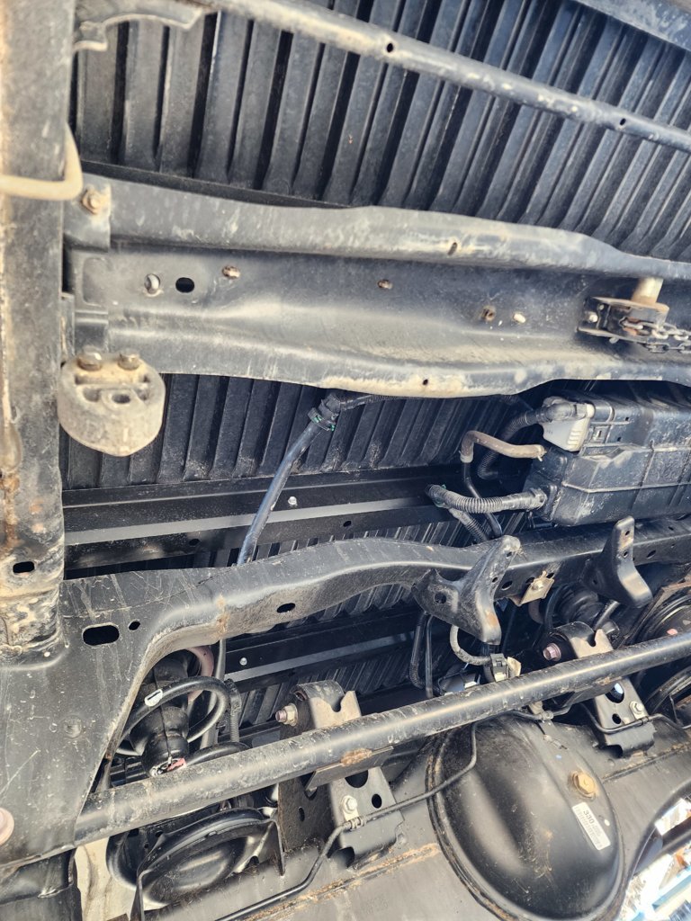

    Has anyone found a good spot to mount the Air Lift EZ mount compressor on a Crewmax 6.5' bed?
    I've seen a few videos and write ups about the short bed but my truck doesnt seem to have those spots available and i'm having a hard time finding a good place to mount it. Seems like the room on the frame is limited and the only decent spot (due to big fuel tank) is very close to the exhaust. Thanks for any input or advice.

    I used the frame above the exhaust exit (6.5 bed). Was the highest "out of the way" spot

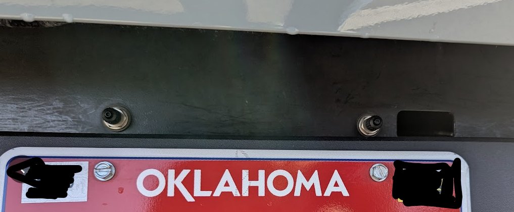

    I have a 24 Limited TRD offroad with the factory lift, that I bought used. I noticed these airbag valves when I was installing my plate.
    Stupid question, but are these factory? ( I can't find any mention in the manual), or did the previous owner install them?

    That is aftermarket. Those should be to manually fill your air bags if they're still installed. To my knowledge Toyota doesn't offer the lift and ride control suspension together, plus they use an on board compressor not manual fill.

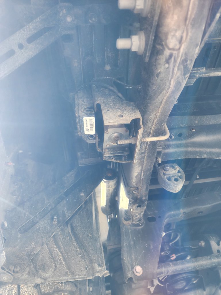

    I've since gone to axle dump exhaust, but didn't see any issues with stock exhaust. It's dirty but works fine.
    Think I'll fab something to move to the spare tire area come spring, or higher into the bed void.20250218_101936.jpg

    Not oem. Someone installed air bags at one point. I'm not a fan of independent fill, but its got its benefits...just got to make sure you have the right amount of air in each at all times.

    Thanks, I guess I need to crawl under there and see what I have installed and how to best maintain/use them.
