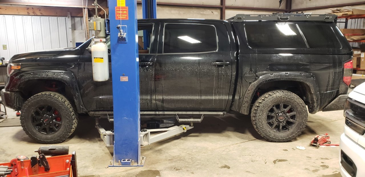

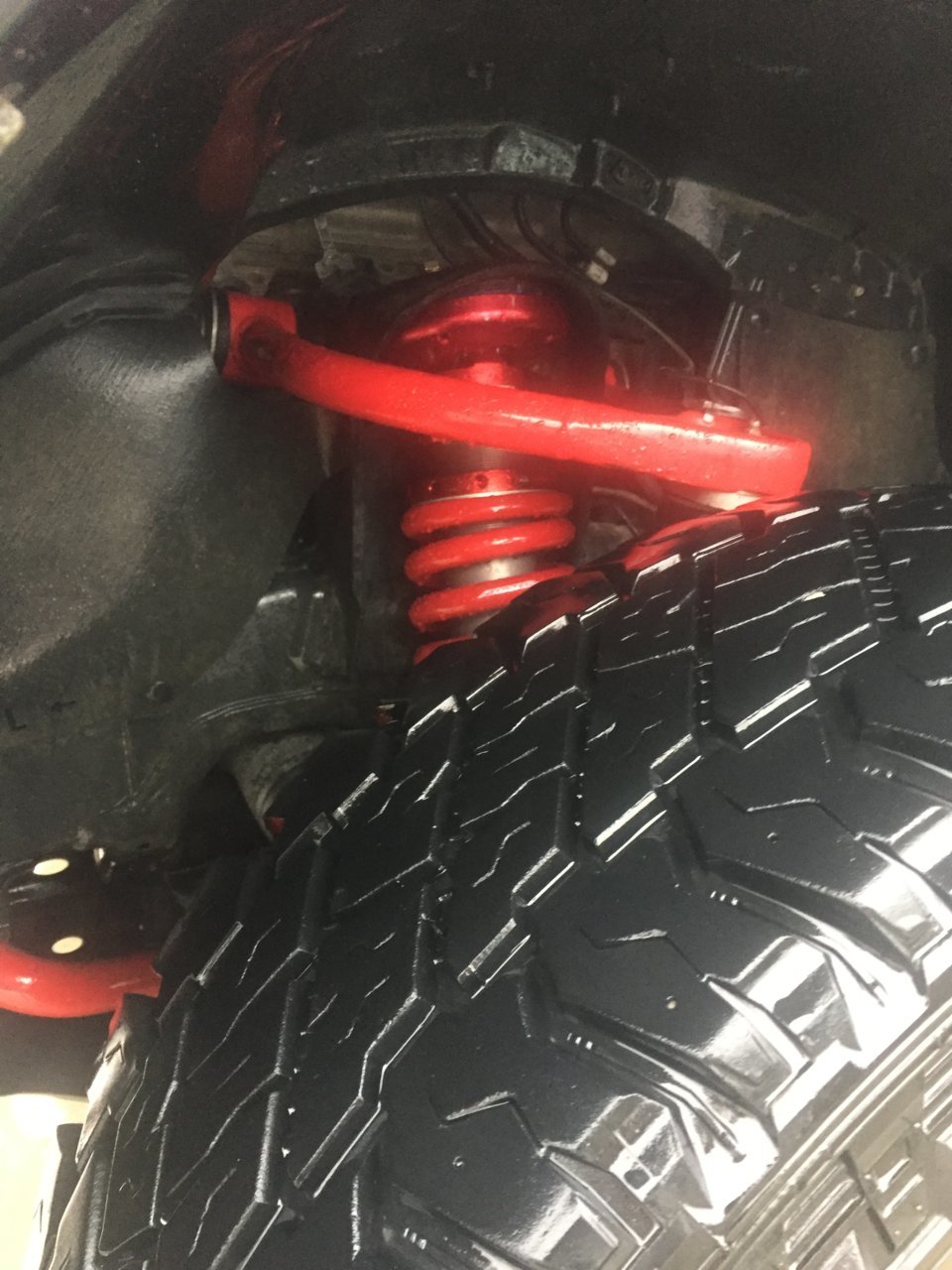

    I just installed the toytec 2.5 coilover with shims on driver and passenger sides taking me to 3 inches with the plus 3 cb shackle in back. I'm slightly nose high prior to my aftermarket bumper. I had 5100's with shims on mid setting with +2 and with added weight in front Dave recommended the upgrade. It is possible may have to do an add a leaf in back...

    You think the weight of your camper shell and all on the bed is attributing to the front end bring up?
    i don’t plan on keeping my front and bed stock, I’m thinking/hoping this shouldn’t be my experience.

    Toytecs are adjustable and are "not supposed to" have shims installed on them.

    Yes he makes shims for certain applications. But it does says right in the Toytec instructions that shims will void the warranty.
