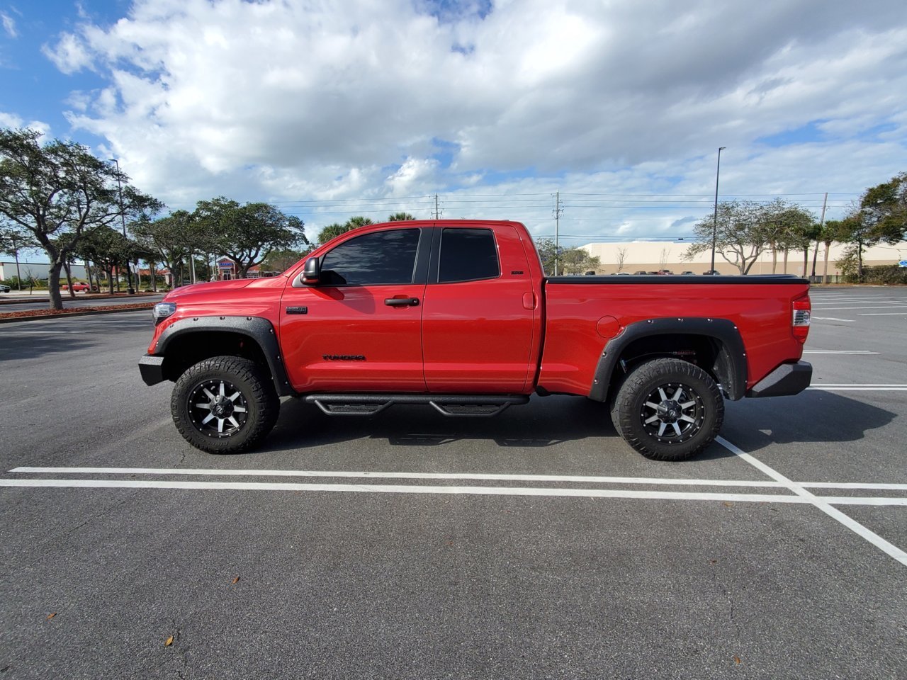

    Alot of them
    Toytec Aluma coilovers, Toytec shackles set at 1.5 along with 1/2 inch axle shims to put me right at 4" up front and 2" in the rear. Sitting dead level. 285/70/18 (34's) Ridge Grapplers on a +1 offset.

    Nice pics guys...very interesting...now I gotta find me a Silver 2wheel drive Tundra
    with the 38 gal tank.

    Tundra234 that's exactly what I want
