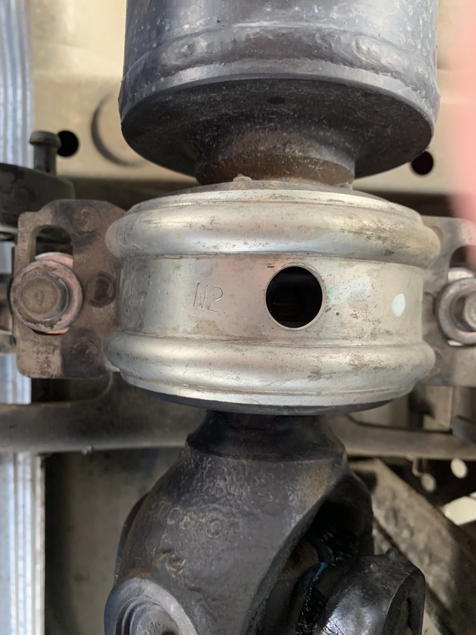

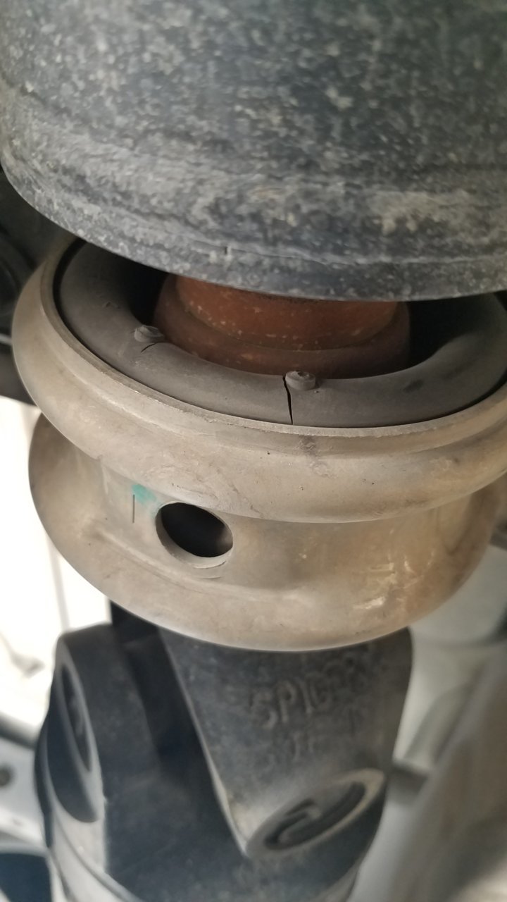

    Should there be any movement if you push it up or down also there is a small crack on the interior rubber part

    But with that crack, I would probably be wanting to replace it. Is it giving you any vibrations?

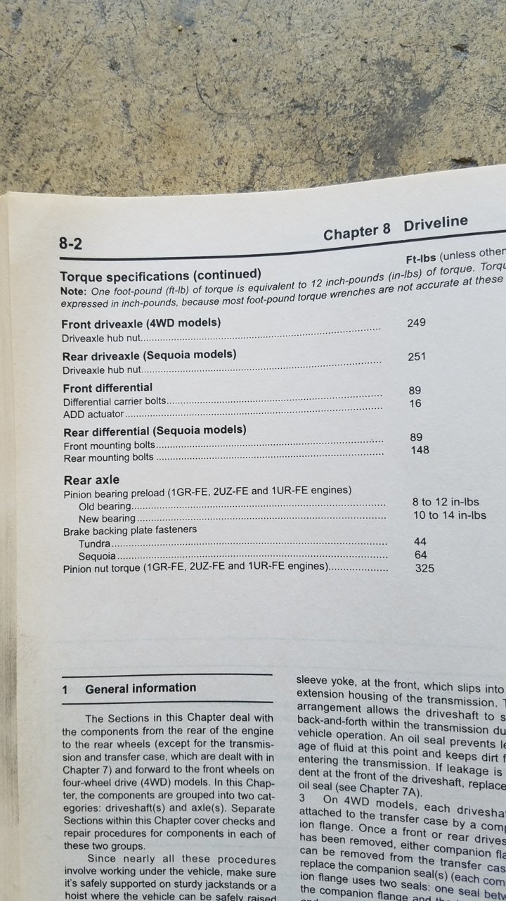

    Do u happen to know the torque on those 2 bolts?

    Not seeing carrier bearing on that though. To be honest I think I just gave them the good old arm torque wrench. I’m pretty strong so I choked up on a 3/8 drive ratchet.

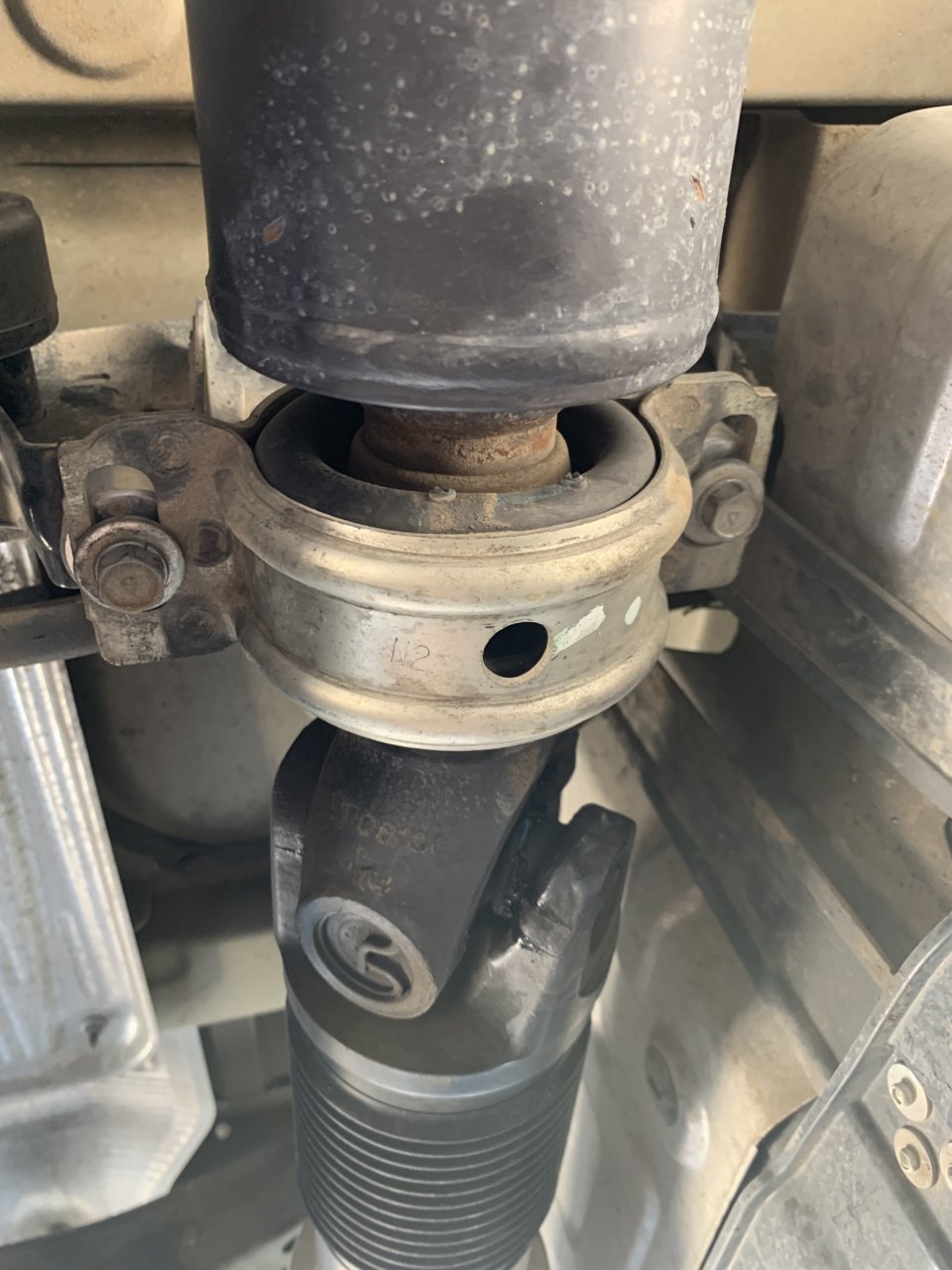

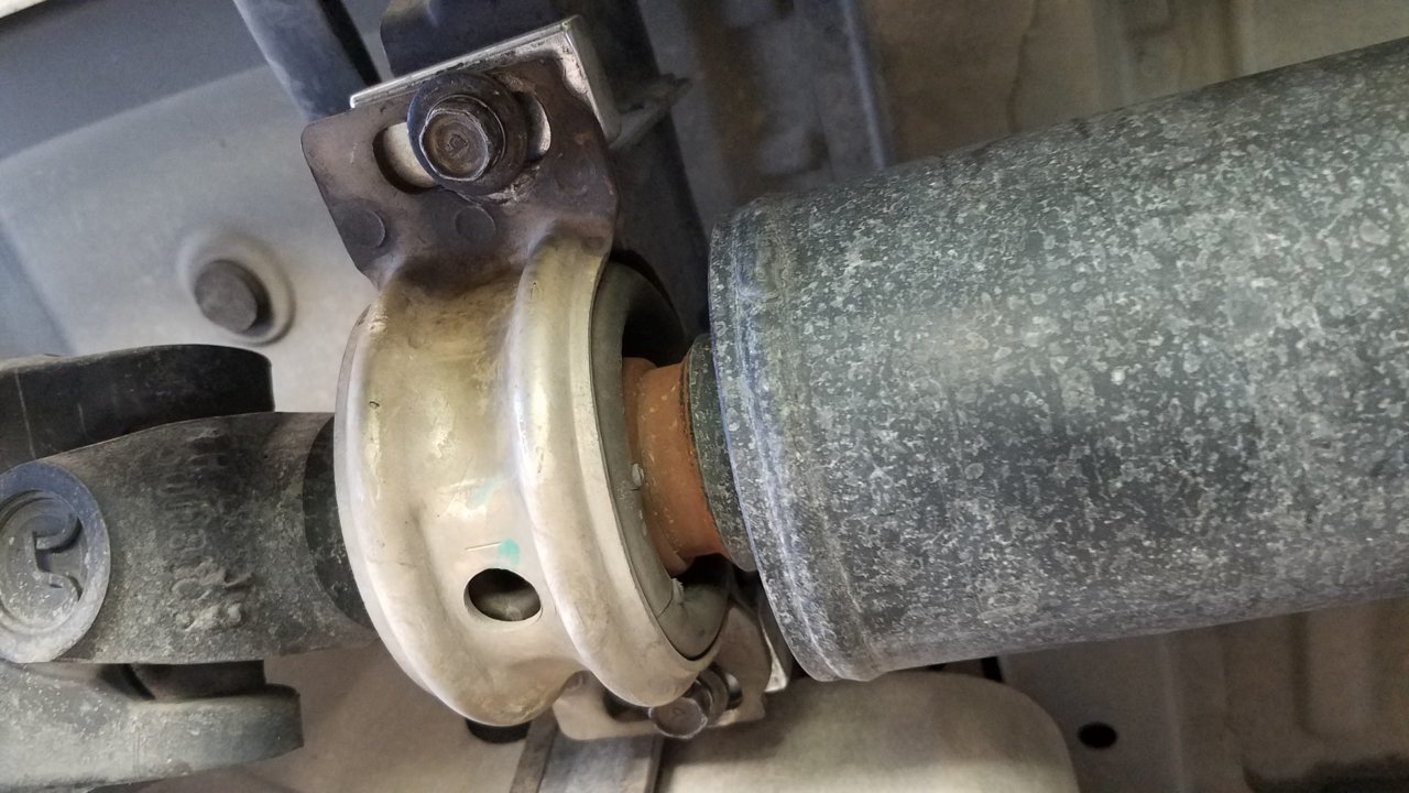

    Well the problem is that when I first bought the shackels and I was going to install the drop kit I loosened both bolts with out marking where they go now that I read the book on how to remove and install carrier bearing it said to make sure you mark where bolts were so the drive shaft can be balanced but I did not do that. So now I'm wondering how I can balance it?

    Right because the carrier bearing has slots so you can move it from front to back. I think I did mark the position or at least put them where the bolts made a mark on the bearing flange. It bothered me to do so,Because I’m the type that would center the flange perfectly.

    Here’s mine for reference. Bottom of the picture is towards the back of the truck.961B90CC-1D9D-43AB-8523-7430E2C09955.jpg 878C8730-6A02-4D32-A38B-C659F5F383D9.jpg
