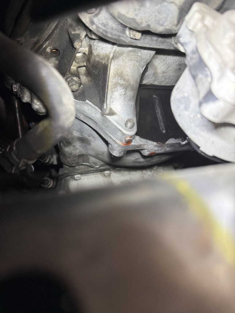

    A couple of days go by, mind you I dont drive this as a daily and I again noticed oil from the bell housing near the dust plate (pic for reference)IMG_4210.jpg
    It was hard to tell at the time but clearly pinkish/trans fluid.
    Brought back the truck and had them “check it out” and was advised it was trans fluid. Mind you, the audio message was that they checked a “few things” cleaned it up drove it around and are not able to see any more trans fluid leaking. Upon my research, it appears this could be a trans input shaft leak from shotty work during the rear main replacement.
    They were also unable to recreate any temp fluctuation while test driving the vehicle under various conditions.
    I’d like to get anyones opinion honestly. I feel as though they are tired of dropped the transmission to determine the issue. If I recall correctly, the trans lines run through the radiator on these things but, was told the fan clutch and power draw was a ok for the ac/cooling.
    Ill be calling them tomorrow to go further into what they did but, in the time being would love to hear what anyone has to say. Thank you.

    Is it ATF or Toyota coolant. Coolant is reddish/pink and feels slippery. If you wet your fingertip and touch to your tongue it has a sweet taste. ATF is oily. Pan gaskets don’t usually leak unless it’s ever been opened. Check the hoses to the cooler and anything bolts to the tranny. There is an inspection cover used to access the flex plate bolts and you can open it to look for ATF in there which would indicate a front seal leak but again rare in our trucks. Coolant can leak from the water pump, one of two o-rings in the valley and weep out the back on the bell housing or an number of coolant hoses.

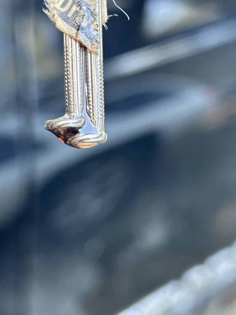

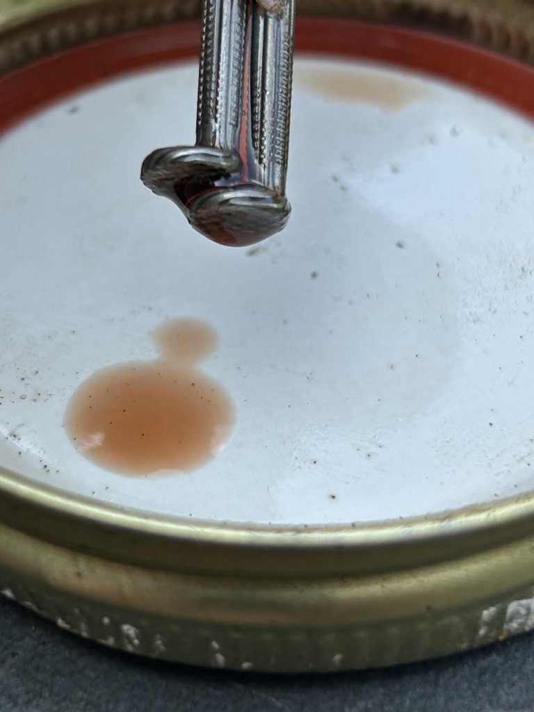

    Edit: I see the trans fluid now. Missed it the first time.
    This is what used transmission fluid will look like, plus it’s almost water thin so won’t usually form such a large droplet as can be seen from me dipping couple nails in some old fluid I have.
    From picture looks more like fresh oil.
