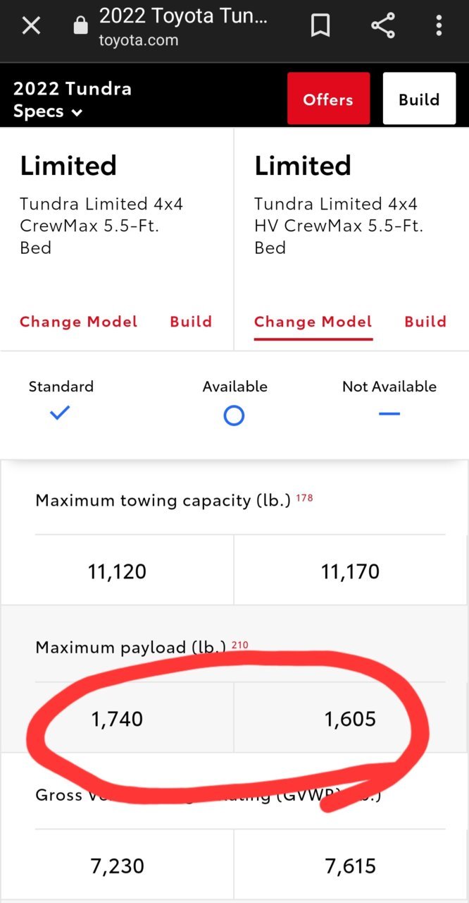

    Hybrid has a higher payload trim for trim than non, different rear end to handle the weight and torque.

    No, it doesn't. Directly from Toyota, it's less. You also can't get the hybrid in a double cab.

    I think he's confused with GVWR, that is higher in the hybrid, but all that does is off-set some of the payload loss from the heavy batteries, but as you said, the NET is less payload.
    hey toyota, give us the higher GVWR in the non-hybrid so we can have even more payload.
  22. Mar 9, 2022 at 12:20 PM
    32,755
    I think you are correct, but figured I'd post the official stuff so somebody reading doesn't get confused as well.

    Well crap, I could have sworn is read/ saw that it had higher payload.. guess I heard wrong or read another lie on the internet!
