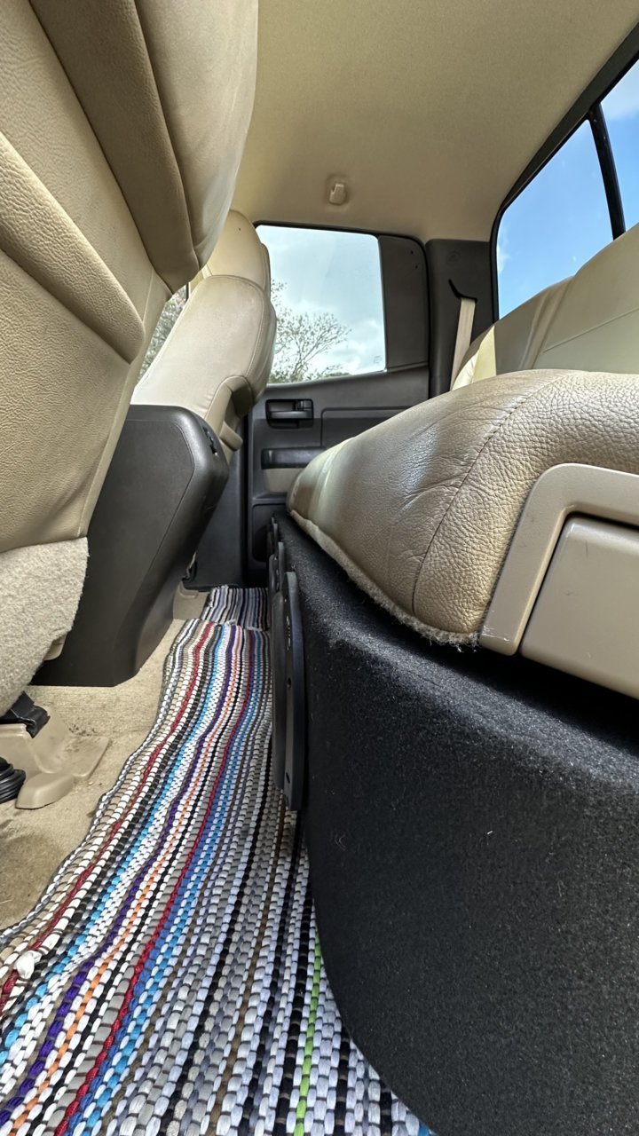

    I recently bought this box (dual 10") from Fox Acoustics for my 2008 double cab. https://www.foxacoustics.com/products/tundra-double-cab-2-10-vented-07-up-downfire It is 1.9ft^3 and tuned to 36Hz. I used two 10" 4Ohm W1 JL subs in it (10W1v3-4). It goes under the drivers side section of the rear seat. I liked that it left the smaller area under the passenger side rear seat open for stuff.
    This is how it sits when installed under the seat (subs face down which I like)
    The business side
    It comes right about flush to the front edge of the back seats
