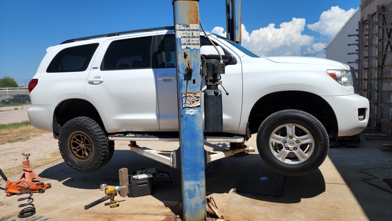

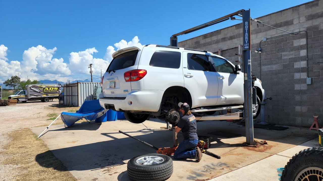

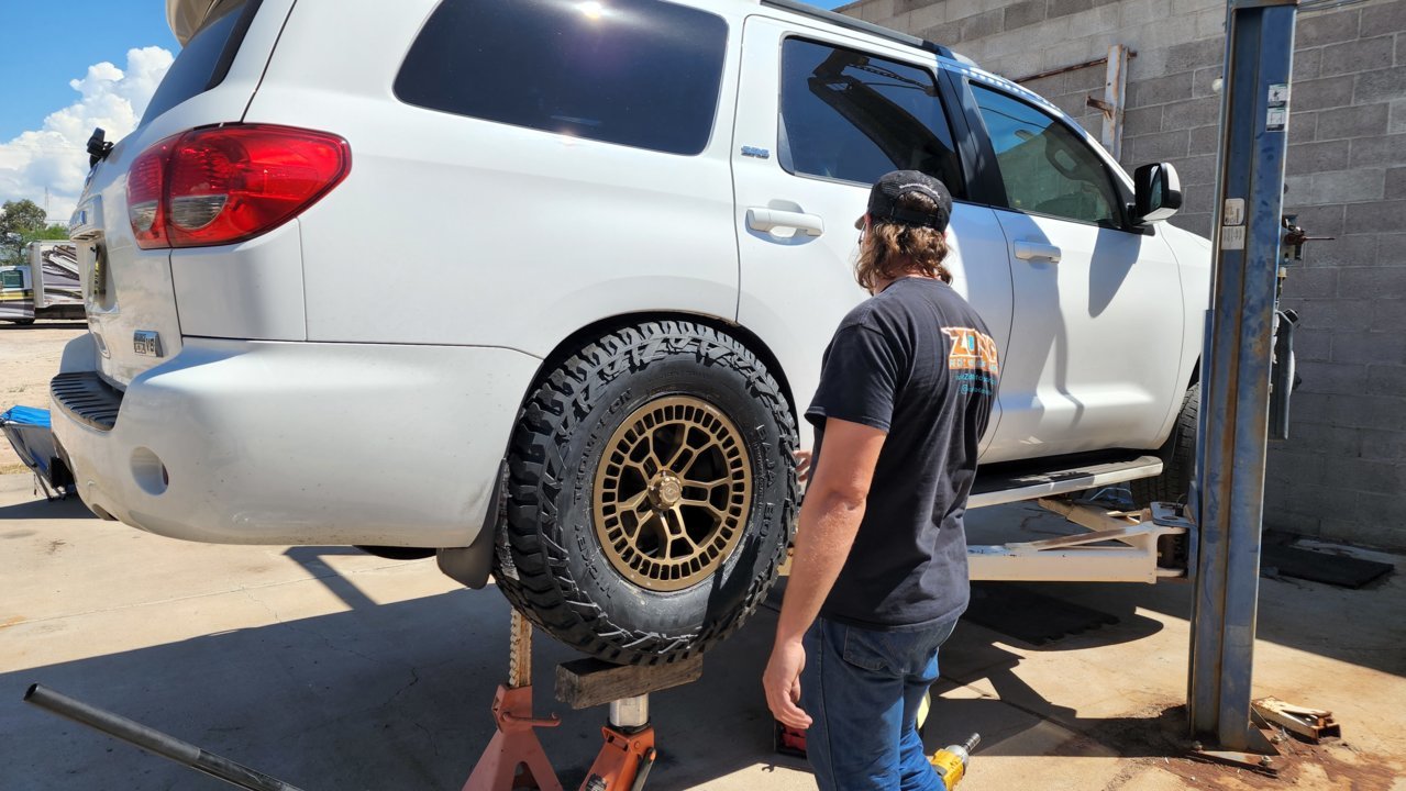

    Good afternoon, let me start with I'm not affiliated with ADS in any way other than being a customer and local to ADS in Arizona. Historically they never had a sequoia first hand available to measure out to create a rear shock solution.
    Soon ADS will be offering rear shocks. Today I took my sequoia to their shop in Tucson and spent about 2.5 hours measuring everything out, figuring out ideal compressed and extended lengths. Tyler estimates that there can be up to 13" of travel in the rear (11.5" without any trimming 13" with very minor trimming).
    They will be 2.5" smooth body shocks with resevoirs, they could also do it without resi's. They'll be 8.25-8.5" travel, he will be building mine in the next 7-10 business days. This was tested using a 305/70r18 set up with +12 offset wheel, but he took measurements with oem 18's as well and has all the data he needs to provide the sequoia community another great solution for rear suspension that can now match their front coilover suspension. I'm excited to see how they turn out and will keep this updated.
