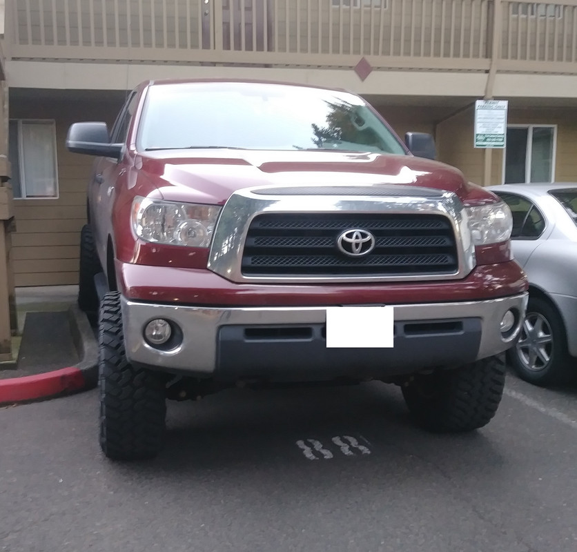

  2. Feb 14, 2021 at 3:34 AM
    jwatt
    jwatt I heart men
    Jan 10, 2020
    #40985
    1,301
    Jack
    Oregon
    Salsa Red 2007 Tundra DC @91k.
    7" BDS Coilover Suspension Lift/BDS UCAs/XB LED Headlights/Nitto trail Grappler tires on Black Rhyno Armory wheels
    I still have a hard time wrapping my head around offsets. My offset is +6, and it sticks way out there. It didn t turn out like I thought it would when I chose the wheels.
