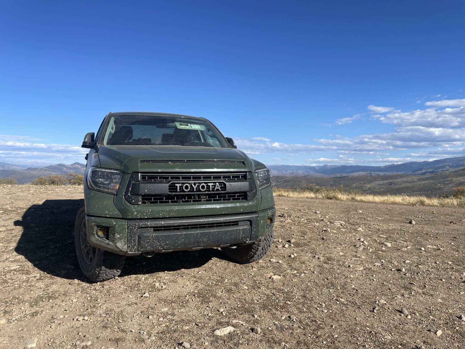

    That pic is 3 years old. I bought bumpers for cheap from a guy with a 2020 Pro who had installed steel bumpers front and rear.
    This is last September glassing for elk (at 8k ft if I remember correctly):
