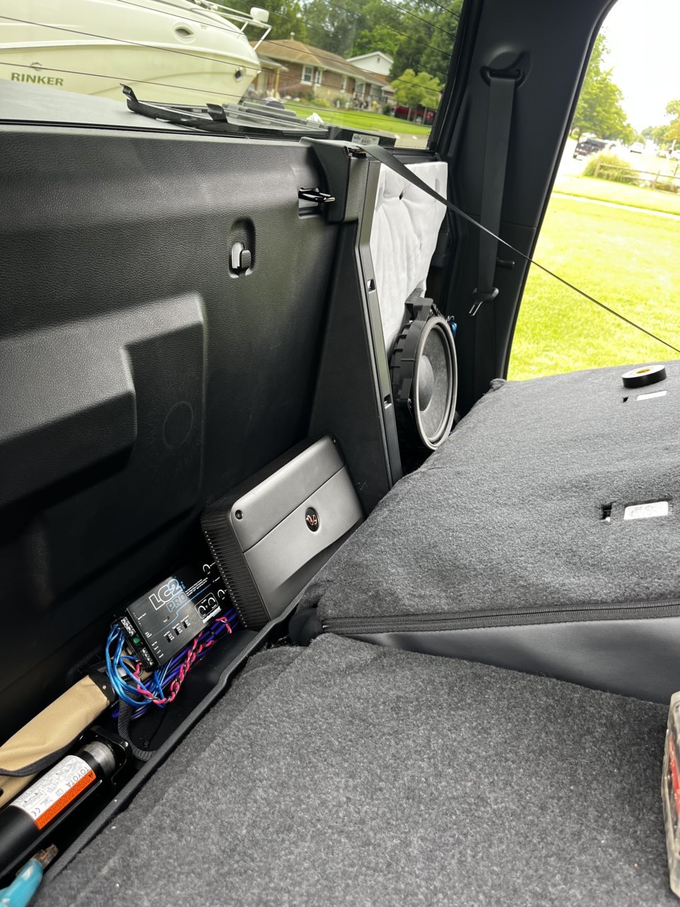

    I have a 2023 Platinum Toyota tundra. I have upgraded the factory system with a LC two pro audio control crossover. And a 1000 x 1 Infiniti amplifier. High tide in and got signal input at the rear subwoofer behind the seat. I ordered a Carista OBD two module to turn off ANC in fake engine noise. I still felt like I was getting some feedback from the ANC microphones, so I removed all three microphones and unplug them from the headliner. Now everything seems to be running OK. Has anyone else done this install?
    I was just curious.
