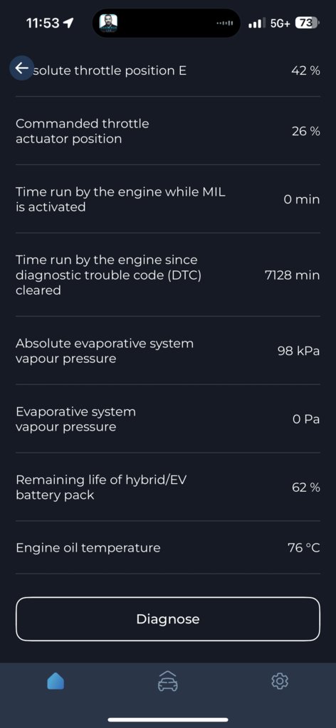

    My Carista shows my ev battery pack has 62% battery life. About 16000m. Think Carista is off or is my battery bad?
    I did have early issues where my hybrid systems had issues. But it was not a battery issue.

    You sure that is saying there is only 62% life left of the pack or that its current charge state is at 62%?

    I, too, suspect that's the state of battery charge, not the actual estimated life span of the battery pack.
    Easy way to find out. Take the truck for an extended drive, then see if that number changes.

    Mines really dead!
    Just monitoring the current battery charge level.

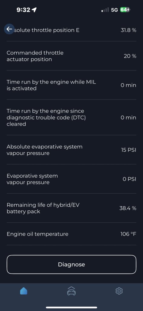

    Mine has almost 1400 miles and I've never seen the battery icon on the dash higher than 6/8 charged.
  10. Mar 11, 2025 at 6:41 AM
    Johnsonman
    Johnsonman New Member
    Nov 25, 2019
    #39132
    1,620
    Austin
    Sequoia
    LED headlamps/fogs; interior footlamps.
    hybrid batts operate between about 30-40% charged (on the low end) and 80-85% (on the high side). This is to extend their life - charging to 100% and then using down to near 0 shortens a batteries life considerably.
    So 6/8ths is just right on the Full end.
