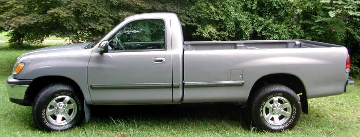

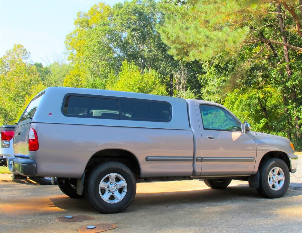

    I don't have production numbers, but I know that Toyota did not make many 4.7L 4WD regular cab long bed Tundra in 2002. My SR5 has the factory towing package, but it does not have ABS.

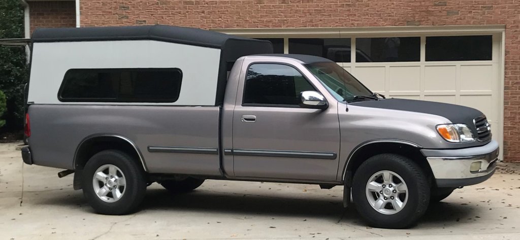

    I have had three different caps on the bed of my truck, the Leer high top lasted 16 years before the fiberglass began to crack.
    Leer replaced the cap with a really nice new cab height cap under warranty because they no longer make the high top for these trucks...
    the ceiling on this new cap was too low for the work I do so I ordered a custom A.R.E. cap and ended up selling the new Leer for cheap. The huge aluminum A.R.E. high wedge DCU Truck Hero cap I have on the truck now is awesome, I wish I had it from day one.

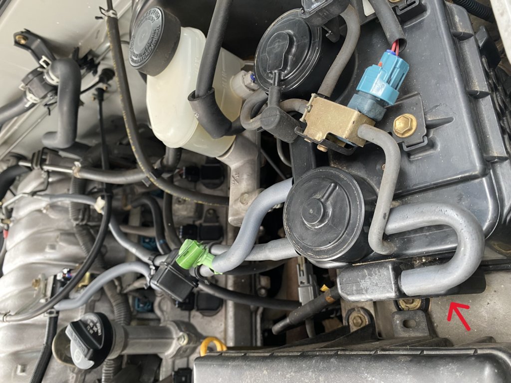

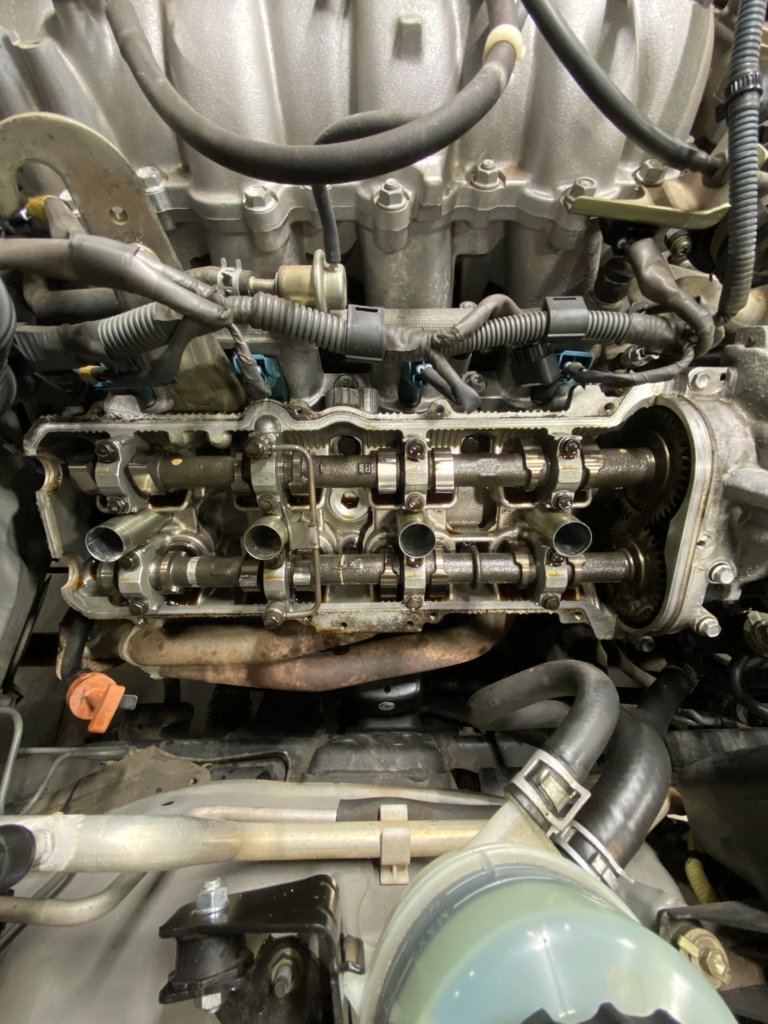

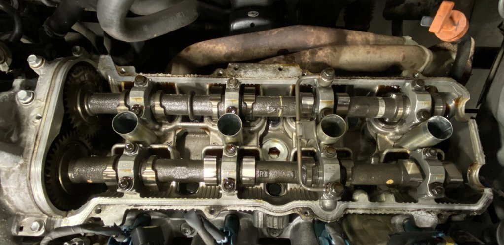

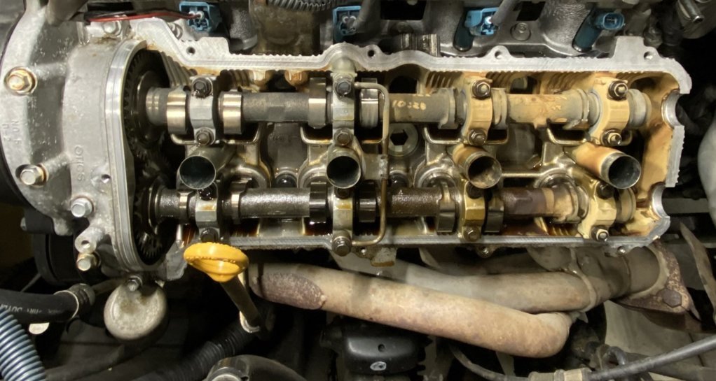

    Valve cover gaskets, spark plug tube seals, spark plugs, PCV valve & grommet changed out at 187,000 miles... this is the first time the valve covers have been off the engine, and the non ventilated side looks pristine with no staining at all. Oil had been dripping on the passenger side header for more than a year...

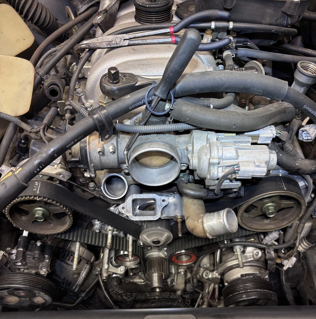

    A few months and 5,000 miles after the vale cover, pcv valve, and spark plug service pictured above was completed I performed the timing belt service... The original radiator was replaced in 2018.
    I changed the oil and filter during the timing belt service, and I am running synthetic oil for the very first time.
    I also replace vacuum lines while I was at it, two of them have been discontinued.
