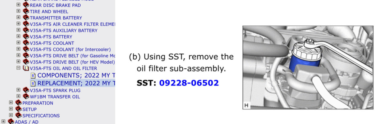

    I just used a oil filter pliers from harbor freight to change my oil filter. You can get them any auto part store. Or get one of them oil filter wrench claw type. They work fine too to get it off.
    but if you really want to use a oil filter cap. Here is the OE part# for the tool. Unsure what size it is.
    ThePolak and extremes074[OP] like this.

    Thanks guys for the advice and thanks for the part number for the filter cap, appreciate it!
