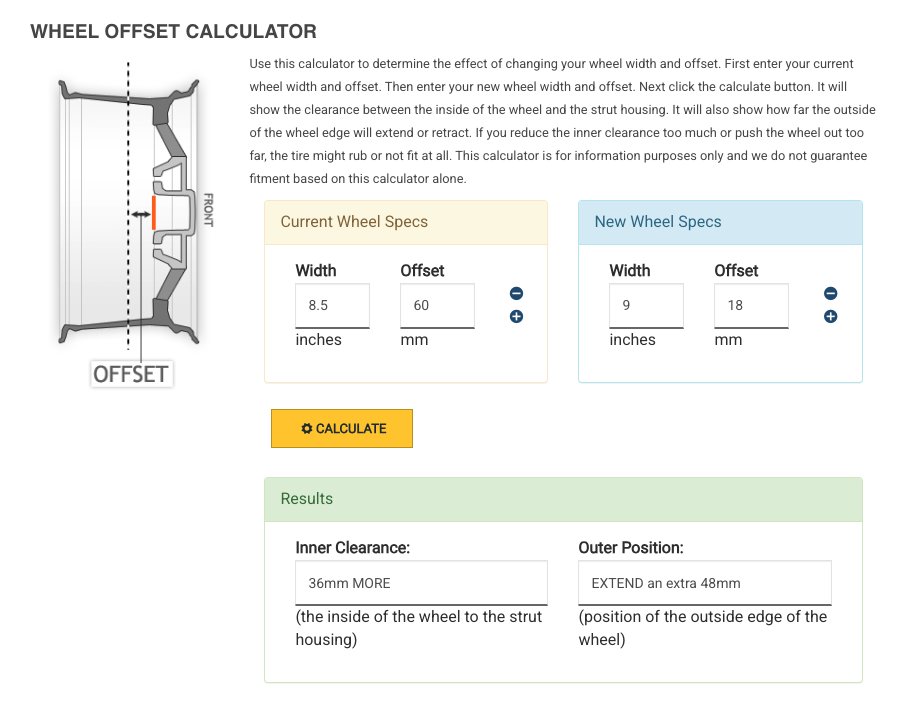

    Any issues with running a 20x9 18mm offset w/ backspacing 5.71 from a factory 20x8.5 60mm backspacing 6.10??
    You should be fine. It will push the wheel out about 2"
