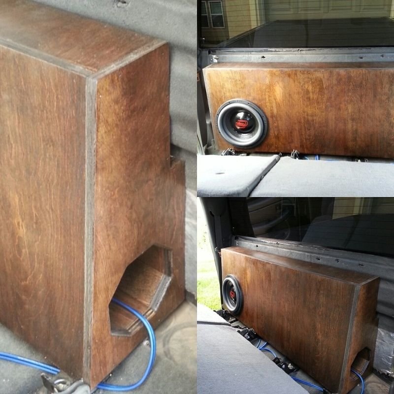

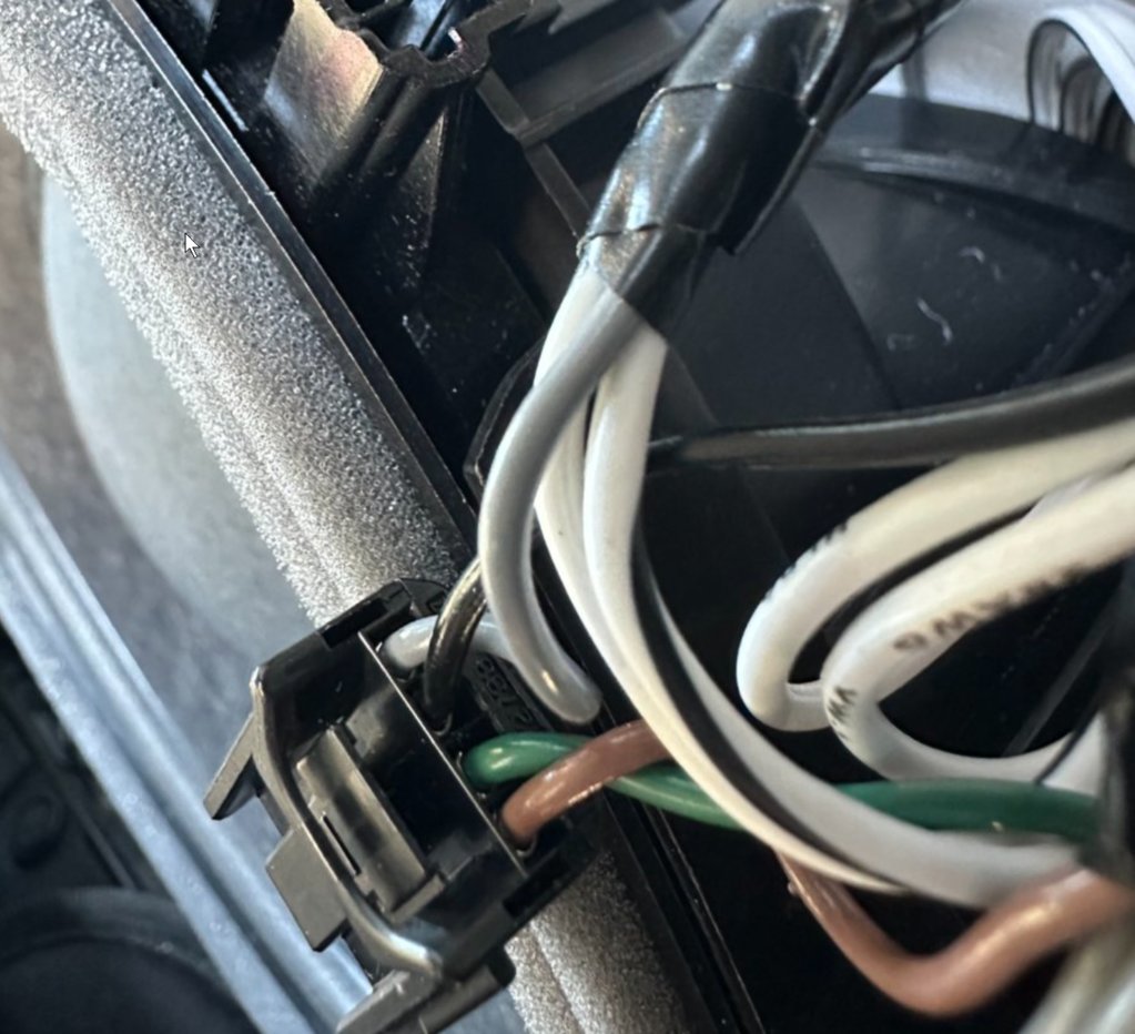

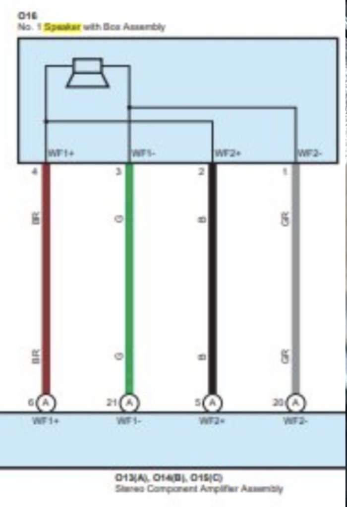

    1. Given that our trucks come with the factory JBL subwoofer, it seems feasible to connect our Line Output Converter (LOC) to these wires. However, I haven't determined if it's the correct frequency. Has anyone experienced issues with this?
    (pulled these pictures from a thread I found)

    1. In this or any vehicle with a factory subwoofer you can tap signal at the factory subwoofer plug with a few considerations. A line output converter is only necessary in this scenario if 1) your aftermarket amp doesn't accept high level/speaker level inputs or 2) you're specifically getting an "active" LOC like an AudioControl LOC with Accubass. If your aftermarket amp accepts high level inputs (most new amps do) an LOC isn't necessary unless again, you're wanting to utilize the Accubass feature. A passive LOC would be unnecessary in this scenario as passive LOC's don't have any signal processing. The downside to tapping into signal at the sub location/end of the signal chain is that the signal has the highest likelihood of being processed. Idk if anyone's measured the signal at various points, e.g. directly behind head unit/pre amp, or post-amp so it's hard to say where factory tuning is implemented (head unit doing vs. amp) but regardless tapping into signal pre-amp will theoretically be a better signal and more likelihood of a full range signal. I believe the AutoHarnessHouse harness plugs in behind the head unit and allows you to splice into one of the FR, FL, RR, RL channels. If one of these channels is full range, then it would also negate the need for a LOC with Accubass or a DSP. Other options include getting a DSP in addition to an amp, or a DSP amp. Some DSP amps will auto-correct factory EQ, like the Kicker Key amps. Other DSP amps will have DSP tuning software.
