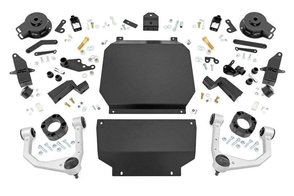

    Hello guys the title says it all i installed a 3 inch lift kit to my 2022 tundra platinum with air bags and AVS and after that i feel that the ride quality is not the same, it got pretty rigid bumpy rough i am not sure how to explain that but its pretty bad after the lift kit. The lift kit they installed is the one below. (i was not able to find it in RC website but its the same as in the link below).
    https://www.arkonoffroad.com/store/...ift-kit-rear-air-ride-22-23-toyota-tundra-4wd
    So i came across the westcott designs lift kit for the same model and they state that "you retain your factory ride quality, factory suspension geometry and still able to align the vehicle to factory specs after install" and i wanted to know if somebody installed this lift kit and your opinion about it, and if its worth to change it, this is the link for the westcott designs lift kit.
    https://westcottdesigns.net/product/2022-toyota-tundra-preload-collar-lift-kit-new/
    Or the last option just to go safe with a leveling kit to keep good ride quality.
