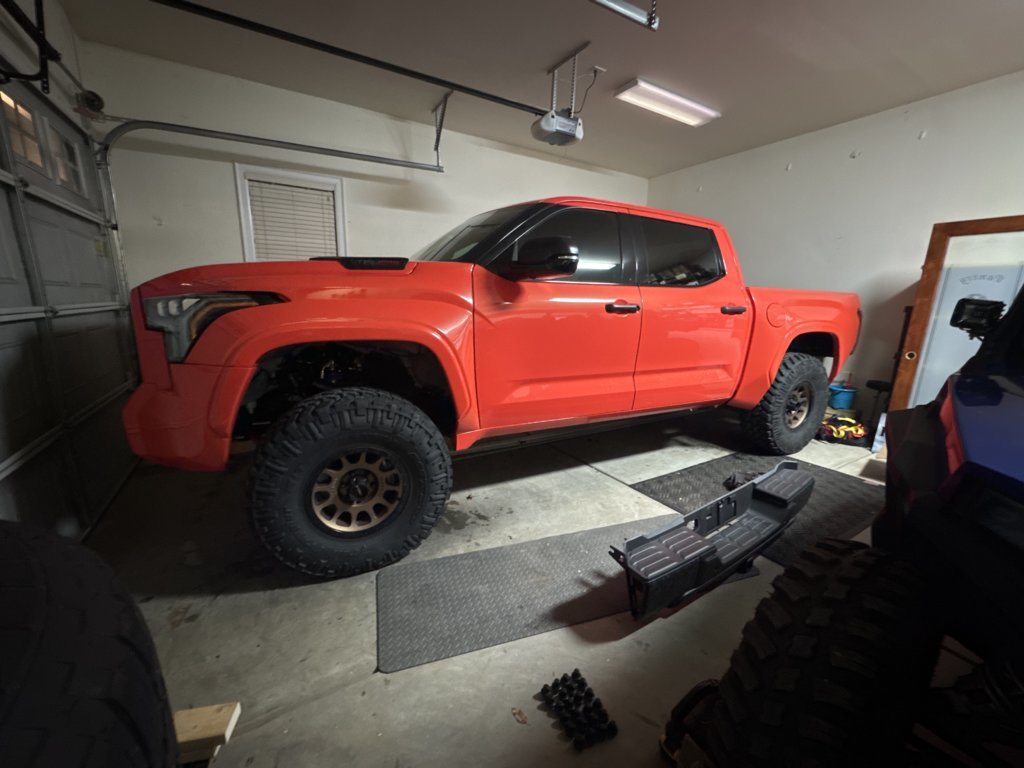

    Welp finally back together…..but now I need to do some trimming and figure out a solution for the wheel well liners. Going to adjust the front suspension slightly. Also need to make a pre-filter cover for the intake inlet. This has been a huge pain in the ass… Ill post more photos of everything in the next couple of days. Might need to ask some questions to the smart people on these forums. The youtubers make it look so simple haha

    Also you’ll want to watch out for the lower shock mount. LT kit with stock length shocks on those kits have been breaking

    So new problem. I need to get an alignment which I’m well aware of to fix my camber issues. The problem is my truck keeps lifting the front end up on acceleration and lowering on when stopping. I don’t understand why I’m having such a drastic swing in the front end. Normally when it’s just sitting it sits great Camber is perfect but when I accelerate the front end lifts up over 4 1/2 inches and will stay there until I hit the brakes.
    I have the kings set as soft as possible..
    ReCKzX and mayan like this.
  9. Feb 25, 2025 at 8:05 AM
    Dozer466
    Dozer466 New Member
    Apr 21, 2023
    #95811
    22
    2022 Tundra TRD Pro
    Westcott 3/1, 37" Toyo's, Smartcap
    I'd set your clickers in the middle and go from there. I had a similar issue on my last truck with a similar setup to yours. I think the Kings have 20 clicks total, set them to 10 and see if has any impact.
    Also for your wheel well liners, you can buy sheets of .125" ABS. You can use a heat gun to form the liners. I did this on my last truck and had no issues for the six years I owned it.

    So I have them set all the way down to the softest they will go now. I am going to do some driving around and see if they loosen up. I am not sure if they just need time to break in but when the front end of that truck lifts up and doesn't go back down while driving the camber is so bad its chewing up the outside edge of my tires.
    I really appreciate your feedback, I am starting to feel like I will never get this truck on the road. The amount of trimming I have had to do to these Fiberwerx fenders is a little crazy. Buying and installing them is my biggest regret so far.

    Have you talked to JT or someone at BK? My brother had their kit on his 2015 Silverado and didn't have this issue. We set it up pretty tight though.
    People need to realize that a LT suspension will never be comfortable when daily driving like an oem or basic lifted truck is. These things are not built for comfort, although you could spend a lot of time on shock tuning to get it as close as possible...but most people buying these things wont.
    We had to make custom fender liners, fender braces/supports and a whole bunch of cutting and trimming and putting on and taking off to get it all to work like we wanted. The BK stuff never failed but it took a lot of time and effort to get it where he wanted it. Then other stuff started breaking and needing beefing up...like LCA bolt holes and strut buckets.
