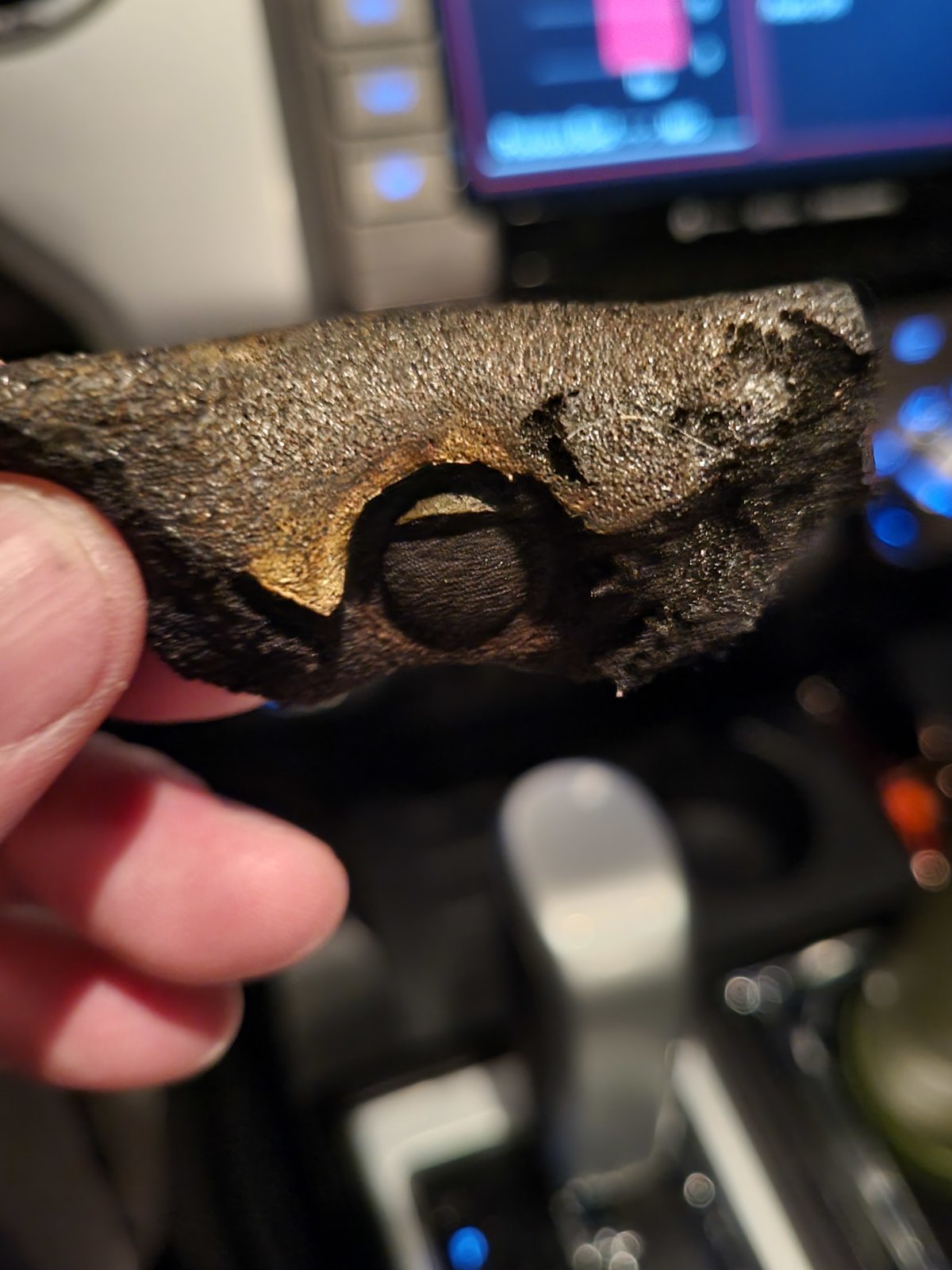

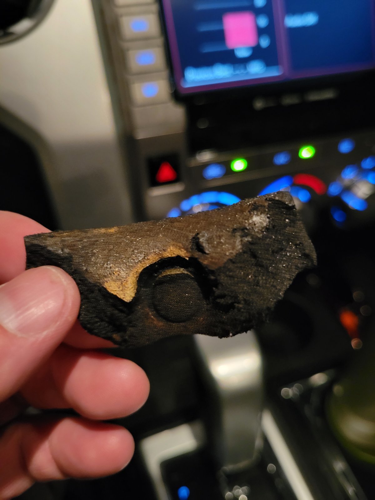

    Fixed, or atleast I think so. Piece of foam was blocking the end of the line behind tgat silly grommet spout. I found getting at those 10mm nuts with a box wrench from the passenger side worked best. Had maybe a cup or 2 of water come out when I took the gromet/spout off. Had to rip the foam piece out. I cant/refuse to believe toyota doesn't know this is a problem and would look to get 2k to fix it, if anybody knows how to return or cash out the extended warranty I'd appreciate the info, I didn't pay this kind of $$ to be wrenching on stuff after work.

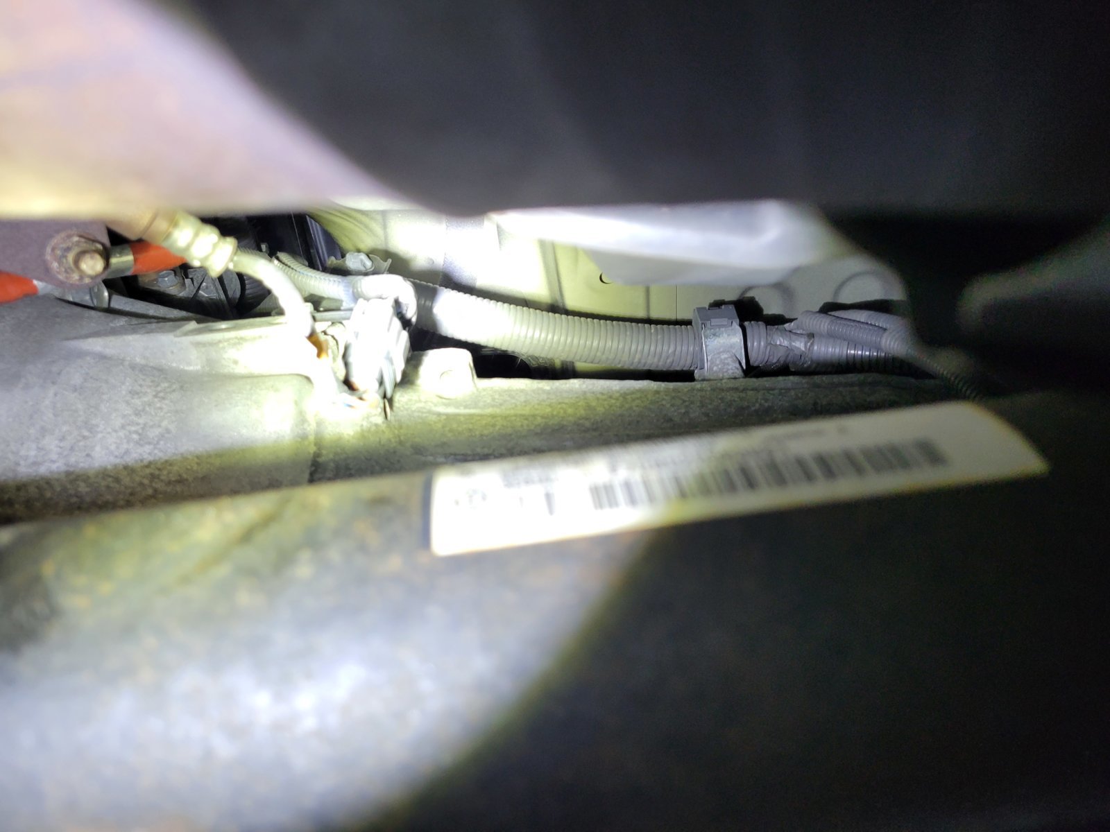

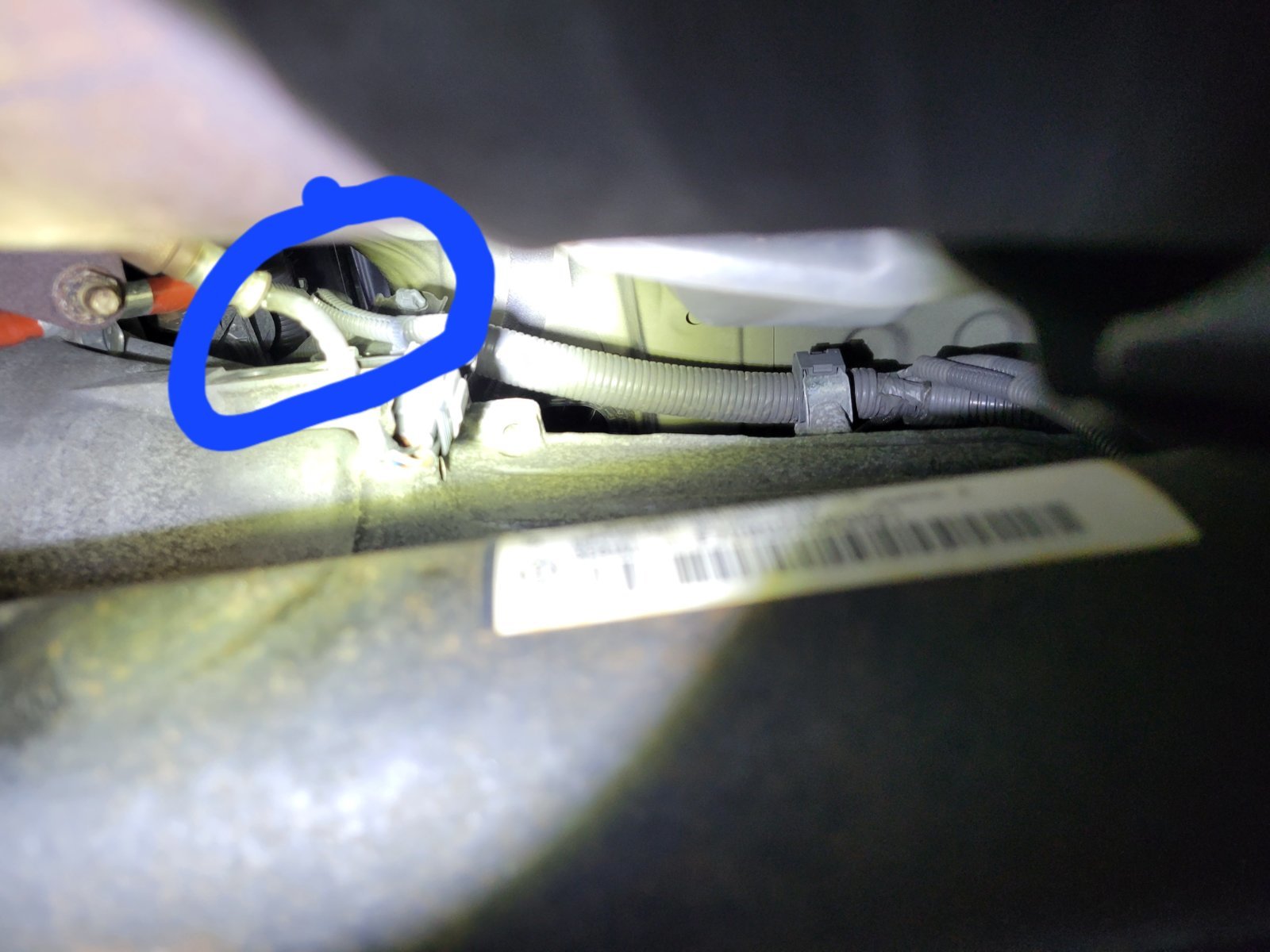

    Can you highlight where the drain is in your picture?
    Just curious for future reference.
  7. Jul 31, 2024 at 4:56 AM
    Rdh1223
    Rdh1223 [OP] New Member
    Dec 9, 2023
    #108166
    14
    Dutchess County, NY
    2021 Tundra
    Here's from the drivers side. Sry the quality is terrible
