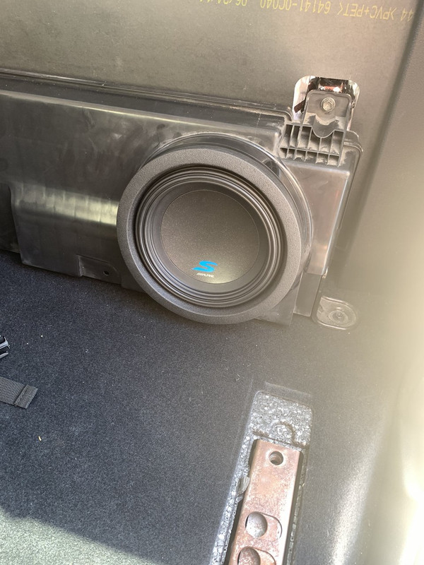

    I sound deadened the back wall and floor and stuck an Alpine 8” sub (with 1” trim ring) in the factory housing.
    Made a substantial difference for about $150.
