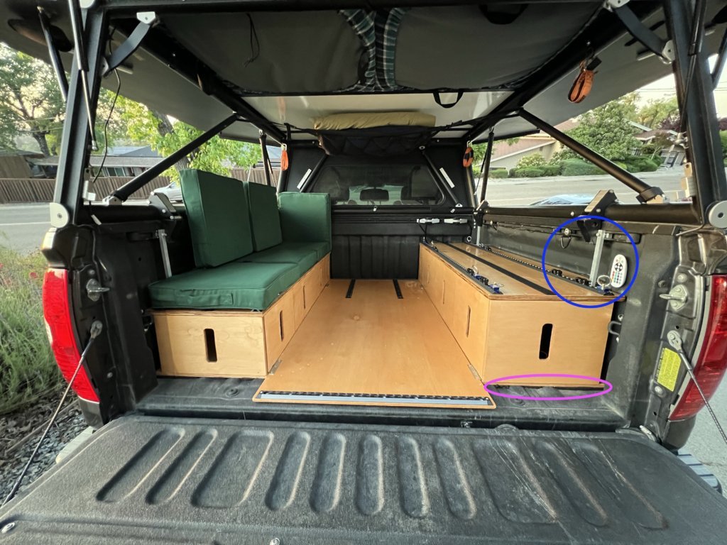

    Here's some pics and the build out.

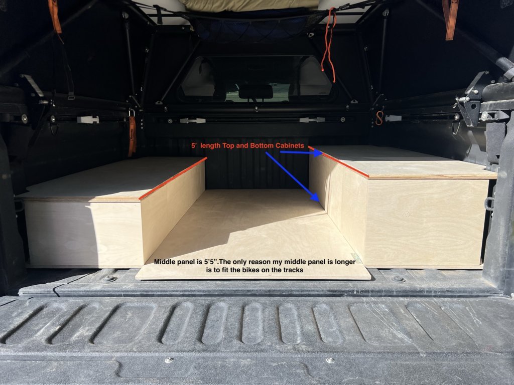

    The original mock up to get my head around what I wanted.
    Starting to come up with a plan. 1/2" for floor and cabinets with 3/4" marine birch as counter/top.
    So each side is a section with the floor as a section. A few anchors and aluminum bar to the bed rails secure it in place and it is solid. I ran some turnbuckles on the cab side tie downs, but they're probably not needed.
    I'm using the 100w goal zero and so far it has kept everything really topped off with fridge running 100% of the time.
    Starting to come together. Here is a few shots with layout options.

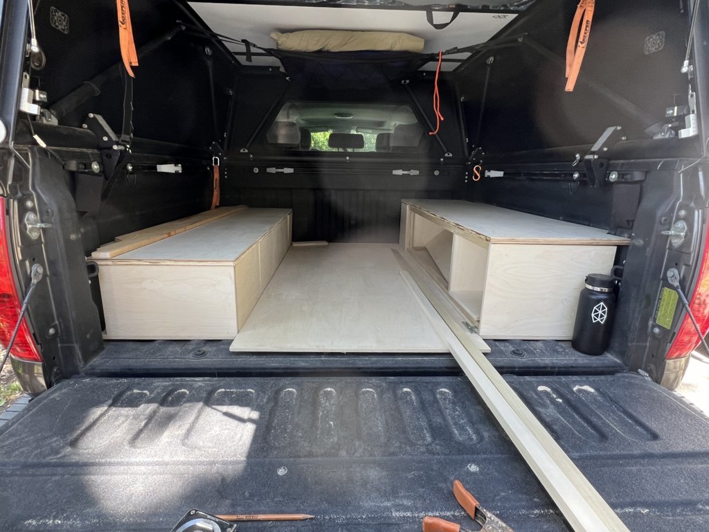

    Ok I took some measurements and I'll try to explain the build my best and how I would go about it now. It was literally flying adjustments as I went.... I'll attach some pictures again with markups below this post.
    The measurements are close because it's hard to tell what I trimmed and sanded. For example the cabinet Depth is 16 3/16" measured. I'm pretty sure I cut it at 16 1/4". The Tundra bed is wider in the front than by the tailgate I believe.
    A) I used 1/2' birch plywood for the floor since it's supported by the floor and 3/4" for the top so it would hold under me standing on it.
    B) Cabinet framing is 1 1/4"x 3/4". You can use 1x2's or whatever you have available. I built three compartments to add rigidity for the top when standing on it.
    C) The cabinet doors are 1/2" birch plywood as well. Build the cabinet frame 1/2" inset from the top and bottom panels so the doors fit flush.
    If you have (or drink beer with someone with) a table saw and guide this will be a lot easier.....
    1) Cut your middle floor first. Mark the center point of the bed and the center point of your floor and line it up.
    2) Now measure out to each side from the middle floor portion to cut your cabinet bottom panels. There is scribing involved on the wheelwell area. Again the bed is narrower in spots. I can't remember if it's the front or back of the bed. But you'll figure it out. Take several measurements for your cabinet bottom panels before you cut.
    3) Once the bottom panels are cut, put the floor in place to check fit and make adjustments. At this point you can build your cabinet frames. Remember to build them 1/2" inset from the panels so the doors fit flush. You can make the cabinets any size to accommodate your needs. I separated mine, but it's not necessary. You could leave the interior open.
    4) Once framing is built on the floor panel. You can now do the top. I should have used my Decked system as a scribe guide but I sold it too soon. I cut my 3/4" Birch plywood in half (24X96) so it was easier to manage. Make a scribe template for the inside bedside portion and cut. Place it on top of the cabinet to mark your final cut to remove excess remembering to leave a larger overhang than the frame. and doors. At this point it doesn't have to be exact. You could have a 1" overhang you want.
    5) Cut your long side door panels and place magnets. I just took one long sheet for the face and cut it in two spots (either side of the middle cabinet where doors line up in the middle of a vertical cabinet framing. Then I cut my end panels to cover everything and sit flush with long face door panel.
    6) I ended up using L- brackets and screwing down some tubular aluminum and tying it into some cleats for the bedrails. I thought this might keep it from bouncing around. You might come up with a better system.
    Now for the little stuff. The middle floor is longer to accommodate my L-track for the bikes. The cabinets are a little shorter than the middle to allow me access to the bed tie downs.
    The left side is shorter in height so I have headroom when I'm sitting inside and it's raining. This height should be adjusted for you. I'm 5'11".
    Reach out when you have questions or need more measurements. FaceTime works great for this stuff.
    -Jason

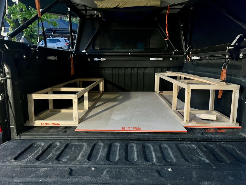

    Also, I made all my frame cuts first (mistake) and you can see the cabinet frame at the rear corners are off, cabinet depth could have been deeper but I made it work.Cabinet size inside dimensions from tailgate forward are 1st cabinet=13", middle=36", end=7 1/4". I did enclose all four corner cabinets by putting plywood on the backs and inside panel as a separator. The middle cabinet doesn't have a back on it. Not sure if this is needed depending on what you want to carry in it.
    Scrap wood on left cabinet as my scribe template. I just flipped it over to cut the other side.
    Top plate overhang on cabinet doors is more like 3/4" to cover up my mistakes on scribing. Remember the bed is not square.
    Aluminum tubing tied in to prevent bouncing. I used foam door seal under the cabinets because I kept dropping screws and drill bits and they would roll under it.
    From tailgate forward cabinet inside frame widths are 13", 36", 7 1/4"
    Lastly, I removed the GFC deck rail clamp from the bedrail one at a time and put in a bunch of bedrail cleats and tie downs for future use.

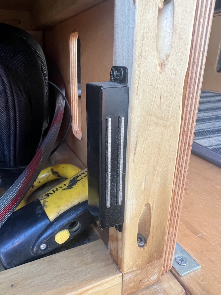

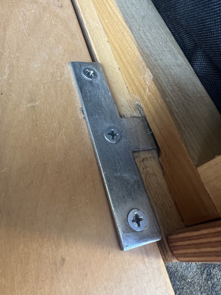

    Here is a closer picture of the 1/2" inset from the floor and cabinet framing. I also used a T-bracket to attach the 3 sections together. Cabinet-Middle-Cabinet
    Strong kitchen magnets. The hardest part was lining up the plate on the door. It would have been easier doing this without the cabinet top/bench seat on.
