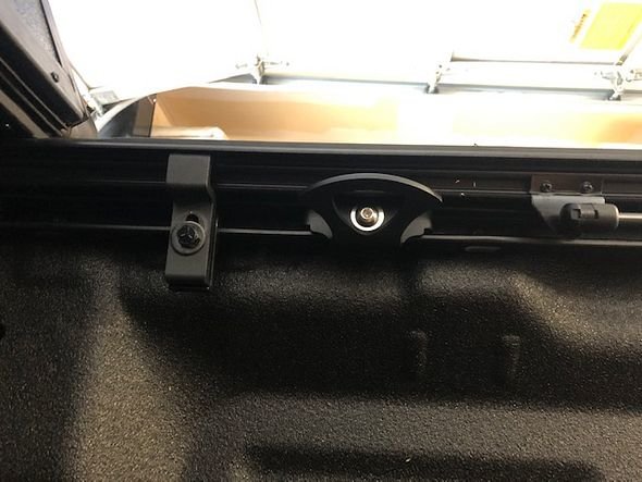

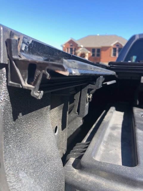

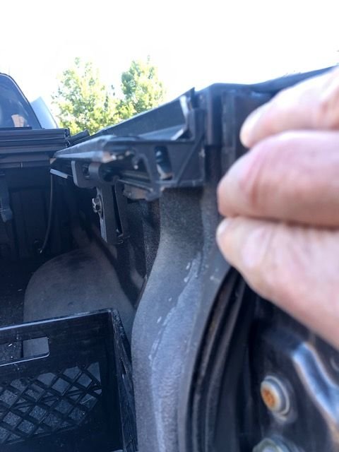

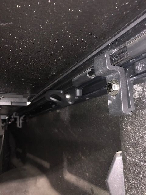

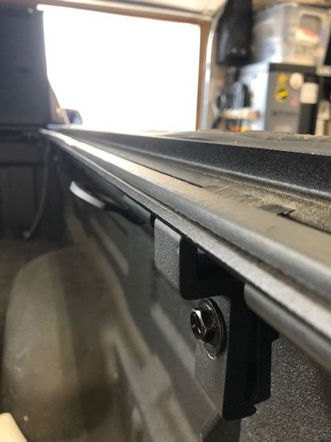

    The bedrail is a much better cover mounting method than the clamp-on.
    For years I couldn't get my Undercover Flex to stay clamped onto the left side.
    Almost every time I shut it the frame came off the bed.
    872529f6-f407-4228-9d03-59df227df712_a352b79de2a7eb5b393e0440062f5c7c114e84b8.jpg133cf3ec-9d61-46a1-9816-d53e2ee98ac3_017aa34e0d51742e4a556ae9178c24c01e25bcb3.jpg
    I ended up buying the OEM rail system and Undercover sent me the appropriate clamps for free.
    Never had an issue since.
    078e432a-d425-4120-b73d-1df0e8a883b1_d99543b3bdb959e47fd6ec5c7502d032abeefd67.jpgd1abf8b0-0a5f-40dc-bd35-3f3fd3f818dc_9435856ff450aecf310105916a782ebbe44f3185.jpg

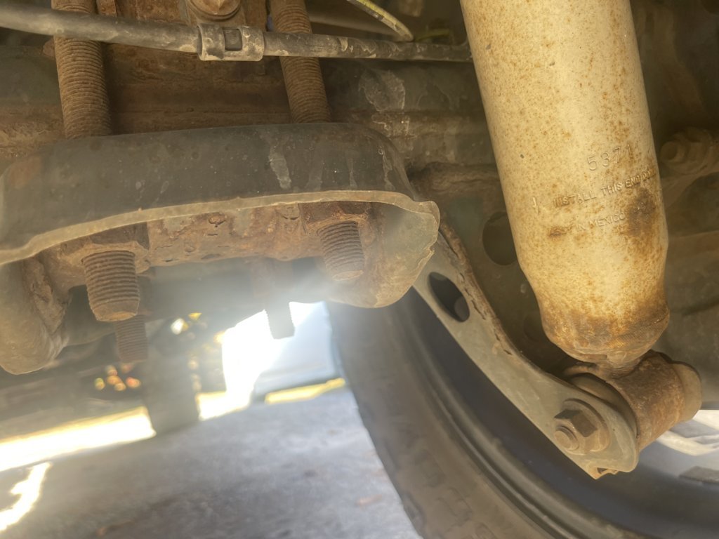

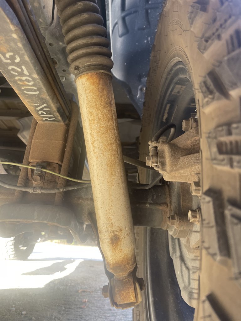

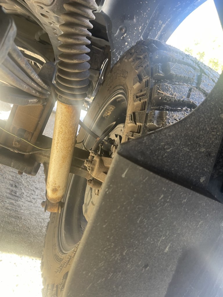

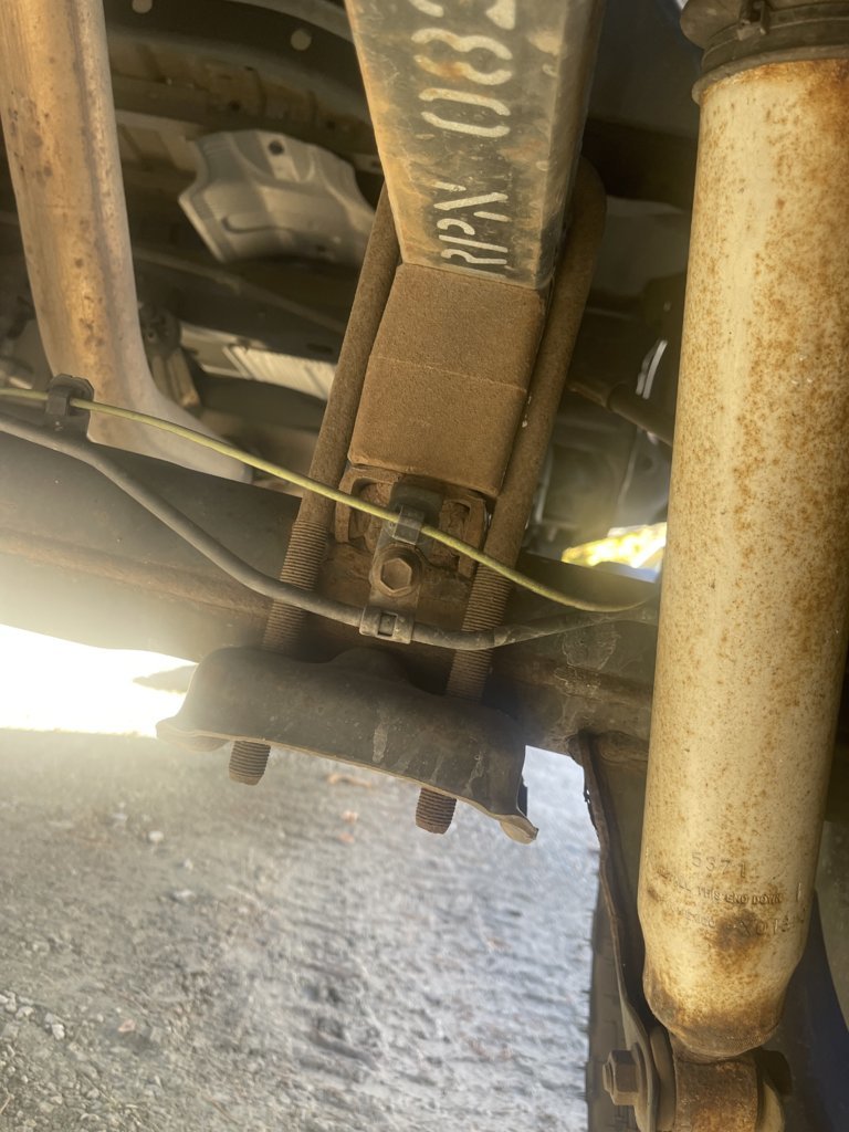

    Looks like a big spacer and longer shock? I'm not sure I would be able to use spring helpers without removing the factory u bolts but there isn't much room on the threads. Attached are photos I took from underneath

    Finally got around to measuring and it appears the rear is roughly 26" to 26.5" and the front is 28" - which means the rear appears to have just under 3" lift and frot has 6'?
