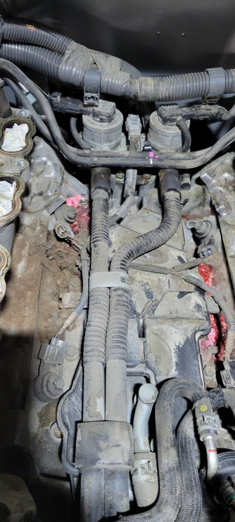

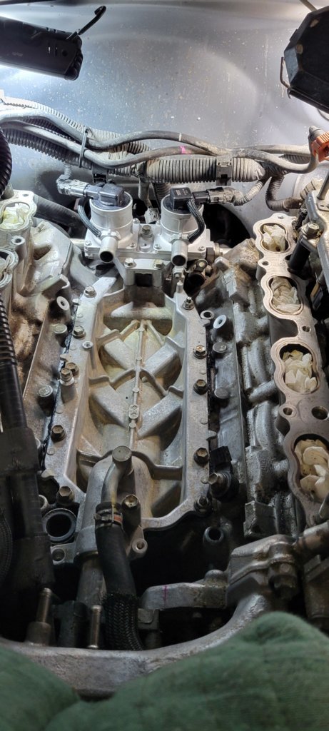

    WhiteSR5, thank you for your reply. I'll try to address your questions in order. Work performed under the hood in the past two weeks. I replaced the secondary air injection valve because I had a P0418 code. Once I removed the intake manifold (to access the air valve), my valley plate (heat exchanger) had evidence of leaking, I had a rodent nest and a chewed knock sensor wire. Vacuumed up the nest, removed, cleaned, and resealed ($101 for a tube of sealant from Toyota) the valley plate, and a new intake manifold gasket. The only part of that work that has any association with the brakes is the vacuum hose to the brake booster check valve. There's plenty of vacuum and the check valve checked okay. My 5.7 has 208,XXX miles on her.
