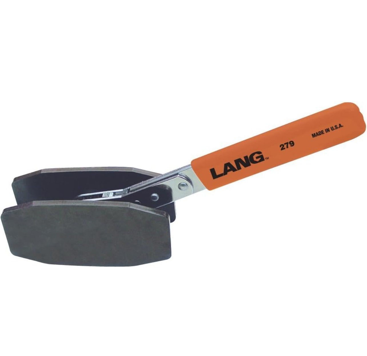

    I personally sprayed brakeclean and put grease between the shims and the bracket. I made sure there was fresh new grease on the pins as well. Maybe they would have went in better with grease on the shims with the edges of the pads.
    I haven't used that tool but for the front brakes, I bet it's a game changer.
