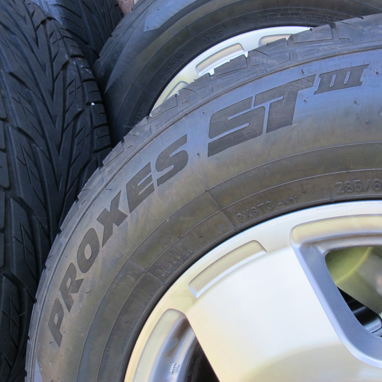

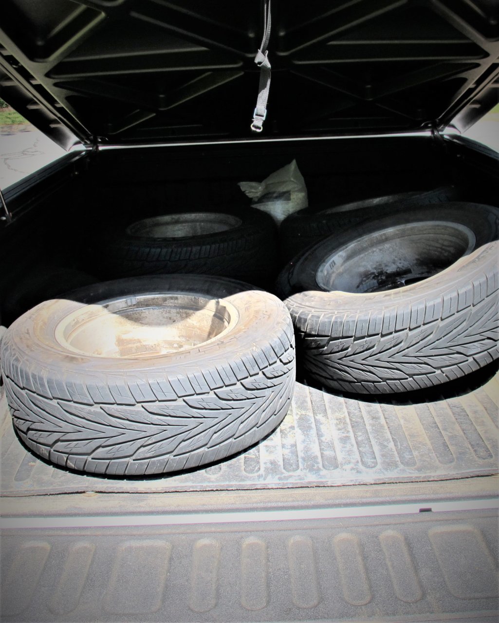

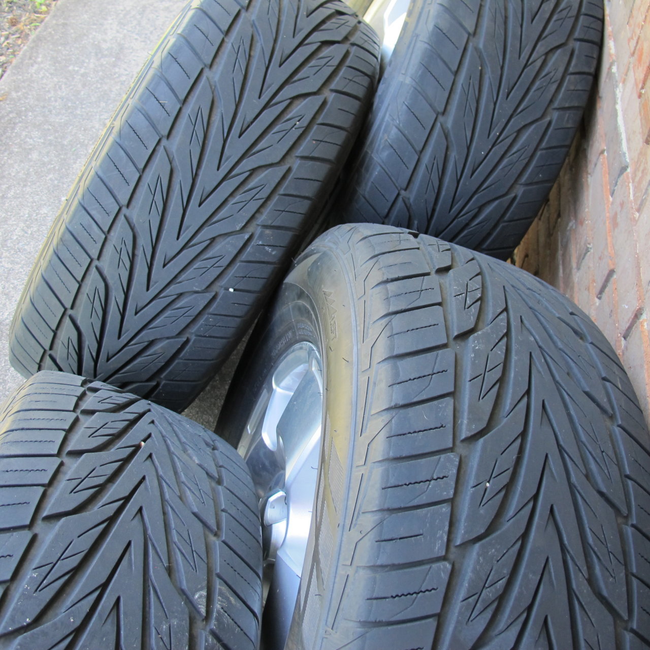

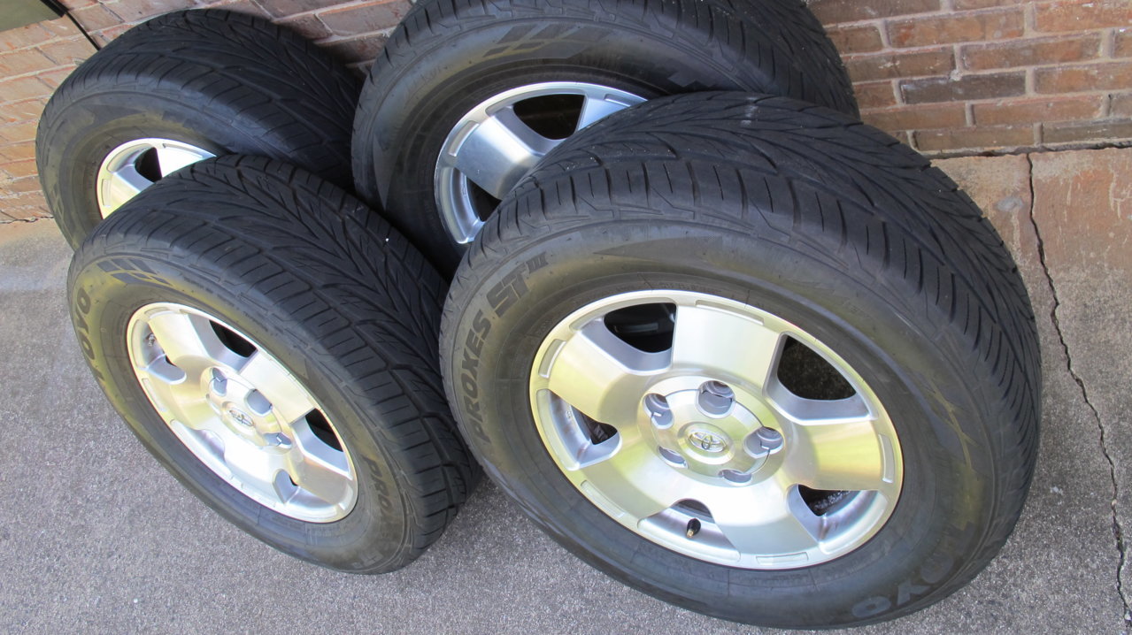

    Getting my tire situation reconfigured for warmer weather.

    980
    Nick
    How are the tires holding up. I might get the same pair in 305/50R20 trying to get rid of my nitto 420s.

    2002 4.7L RCLB 4X4 2007 5.7L RCSB 4X2
    They are holding up well, they have about 4K on them and the tread is still deep. Make sure you have them load balanced, and rotate often.
