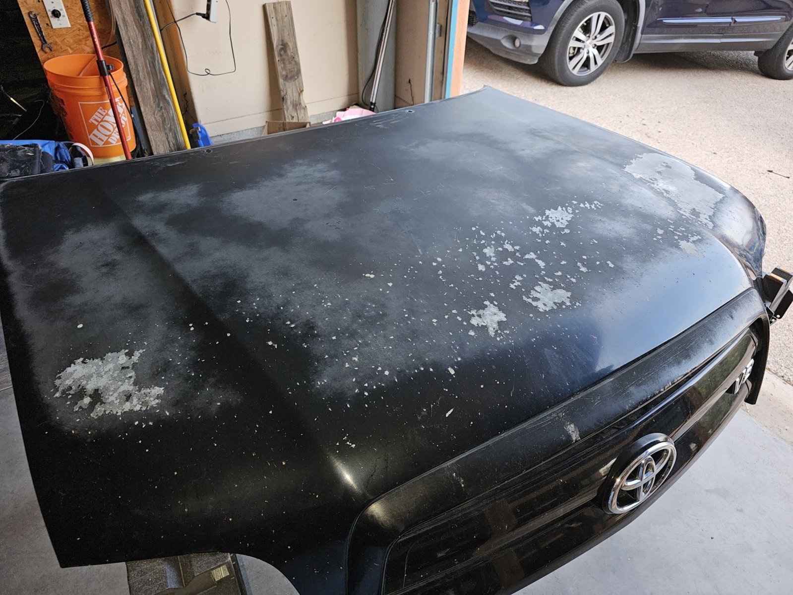

    Just from researching it the last few days, I've come to realize the depth of this skill set. I know what I put on the truck will be an amateur attempt, and I can appreciate the dedication of the dudes in the shops, but I just can't drop another 3k as I was quoted. Blunder on my part by giving that money to firestone instead.

    Impressed and eagerly happy for you! Sounds like you studied painting online and likely got tips at the paint store too?
    Love seeing the details like the paint gun stand. Did you grab a respirator too? And some mixing cups, stir sticks, and conical paint filters for straining the paint as it is poured into the gun?
    Horizontal surfaces like the hood can be easier than say a mounted fender that can more easily form runs/drips on a vertical surface from being laid on too wet. But there is an additional challenge of managing the hose to keep it out of the wet paint when extending toward the center of the panel.
    For the roof, ladders or paint platforms on both sides may be the answer. And since you likely will go from one side to the other quickly so not to lose the wet edge in the middle, having everything setup and your reach pre-tested will be important, since there likely won't be any time to set the gun down and move a ladder for instance. And likely that would kick up dust too.
    Dialing the gun in first on a piece on something disposable like masking is important to get a good finish. The regulator at the gun will be a key along with the airflow settings on the gun itself. And the primer may spray differently than sealer, base and clear. So can test the right pressures for each one right before laying each on.
    https://m.youtube.com/watch?v=pNfjSFyGYiM
    Laying the primer / sealer can give some practice on how the gun works and fan lays paint, including speed and keeping the same distance from the thing being painted with an on-off for the trigger on each pass without arcing (as that affects the distance). Blemishes in the sandable primer layer could be leveled.
    The basecoat is where it becomes more important to have good technique because bad orange peel or large drips for instance would be harder to fix (there's techniques for that) than say a dust nib that be sanded out between coats or before clear with like 600 grit.
    For the clearcoat, it's really important to get the paint on wet enough but not to thick to drip and with the right air pressure to reduce orange peel while keeping dirt out. Minor issues in clear can be sanded and polished later.

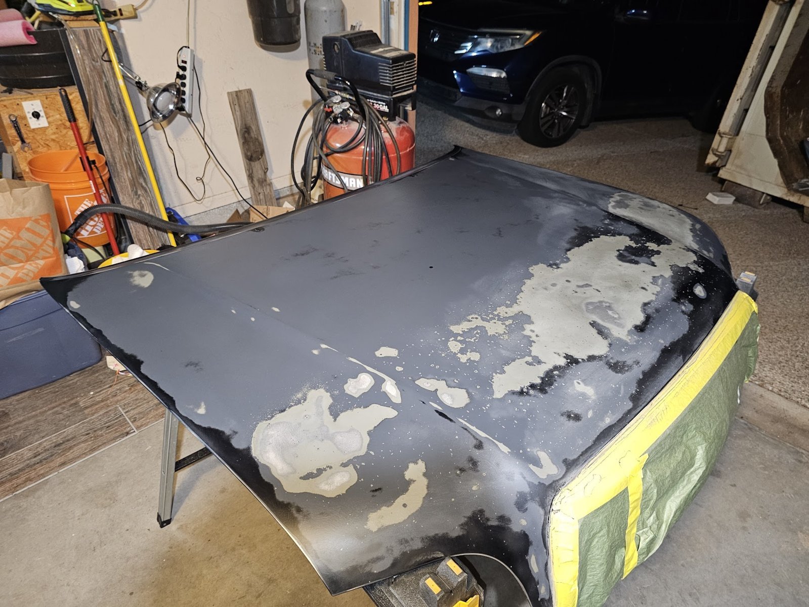

    Amazing information, I really appreciate you taking the time to provide all this, I'm really nervous while also being really excited! I'll be sure to take this all to heart and practice for a bit before committing to the base coat. The clear coat has me worried though, really hope I don't mess it up!
    Exactly, the hood and the roof (which has rust pocking, but not terrible) are my two main goals, after that I'll see how the polishing goes on the sides before I decide I need to strip them off. I really hope I get a good match to the current paint.

    Did they look up the paint code? Think black can be an easy match compared to say a silver flake. The good news about the clear is its clear. So it can be corrected to some degree after drying but with work, or recoated.
    If you look at other cars you'll probably note factory finishes have orange peel. So wouldn't expect a glass finish out of your gun. But worth the time to dial in the pressure, fan, etc. and practice some overleap of each stroke. And remember what the paint society video showed about 1st coat lighter and then that creates stickiness for other coats to go on ... just a little ... thicker.
    What reducer did you get and what is your temp? Did someone talk to you about that? Fast reducer in hot weather will give less "wet edge" time, yet reducer that's too slow (especially in cold weather) can leave paint to run.
    Looked at your pics again and notice the front of the hood has a little vertical section up front. Be careful to keep the gun at the same distance as you curve that horizontal to vertical and keep moving at the same speed. Otherwise if you get closer at the transition or slow down, the paint will likely build up there, and could form a drip down the front. If starting the stroke up at the windshield toward the front, then would end by just pulling the gun past the vertical end of the hood and releasing the trigger once into the masking paper.
    I'm confident what you do will look better than it does now. And if you don't like the results. It's just some work (and supplies) to sand and recoat!

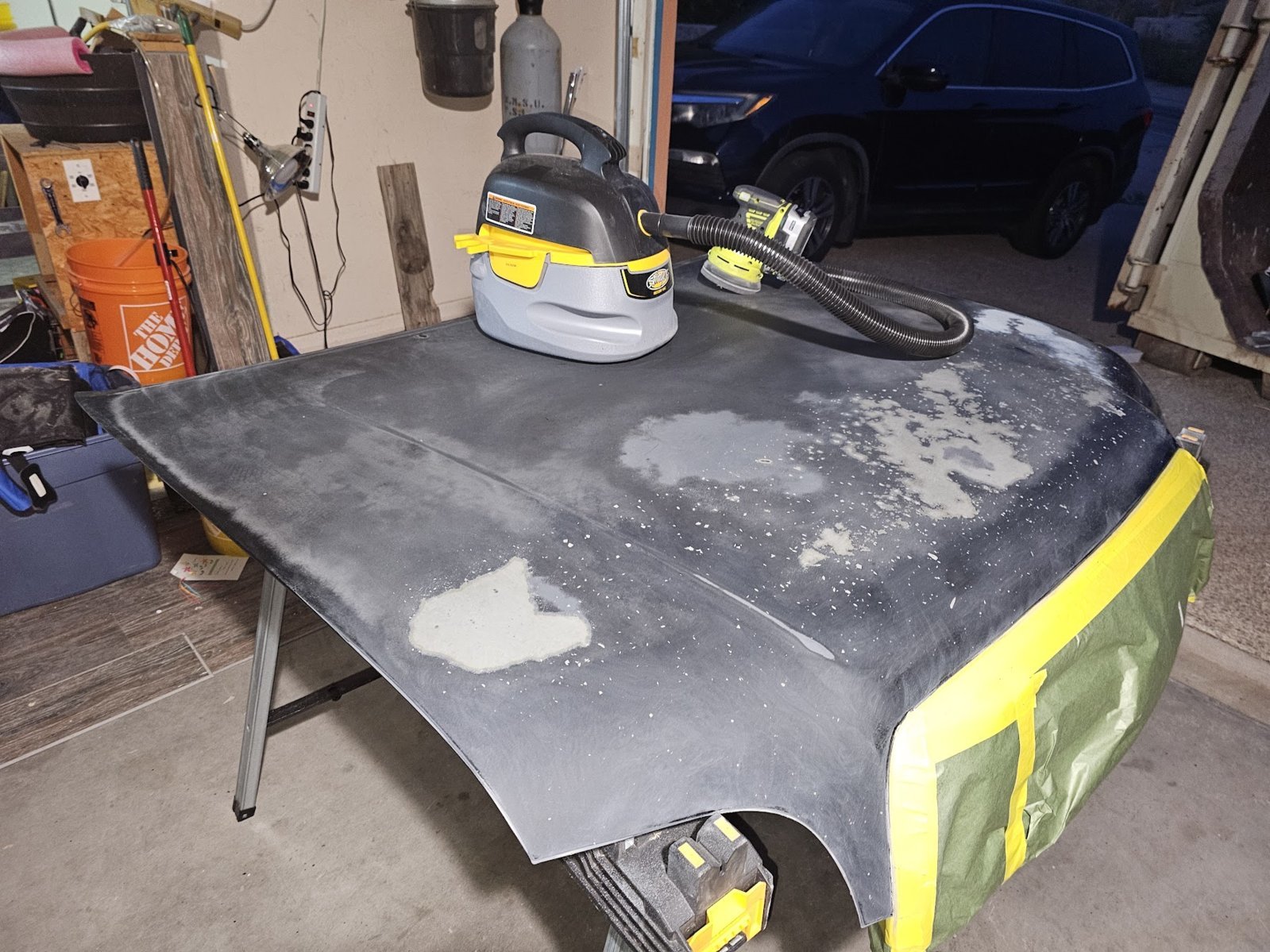

    I’d start tackling the hood with 320 grit. And i’d sand all the way down to the top of the existing primer coat. Use the black base coat as a guide. Once you sand through 99% of the black, then go at it with 400 grit. Sometimes i’ll go to 500 or so, but 400 should be plenty for what you’re doing. Oh, and if there’s lots and lots of rock chips, then possibly even low as 220 in a few spots if needed.
    I’d also highly recommend to unbolt the grill from the hood. It will make the paint job better and your life easier.
    Hose down the floor right before you paint!! It will help tremendously to keep the dust from churning up into the paint.

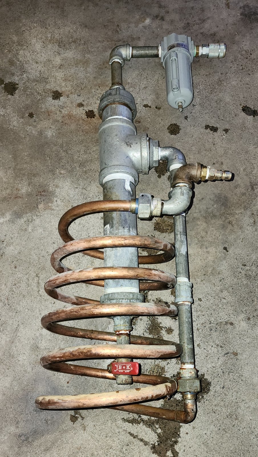

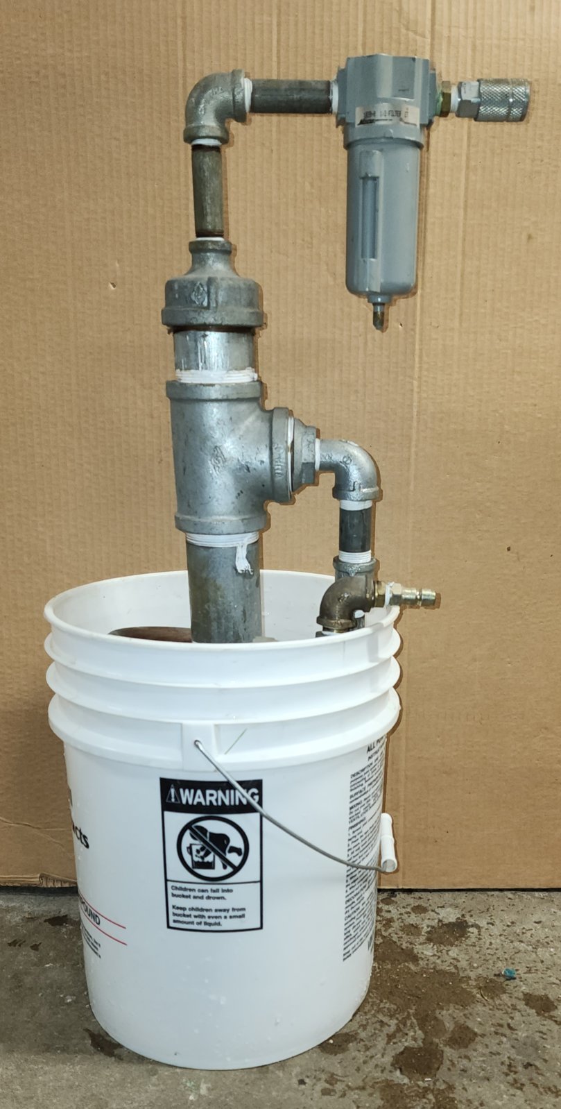

    In addition to the disposable filter right before the gun, can build this installed right at the compressor before the hose. Bucket filled with cold water condenses the hot moisture filled air in the coils and separates it. Consider a hose for painting that is not used for air tools (especially where previosuly had an oiler installed before it).

    I want to speak to the manager of Rock Chips Inc. Their product ruined my day again. So I'm getting decent-ish progress, I'm down to 320*? grit sand paper and bought a 220 block for the edges since I can't see to get them very well with the sander. I'll be taking off the grill tomorrow, hopefully if I can get enough done in the morning before work I can put on some of the primer. (I also gotta go back to homedepot, because the filter I bought needs some kind of adapter to fit to my compressor, a little annoying it didn't include those). Lots of bare metal, might need to seal maybe?

    If its that much of a problem just get some aircraft paint remover and remove it totally down to bare metal and start over.
    That orbital polisher you got, buy some of the velcro backed sand paper they have and use it and you will see a WORLD of difference in your sanding. I would get a 320 grit and you will blow that hood down to primer fast.

    That's actually a brilliant idea to use the orbital polisher, I have no idea why I didn't think of that.

    Are you just trying to feather the edges of the cut through or what are you attempting to do ... sand out rock chips? Do you need a filler? As far as the 1st layer on the metal, after any filler did you buy epoxy primer? Then if need more build and contouring did you get 2k urethane primer that can be sanded? Then a sealer coat over all the dissimilar materials - paint, filler and primer(s) - helps create an even canvas for the base coat. Have heard some thin epoxy 50% as the sealer (and don't sand the sealer layer) but I've used actual sealer product.

    I'm just trying to give myself an even surface to work with, then drop on an epoxy coat (sand it even) on the metal areas, seal it, prime (wet sand even), base, then clear.
    *also in the rock chips, there is some rust I'm trying to get rid of, I wasn't sure if I can use some WD-40 and some 80 grit to nuke it.

    this worked* but chewed up the pads very very quickly at 1000 and was better at 600, but got to metal almost instantly anyway.

    Can sometimes use a glaze to fill rust free chips, but this will defiinely take the chips to metal quickly and remove the rust.
    Think the order is any filler(s) on the metal, epoxy primer, sandable uerethane till feathered and block sand using guide coat to level and not have waves under the paint, then scuff all with a pad, seal (no scuffing after), basecoat(s) sanding in between layers as needed or wanted with like 600, then clearcoat(s).
