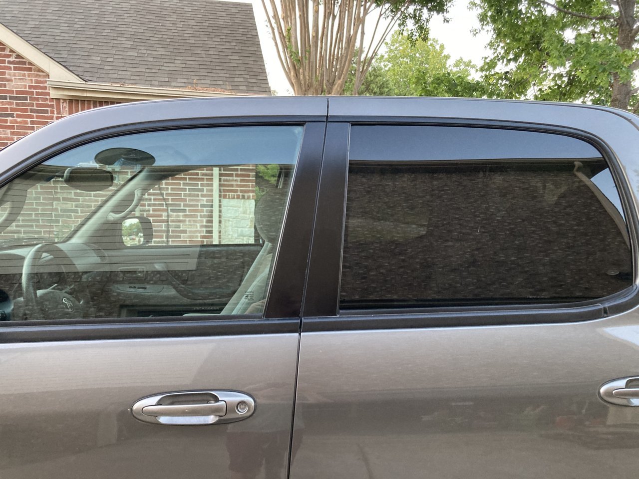

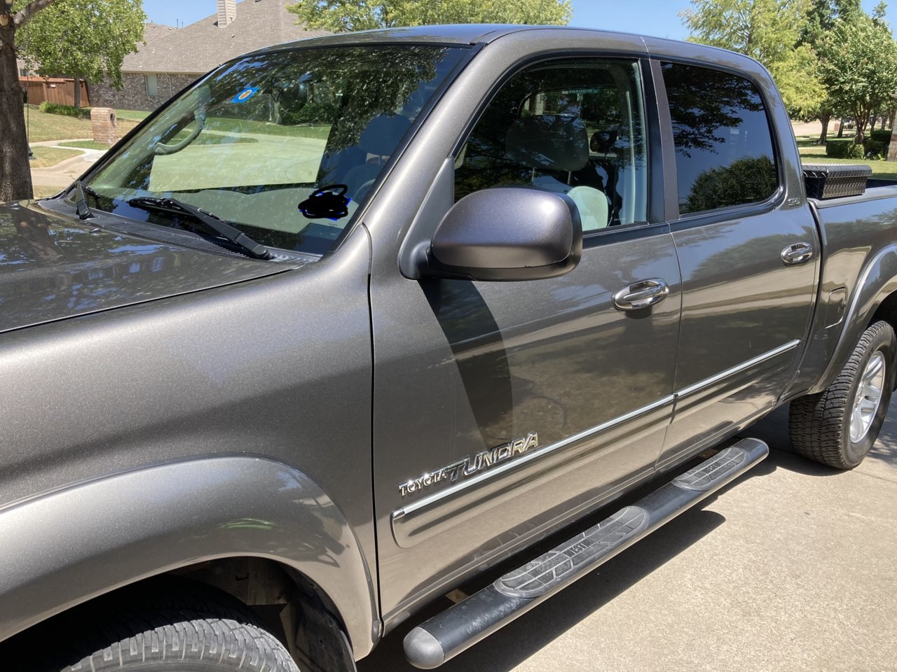

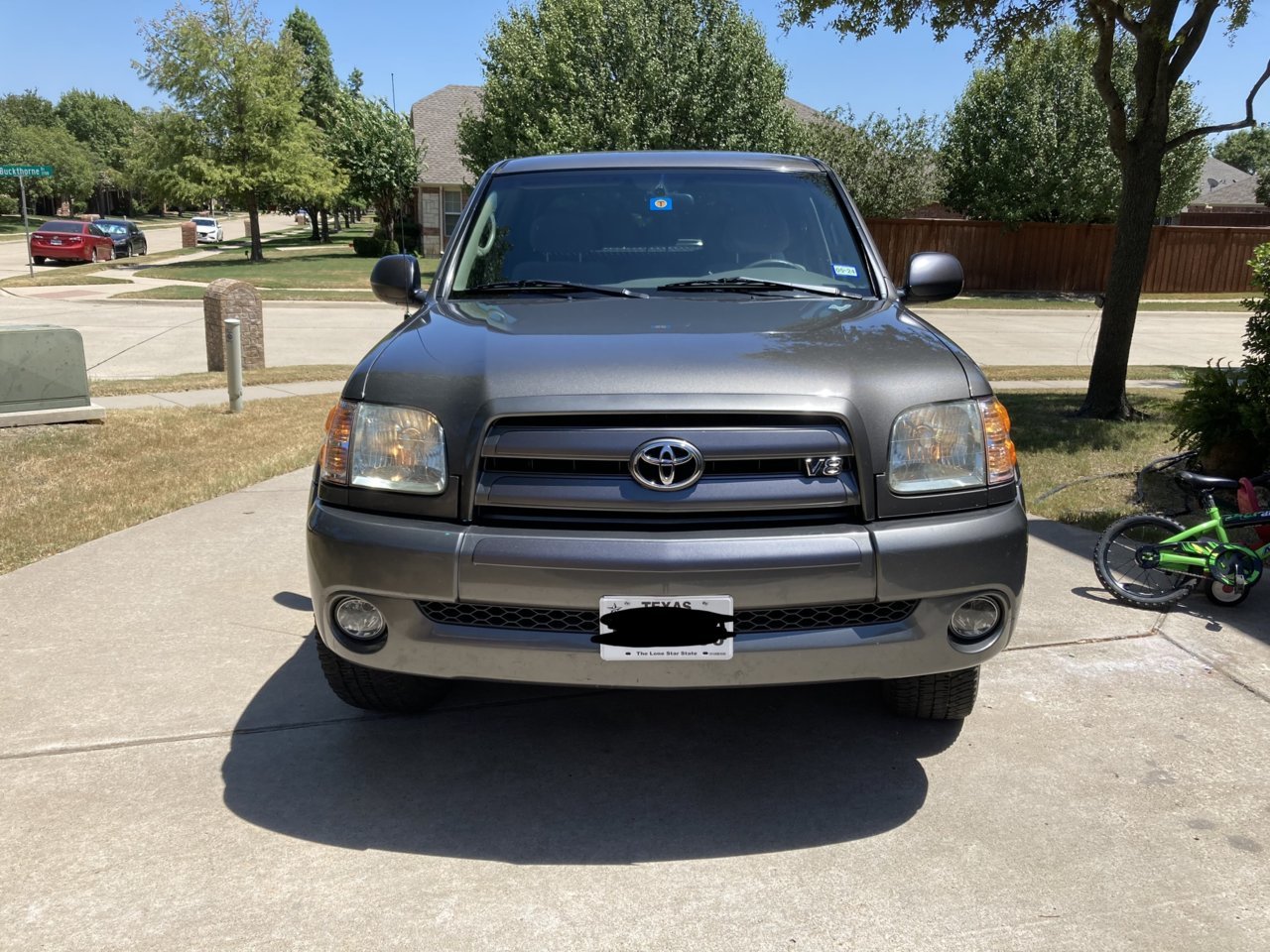

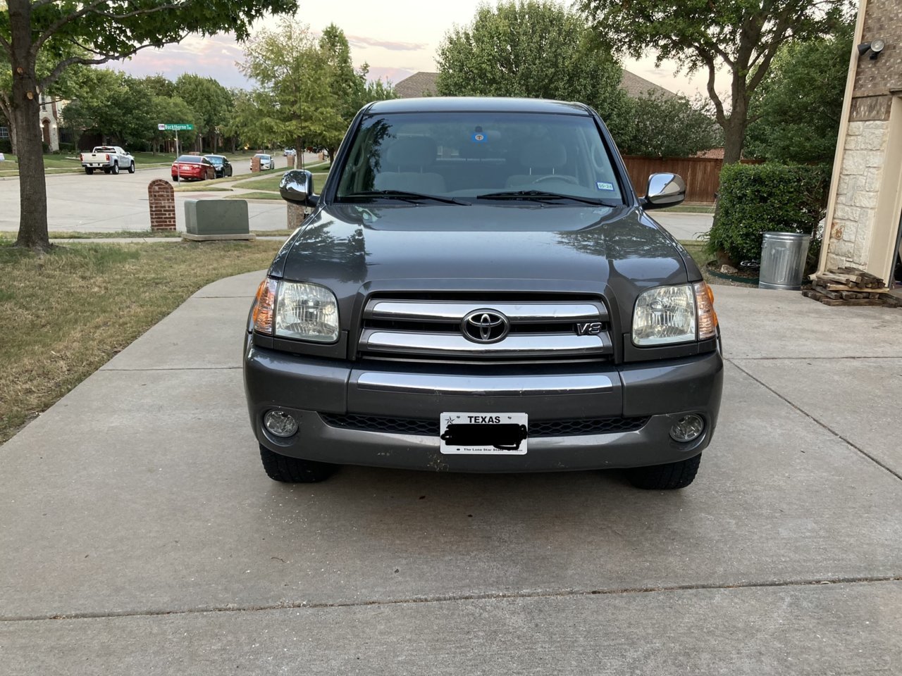

    But today just posting on the chrome delete I did. https://www.amazon.com/dp/B078X41NL1?ref=ppx_pop_dt_b_product_details. Bought this 5’x1’ vinyl wrap and did the mirrors and chrome parts of the grille. Lots of guidance from this thread - https://www.tundras.com/threads/2005-double-cab-4x4-daily-driver-warning-pic-heavy-little-ot.75017/. Pics below. Turned out pretty good, maybe 7/10.
    Takeaways for anyone who wants to give this a shot:
    • color listed above was a pretty good match for the phantom grey pearl.
    • The stuff was semi finicky to apply, as expected. I did mine in 105 degrees in the sun so that may not have helped, but I barely had to use the heat gun!
    • I bet this would work much better if you wrapped all the way over the edges of the pieces you were doing. I didn’t do that for the mirrors or grille. Grille looked pretty permanently attached from the back and I didn’t want to risk breaking a mirror.
    • Had a little left so I patched together some on the black trim piece just in front of the rear window to see what it’d look like. Not bad, what do y’all think? Could buy another piece and do that later. Thinking about the rear bumper…

    That turned out pretty good! That’s interesting on the B-pillar window trim. Would probably look good if you’ve got the time/interest to mess with it and do the rest of them.

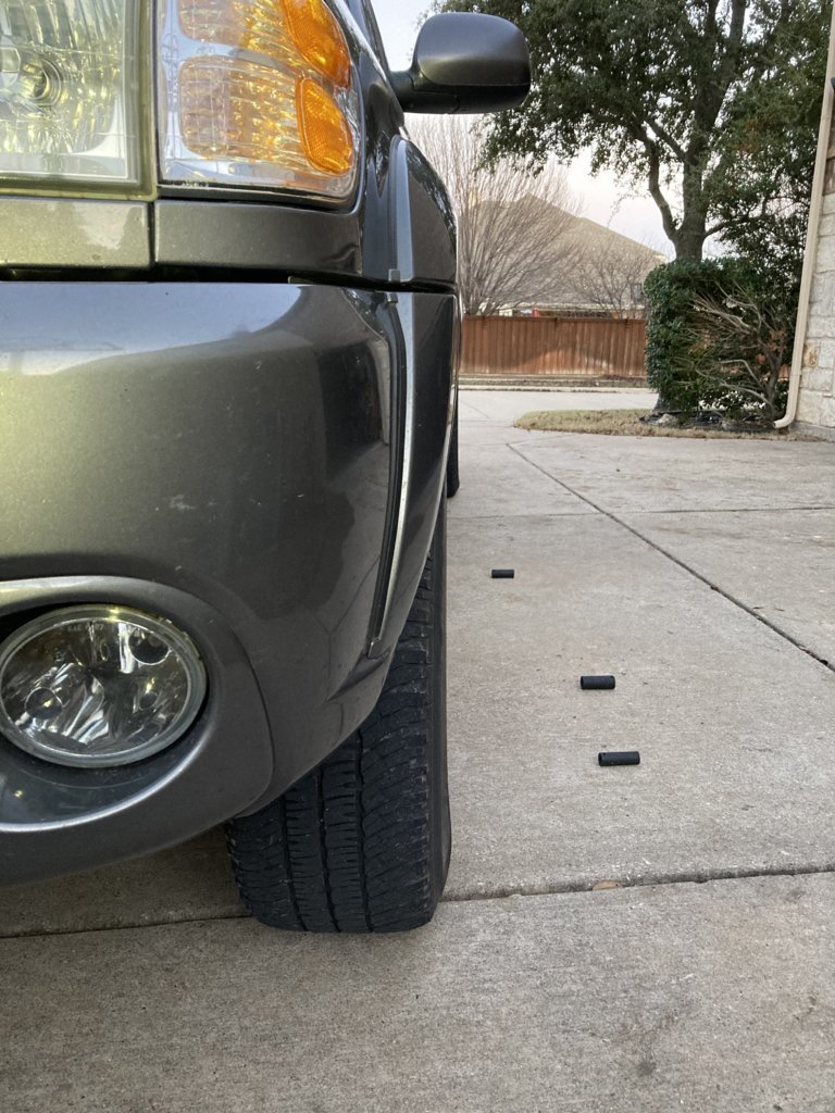

    Alright - first big post on the build log. Over the last week, I’ve added the front bilstein 6112s on 8/6 notches (preassembled), JBA upper control arms, new oem lower ball joints, suspension maxx extended sway bar links, new rear leafs from ATS with progressive wheeler add a leafs, gloss gunmetal TRD wheels, and 275/70/17 Toyo open country AT3s. Still pending are the 5160s for the rear, but they have proven to be very hard to track down. I’d like to share what I learned and stuff for anyone who is attempting this. Hopefully this helps someone out there!
    Some tips before you start
    1. Do the front end with a buddy if you can. I did mine with a friend who is relatively well versed in truck maintenance and knows how to work. The front end took me and him 7 hours and we were both working full speed the whole time.
    2. Rent a bunch of tools and kits from the LAP. I hit up both o’reilly and auto zone. I ended up renting a nice torque wrench, axle nut removal socket (35mm), and 4 different ball joint presses - c clamp style, pitman arm style, and clothespin style. And we had an air impact, air ratchet, pickle fork, and tons of sockets and wrenches with converters and flexible heads. Round up all the tools you can.
    3. If you have access to the Toyota manual for the truck it helps. The big dictionary one. We had it and referred to it quite a bit for torque specs and other things. There’s a great summary page with nearly all the torque specs for both the front and rear end suspension components.
    4. PB Blast all the bolts a couple times during the week leading up to the job. I have a pretty rust free truck and even so, I was happy I did it.
    5. Watch some youtubes. I got on 1stgenoffroad.com and watched a full install. It doesn't have to be brand specific to what you are doing, but it helps you get familiar with the whole process and general hiccups to expect.

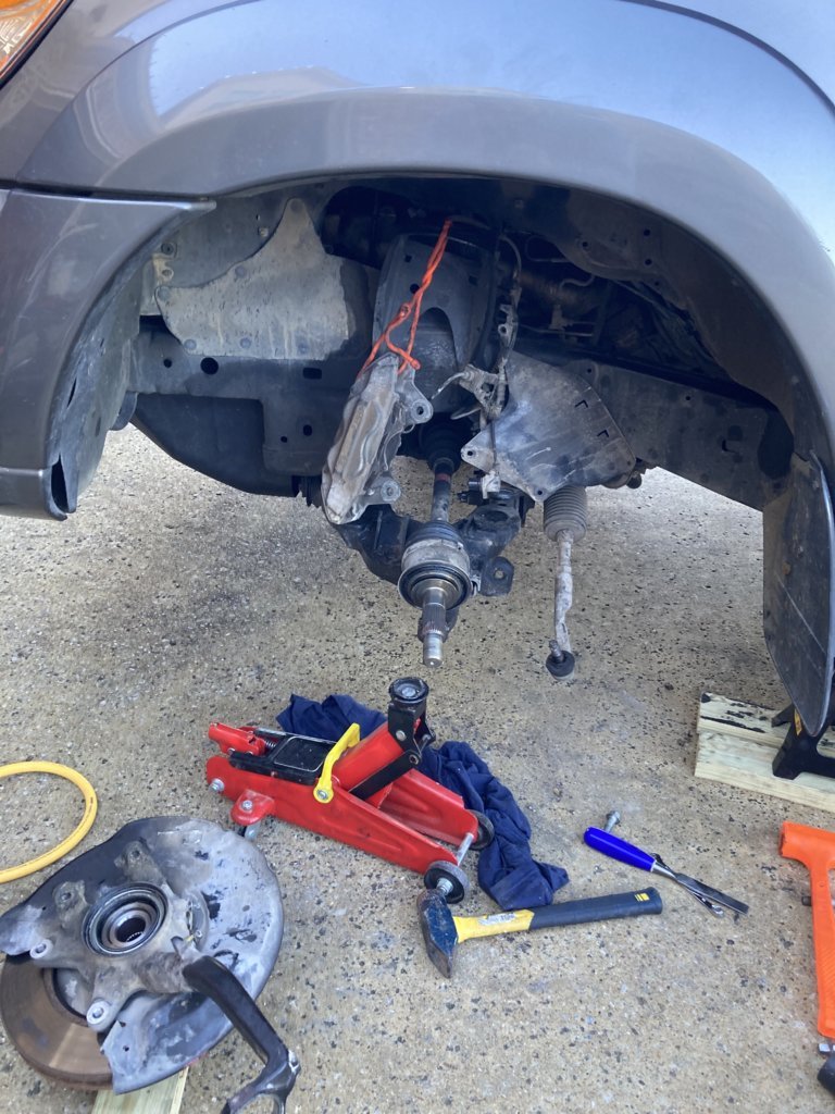

    So to start, we had trouble taking off the axle nut due to a compressor problem and the air wrench not working. So we progressed thinking we’d leave the knuckle on. Well we got about halfway in and were like there’s just no way we can do this with the knuckle on. Mainly because getting the upper ball joint pressed out would be dang near impossible. The c clamp style press we had wouldn’t fit in the wheel well. So we figured out the compressor problem and got the axle nut taken off. I don’t how you would do this without a 1/2” air impact. Maybe you could get it off with huge breaker bar. Breaking them loose (and torquing them down) by hand with the truck on stands and the spindle moving around on you is pretty hard. So be ready. But in my opinion, you gotta take that knuckle off if at all possible.
    The other difficulty during the disassembly portion is pressing out the ball joints. We got the tie rod to ball joint connection popped out pretty easy. I think we used a pitman arm puller and it came out pretty easy. The LBJ connection to the lower control arm was more stubborn. We used a hammer and I think the pitman arm puller there as well. Those things are sweet if they fit right. I'd rent as many sizes of those as you can. The big problem child was pressing the upper ball joint out of the knuckle. Once we got the nut on top of the upper control arm off it was seized up a bit, but it banged out fine with a 3 lb sledge. Then with the knuckle out and sitting on the ground, we got to work on pressing the UBJ out. First off, with all the adapters we had on the c clamp, even with it backed out as far as it would go, there wasn't clearance for everything to fit in the squeeze zone. Also, the top end of the ball joint where it is threaded to go thru the upper control joint pivots all over the place as soon as you put any pressure on it. So we used a grinder and cut off the upper section of the ball joint til it was basically just the ball and a little bit of the post protruding up from there. Then it fit just fine and didn't pivot around. Obviously, you can only do this if you have a new UBJ to replace it. So we knew going in to make sure you get the snap ring off before you try to press the UBJ out. Well, only idiots forget that, right? So we cut the boot off the UBJ to have clear view and when we cut it off, we pulled of a snap ringish looking metal piece that sort of resembled a short section of slinky. We thought it was the snap ring, but it wasn't. I think it was actually just part of the boot. So then we tried to press the UBJ out and it wouldn't go. Then we saw the snap ring and got it off. Then it pressed out but not without some uggas. We had to use the huge c-clamp style press with an air impact. We also had a set of 10 or 12 adapter rings that was necessary to fit on the cast portion of the knuckle but left the exit clear for the UBJ to come out. It's pretty tight tolerance there, so the specific adapter was really helpful.
    The rest of everything really came out fine. We hung the caliper up to keep it out of the way. The shock dropped out super easy. One little snafu that @shifty` called was that on the driver side, the long thru bolt that holds the UCA in runs into a clip that holds a few rigid brake lines (I think that's what it was). We had to unbolt that clip and gently press it out of the way to get that bolt all the way out.
    The reinstall was smoother. The one challenge was pressing the JBA upper ball joint in. We didn't put it in the freezer and I wish we had. The driver side went in pretty smooth using the big c clamp press and adapters. The passenger side got a little crooked when we started and it was tough to straighten it up. I was cringing a little bit as we pressed it in because I could see a hair size metal shaving come off due to it going in a little bit crooked but once it got to the end it seated solid and even. Not optimal, but that thing seats so tight that as long as the final seat location is straight and solid, which it was, I'm personally good with it. Just a heads up to make sure when you do that, try to start super straight and keep it pressing in evenly the whole time if possible.
    MAKE SURE YOU HAVE THE BRAKE LINES IN THE RIGHT SPOT WHEN YOU BOLT THE KNUCKLE BACK ON. DON'T ASK HOW I KNOW THAT.
    And last, when you go to torque the axle nut back on, it's gonna be tough. My torque was 173 ft lbs. We got them to 173 with a torque wrench. Not sure how kosher it is, but we put the lugs on two of the studs and jacked it up on those then torqued it and it helped. It sucks, that's all the advice I got there.

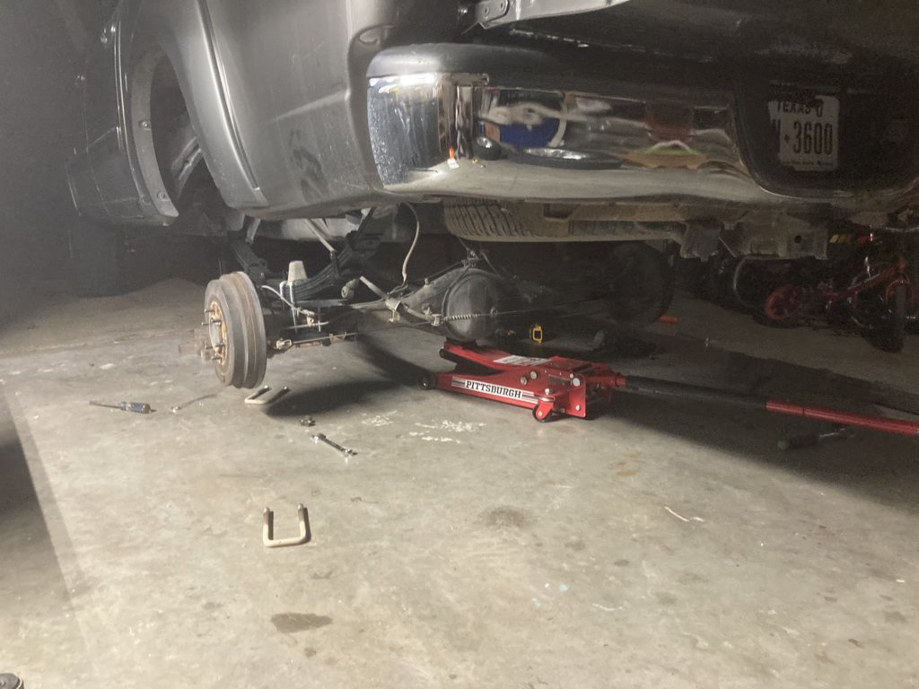

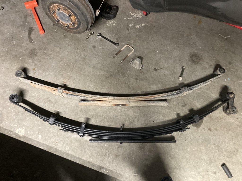

    For the rear, I decided to go ahead put new leafs on. The guy I bought it from did some heavier towing and I just figured if I was gonna put add-a-leafs, I might as well just go full on and get new leafs too. I did this job alone in about 3.5 or 4 hours. I jacked up the truck on the read diff pretty high and put stands under the frame then got to work. It all came off pretty smoothly. You have to take the shackle off with the leaf because I think the bolt from the leaf to the shackle just wouldn't pop out all the way before it bumped into something. Use the c clamps to hold all the leafs together when you are assembling everything. So, as I was putting everything together, I just had a gut feel that I should leave the overload in. The catch was the clip would pinch between the add a leaf and the overload. So I cut the overload to clear the clip, which you can see in the picture below. One little thing that came up was that the washers provided with the u bolts from wheelers didn't seat nicely in the bottom of the spring seat piece that the u bolts bolt thru. So I just reused the oem washers at that spot and it fixed it. A takeaway I had from doing the leafs is that you gotta kinda use the jack and stands to your advantage. I just would go step by step and move the jack around to different spots, up and down, to the axle, back to the diff and what not. Got everything back on and torqued to spec and gave it a test drive. I just left the shocks on for now while I wait for the 5160's. I did not get much lift at all from the AAL, so I'm real glad I left the overload. I saved my old leafs and I may make a bastard pack in the future. If I could snap my fingers and get about 1/2" more rake, I would.

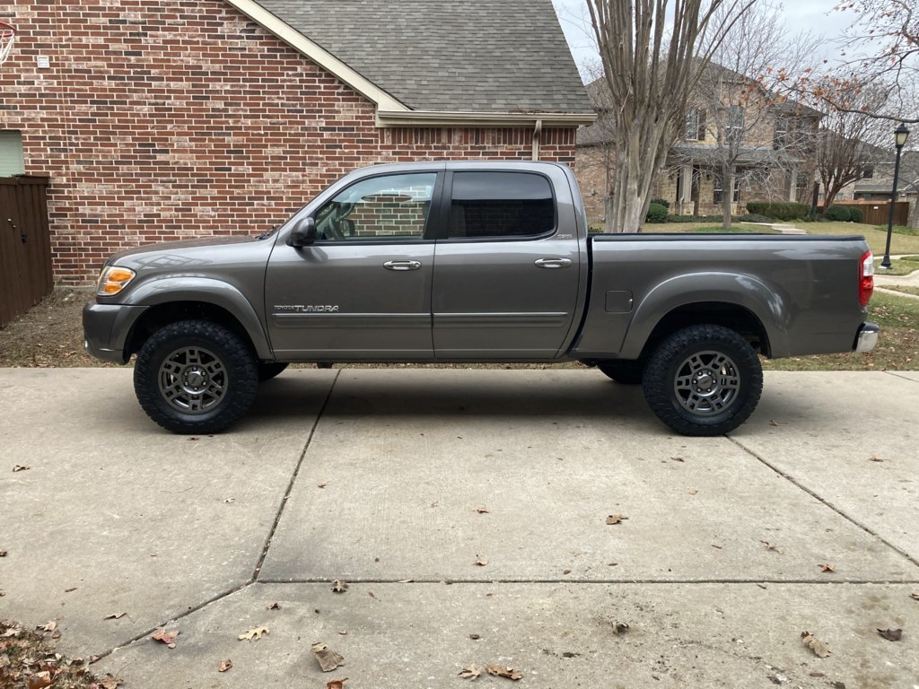

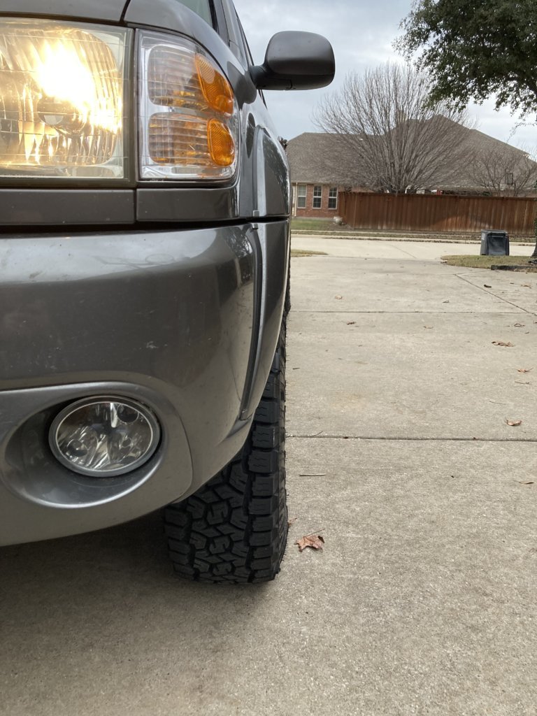

    So when it comes to wheels and tires, I deliberated forever on what to put on. I love these TRD wheels and wanted them pretty bad. Got em on black friday at less that $200 each, so a great deal in my book for some sweet wheels. They are 7" wide, so it limits you to a little bit skinnier tires, but I really didn't want to go any wider than it allowed anyway. I had considered 285/70/17, but I just really didn't want to deal with a lot of rubbing or spacers and I think those would have been more trouble in those arenas. I also like the high and tight look without any poke. I looked into 255/80/17, but after reading other guys on here, I just felt that was probably a little tall for what is realistically a road queen with some light off road adventures a few times a year. So I originally settled on 255/75/17. When discount tire mounted them, I just felt like they were a little skinnier than what I was looking for and I wanted them to be a little more flush with the fender instead of inset. So, I upped it to 275/70/17s. The only con is that the open country AT3s in that size are only E rated. I can tell on the road it is a little rougher, but nothing life changing. I still need to air down a bit and see if that softens up the ride. I think the ride is about break even between stock suspension and SL tires and 6112s on the E-rated. It rode super nice when I had the 6112s on and still had my SLs on last week, but I'm still really happy with what I got. These open countrys looks freakin sweet.
    The main thing is that I am really pleased with the proportion of the overall lift and tires. Proportion, imho, is the hardest thing to get right with lifts and tires and I am really happy with where I landed. The look I got is nearly exactly what I was shooting for. I'll post exact measurements on the measure up thread, but I basically got average of 2 1/4" lift in the front and 1" in the rear (hub to fender). I now have about a 1" rake from front to back. Again, I'd take a little more rake if I could, but it's really close. A lot depends on how much sag I get with 500 lbs in the back and the 5160s in. I'll make the call then if I think it is worth making a bastard pack and building some more rake back in.
    Pics below. Sorry I didn't take more, but you know how it is.

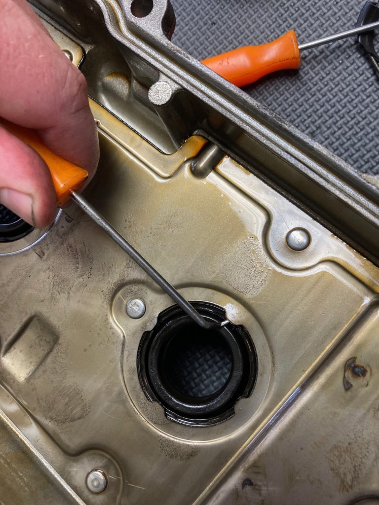

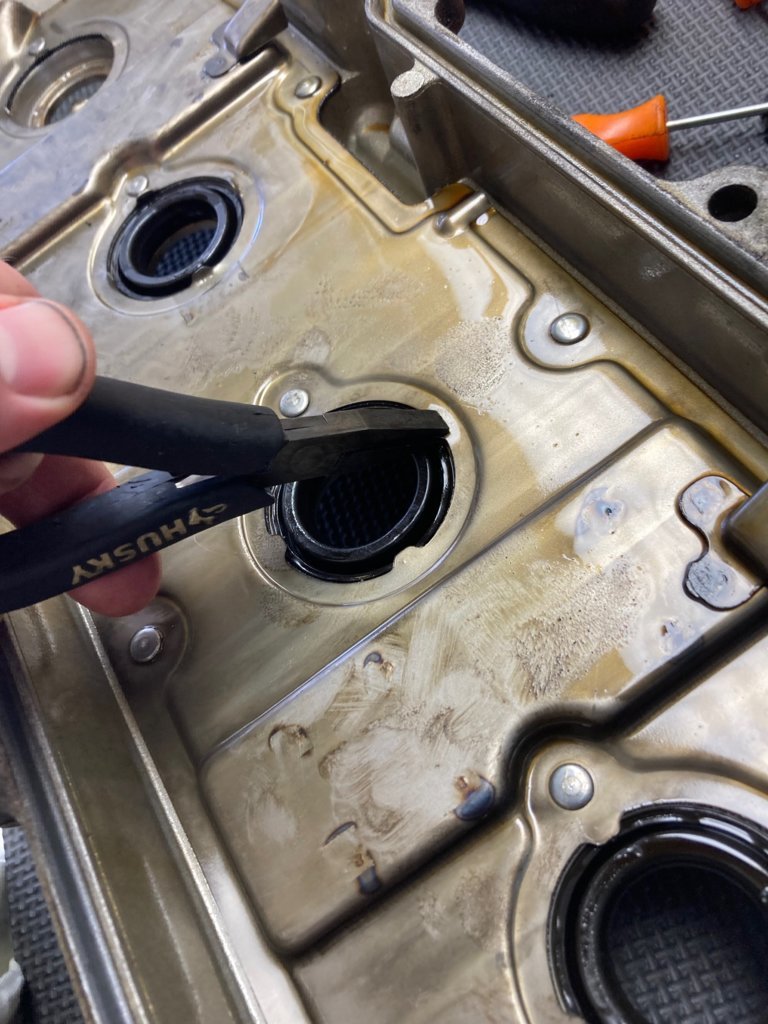

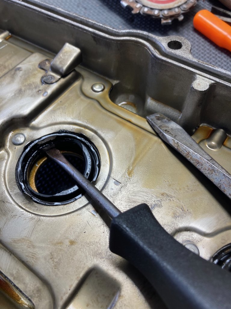

    Alright - Most recent job on the truck was the Valve Cover gaskets. I'll try to share my experience here so hopefully it'll help someone out.
    I just passed 200k and they were leaking during the winter, so I decided to go ahead and replace them. We are gonna ignore the fact that I never tightened the bolts to see if that would stop the leak and just say that they probably needed to be replaced anyway. About 16 of the 18 bolts holding them down were basically hand tight. So, could I have gotten away with tightening them down and running for another 50k? Maybe, but I know its a common problem spot and I have old oil caked everywhere that aligns with a VC gasket leak. Something I didn't think of - save this job until right before you need an oil change. Do the job, then drive 10 or 20 miles, then change your oil and oil filter. That way if you get any contamination in the engine, you only have it bouncing around in there for a very short period and then hopefully you drain the contamination out or it comes out with the filter.
    First off, this is the thread I mostly referenced and it has a lot of good info. https://www.tundras.com/threads/valve-covers-fix-or-leave.105385/

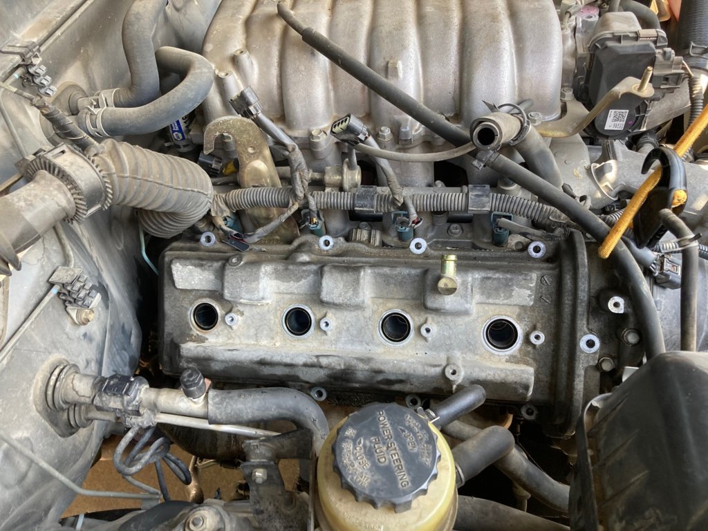

    I started on the passenger side. I pulled the engine nameplate cover and air hose and bungeed some of the stuff out of the way. See photo below.
    As you can see, lots of debris and dust on everything. Honestly, this was the main thing I was concerned about the whole time. Getting everything apart without dropping junk into the engine was tough. I pre-cleaned the other side before I pulled anything and it helped a lot. I also had a lot of the old looming just flaking apart (you can see this in the above pic right next to the upper rearmost VC bolt). VC popped off pretty easily. Then I cleaned the perimeter where the gasket sits, careful to minimize dust and junk dropping into the engine. I pulled the half moons with channel locks and they came out with a couple wiggles and a firm pull. Then I cleaned up the old FIPG with a razor, a rag and some brake kleen. This part sucks and is way more of a pain than I expected. I wish I had some single side razors, but all i had was utility knife blades, so I used that.

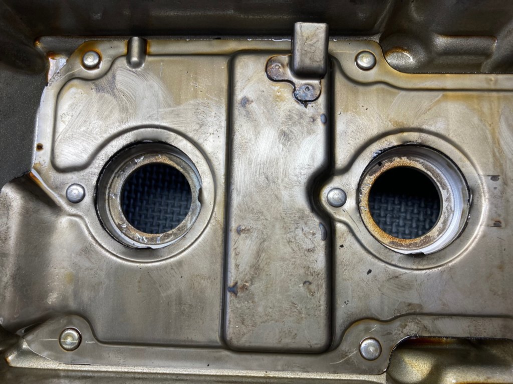

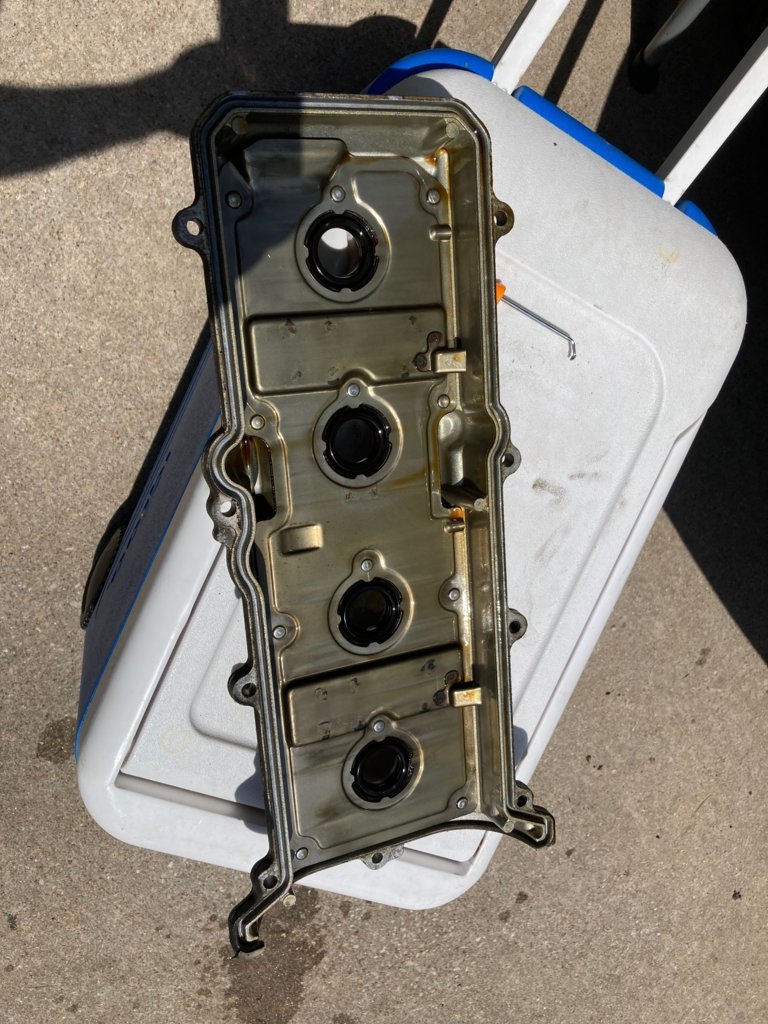

    Next I took the valve cover over to the bench and cleaned it up. I was very pleasantly surprised with how clean it was (pic below). Drivers side was a little dirtier, but not much. One spray and wipe with brake kleen and it was pristine. My day to day driving is mostly short distance in town, but I do take this truck on the highway a few times a month, on three or four 500 mile road trips a year, and one 2000 mile trip a year. So I think those longer drives are keeping it all moving. Plus I religiously change my oil with synthetic at 5k mile increments. Below are some pictures showing how I bent the tabs up and got the tube seals out. I found that it was pretty tough to get a good hold of the tabs with flat nose pliers without giving it a little prebend. So i used the orange handle pick to get under them and bend them up just a bit (pic below). Then I grabbed them with the flat nose pliers and bent up (pic below). Most of them I needed to do a preliminary bend and then reach a little farther in and really bend the whole tab up and out of the way. Tip: bend the tab ALL the way out of the way. I had an issue putting one of the new tube seals in and it kinda dragged/got stuck on a tab that wasn't totally out of the way. To get the old tube seals out, I used a couple flathead screwdrivers. I watched the videos of guys pounding these out with pry bars and that seemed a little rough for a spot that seals with a gasket. The tube seals are kinda two part - they have like an inner and outer portion. So i would just rip out the inner portion with a pick or screwdriver. Then I would shimmy a small flathead under it the edge of the tube seal and gently twist and dig to get it starting to pry up (pic below). Then get a bigger flathead in and twist and they popped out. You can see in the last pic below I kinda marred up the bottom surface a little bit on the left one, but once I got going, it was pretty minimal. From the videos, it seems like the vertical walls are really the areas you want to be careful with since this is where it seals. With the old tube seals out, I scrubbed clean the gasket channel and the tube seal seating areas. To put the new tube seals in, I coated the external surface with oil, then set them in place and used a 30 mm socket and pressed them in by hand. I did not find they needed to be hammered in - with firm hand pressure they sort of just popped down in. Then I used the flat head of a nail and hammer to pop the tabs back down. Then in with the gasket.
    When you go to install the cover, I'd have all your sockets, extension, wobbleheads, etc., ready to go. Once you put the fipg and half moons on, you're on the clock. This is where I screwed up the first time. I did not have all my stuff ready and wasn't prepared to have to tighten all 9 bolts about 4 times each and the gasket squished in unevenly. So, once I figured it out and did it on the drivers side and the second time on the passenger side, I did the following: set the cover on, then hand tighten the bolts quickly so they are all threaded and not at risk of stripping. Start with a long extension and wobble head on a cordless or impact on SUPERLOW torque setting and do all 9 in an inside out x pattern. You'll notice that as you go, the bolts that you just tightened will be loose again because the other bolts have continued to compress the gasket and relieve pressure. If you're like me, that'll piss you off. Just keep moving in the same pattern and tighten them evenly - even count turns if you need to. I think I did the second and third time through with a regular socket wrench. Then I did the fourth time through with the torque wrench to 53 in/lb. IN/LB!!! The rearmost lower bolt on the passenger side is tough to get to due to the transmission dipstick. I just used a ratcheting wrench on that by feel, using the other bolts as a calibrator for my hand.
    Then wait for your oil leak. My passenger side was leaking pretty significantly after my first attempt. Like I went from about 1/4 up between the disptick dots all the way to the bottom dot in 24 hours. I figured out that I likely had a bulge or fold in the gasket from uneven tightening. A mirror is useful to look at this. So I took it off, cleaned up and reset it and followed my procedure above last night in my driveway in the dark sweating my butt off. Drove to work this morning and no leak, so hopefully we're good. My check engine light did come on last night so I need to run to LAP and get it cleared. Hopefully just a low oil pressure code or something.
    All in all, not too bad. Probably a 4 hour job for a mechanically inclined novice like me. 5.5 hours if you have to do the passenger side twice. I hope this helps someone out. I'd be lost without all the tips and videos posted on here.
