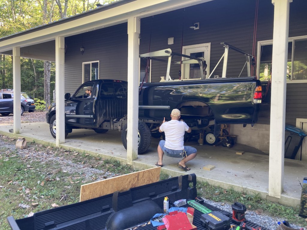

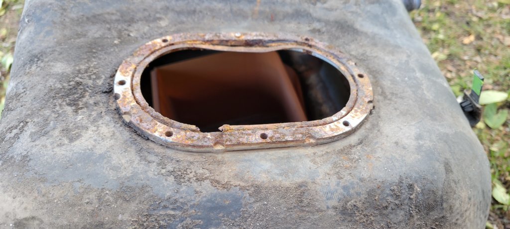

    The fuel tank on my husband’s 2003 Tundra crapped out. Rust ate through under the cross member and shes pooched.
    We’ve both searched everywhere and have been unable to find an OEM replacement anywhere in the entire country. Any that let you ‘put in cart’ get kicked back and the dealers say they arent actually available. We’ve both called a couple dozen places at this point. Now torn between an aftermarket chinesium one or rolling the dice on a take-off tank from a salvage yard somewhere outside the rust belt.
    Anyone have any leads, input from experience on aftermarket tanks, anything?
    His Tundra is down and hes driving mine in the meantime. :( (I luckily have my electrical work van to get around in but trying to find a fix)

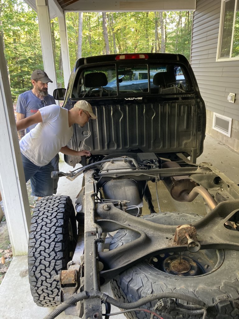

    It’s not as rusty as I expected, but I’d need some frame shots from underneath. He must take good care of it!

    Its a South Carolina car, he got it in 2008 and he washes and undercoats the everloving shit out of the thing. I couldnt believe how nice it was when the bed came off. He had the coating recall from the dealer like five years back and they thought he had his frame replaced recently (nope, original frame).

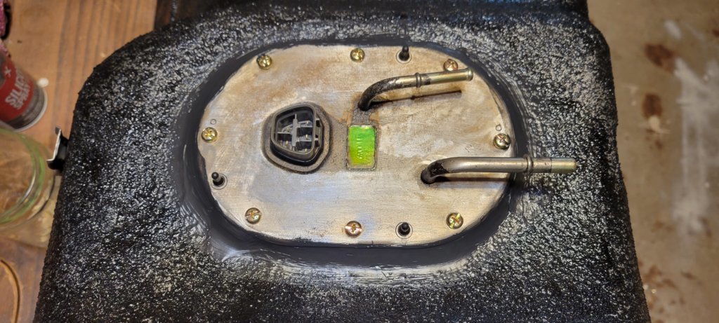

    I think the math maths on that. Just wanted to see before I ordered. Anything else you recommend replacing along with the tank? I have what i assume is 341K on the original parts since j have no records. Did you coat the outside of the tank in anything as well?

    When I replaced mine I questioned that very thing. I ended up putting it on. But I had coated the entire tank in Hurculiner too.
