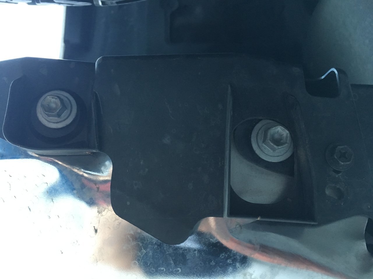

    Good to go! Remove front mud flap is all, at least my case. IMG_20180502_132830330_HDR.jpg
    Edit, just seen you said you are leveled, shouldn't need to remove anything.
