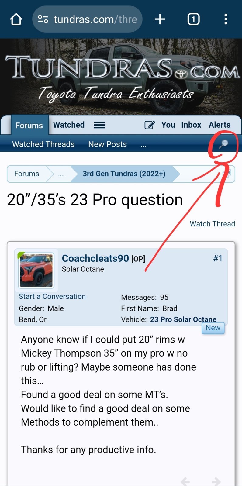

    Anyone know if I could put 20” rims w Mickey Thompson 35” on my pro w no rub or lifting? Maybe someone has done this…
    Found a good deal on some MT’s. Would like to find a good deal on some Methods to complement them..
    Thanks for any productive info.

    You might be the first person to try and put 35" tires on a third gen!!! If only there was a way to search for such a question.

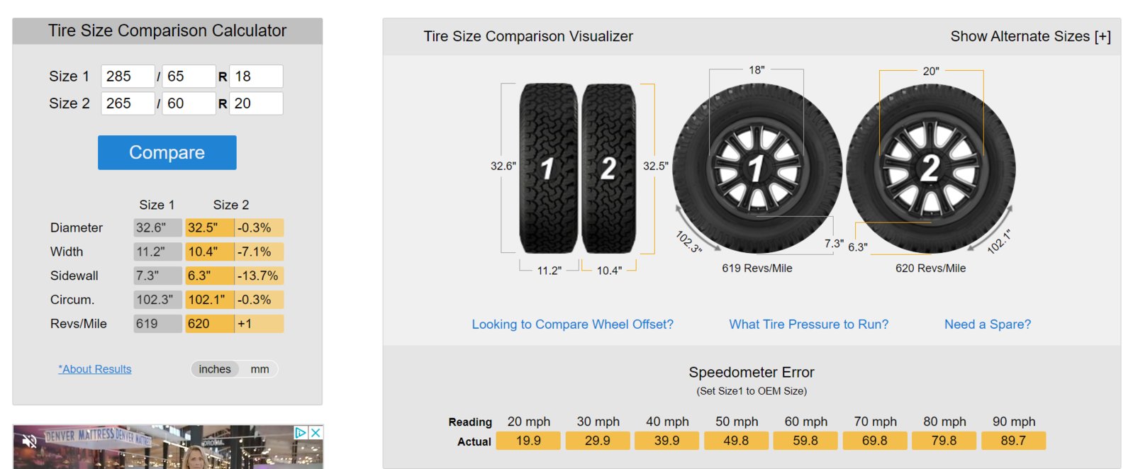

    Ahhh well OP @Coachcleats90 that makes more sense now..... the actual question was. "I don't understand how tire size and wheel size are related." See below for some reading. Putting a 35" tires on a 20" rim is very common on here, its just more common to put them on an 18" or 17" rim to maximize sidewall for a better ride off-road with lower air pressure.
    Offset of wheels is another lesson. Will a 35" tire work on a 20" rim? yes it will. That all depends on how wide the tire size is and the offset of rim. There are many threads discussing this topic...hence the maybe you're the first to consider this.
    https://www.tirerack.com/upgrade-garage/how-do-i-read-my-tire-size-on-my-sidewall?gclid=CjwKCAiAq4KuBhA6EiwArMAw1BzmUeMXXg9J4Nf5ctfqoprLLtRWiVDHYndSADzlxseBg1QtvZ5AYhoCN1cQAvD_BwE&ef_id=CjwKCAiAq4KuBhA6EiwArMAw1BzmUeMXXg9J4Nf5ctfqoprLLtRWiVDHYndSADzlxseBg1QtvZ5AYhoCN1cQAvD_BwE:G:s&s_kwcid=AL!3756!3!354820920464!e!!g!!tire sizes explained&gclsrc=aw.ds&gad_source=1
    You can compare tire size at that site above here is a comparison of the 20" and 18" tires that come on say a limited vs a PRO and how they compare to each other (285/65/18 vs 265/60/20).
