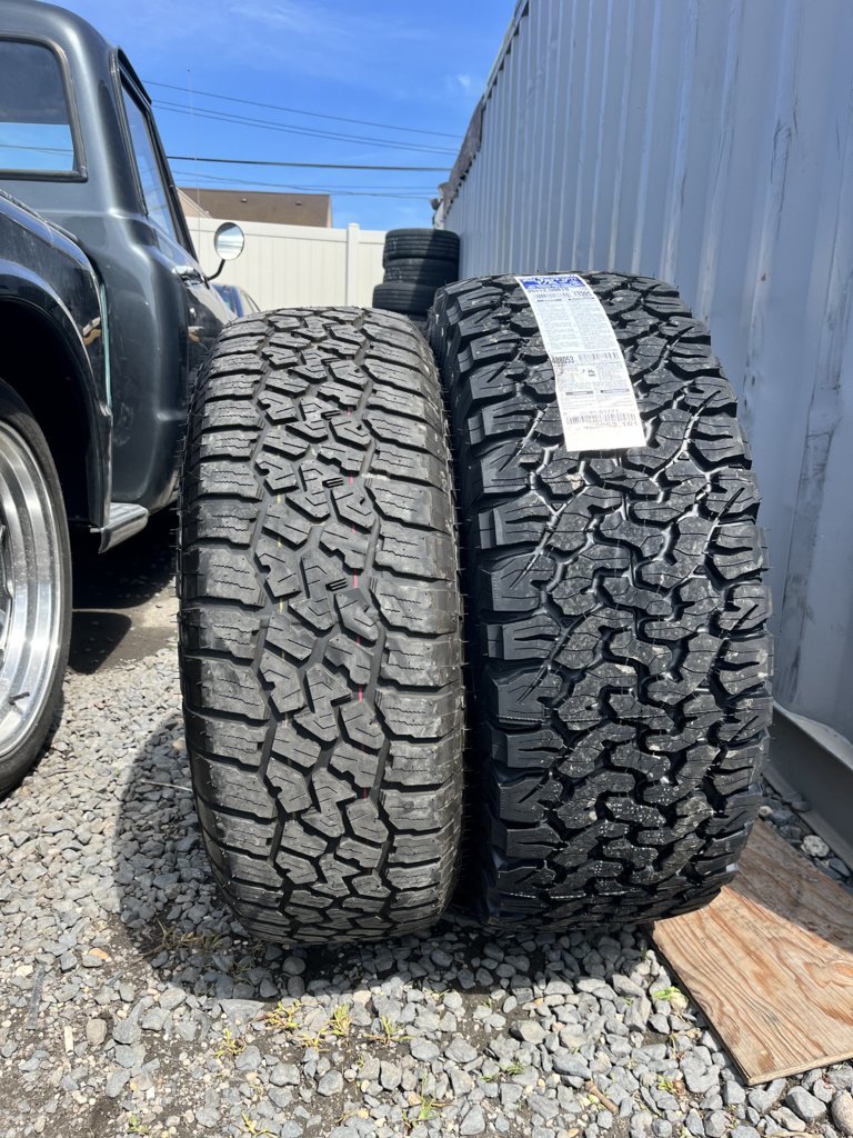

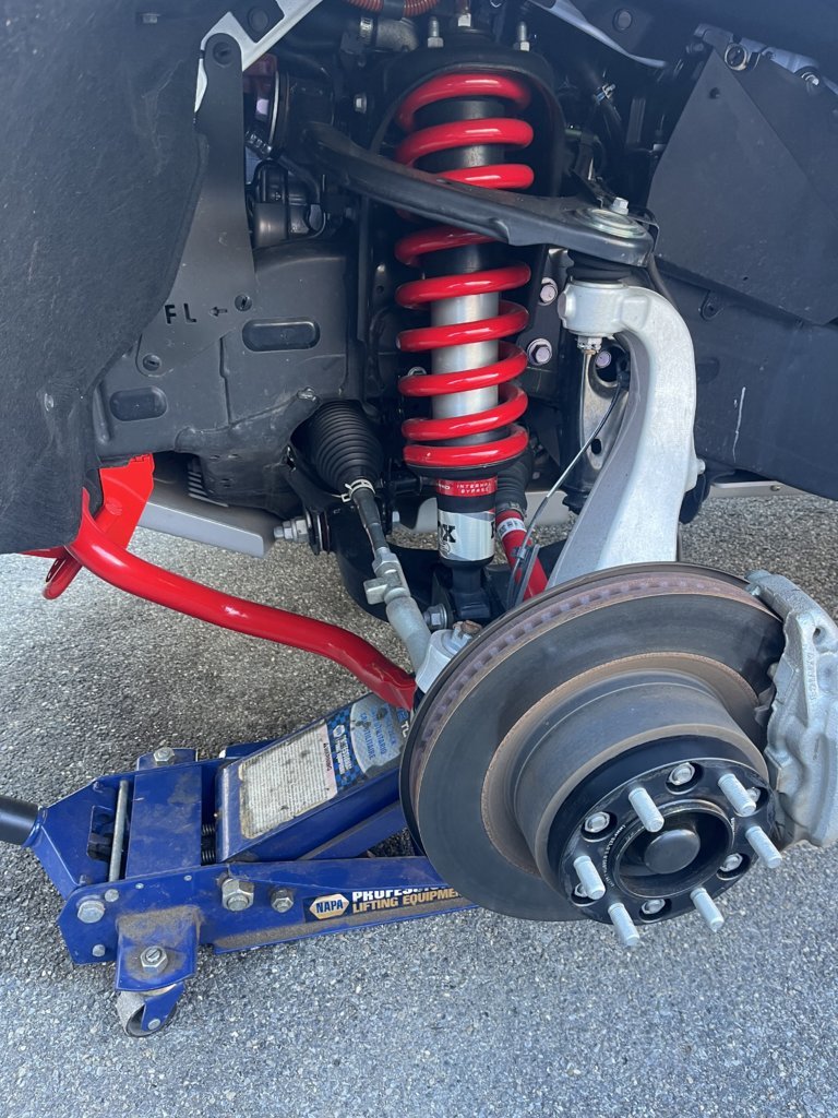

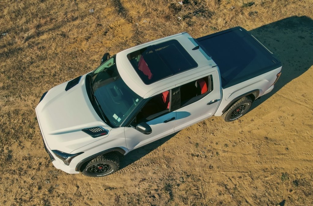

    IMG_1221.jpg IMG_1149.jpg IMG_7768.jpg Man, it’s been 2 yrs since I picked up my 23Pro. It now has 22,000 miles on it. I did all the mods I wanted the day after so I haven’t done much since. I had everything waiting before I got the truck. I put on a set of 35’s
    Go Rhino electric steps
    Gator roll up cover
    Tow hooks.
    Last yr put some 1” wheel spacers on.
    Love this thing. Can’t believe how many people still walk up to me and start talking about it. I came from two previous 2.5 gens but Toyota really made some big improvements with this truck.

    Sweet ride man. I assume you are running SpiderTrax 1" spacers? Did you have any rubbing with the 35's? Have to take off the mudflaps or do any fender liner trimming? I have the Eibach 1.5" lift springs up front so I was hoping to just be able to bolt them on and go with no modifications necessary.

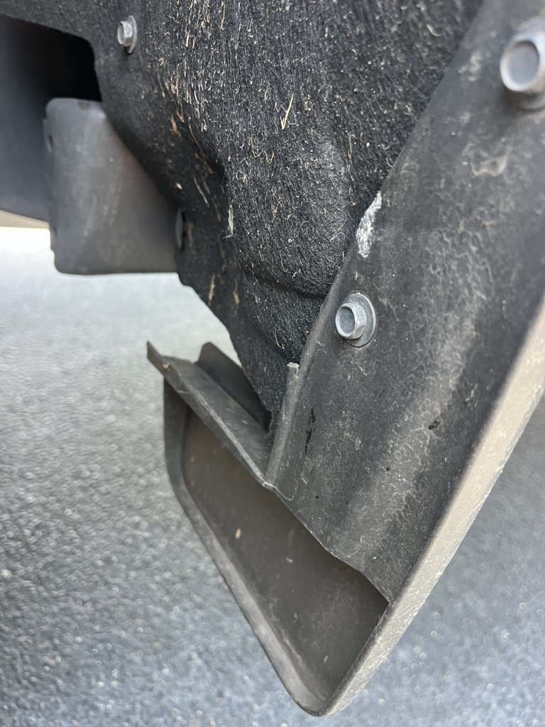

    Thanks. I had no rubbing until I did the spacers. Then I had to trim out my mudflaps. I actually have spacers from Burger motorsports on there. They’ve been on for about a yr so far IMG_0432.jpg

    No rubbing in front of tire? Just on mudflaps? Pics of how you trimmed them?

    I never had rubbing on the front. I just trimmed off the piece of the mudflap that protrudes out. Then I pinned back the fabric with a plastic push in plug. Or you could just remove them altogether. IMG_1479.jpg

    Did you have issues with the center caps on the Pro wheels with that spacer? I’m in the market for spacers for my 25 Pro.
    I noticed in one of your pics on the original post that the center cap wasn’t installed. Could be a pic from initial delivery but just wanted to make sure.
    Did you buy 2 sets of the same spacers from BMS for the front and rear?

    Yes. I bought 2 matching sets.
    And you were right. The pic without the center caps was pre delivery while it was on the lot.
