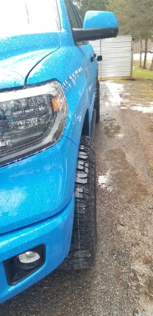

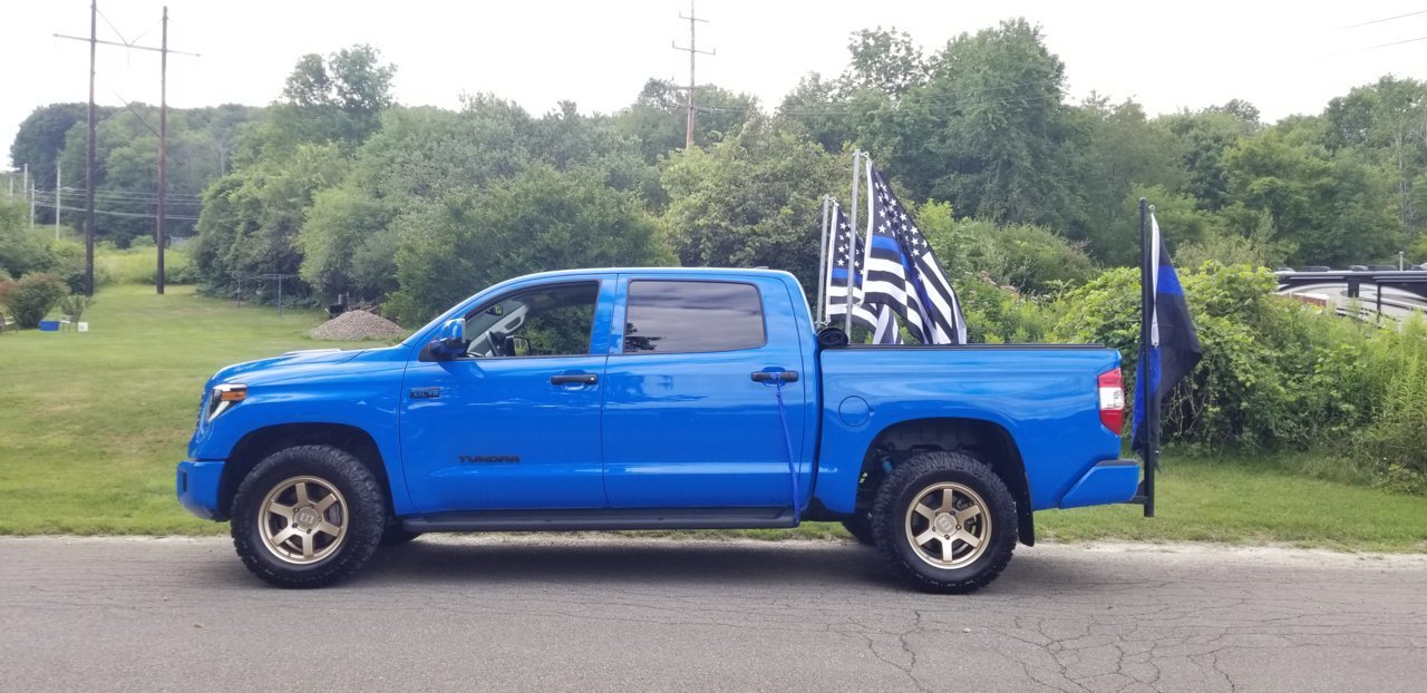

    33x12.50x18 +12 offset fits no rub, no lift, just had to remove front mud flaps
