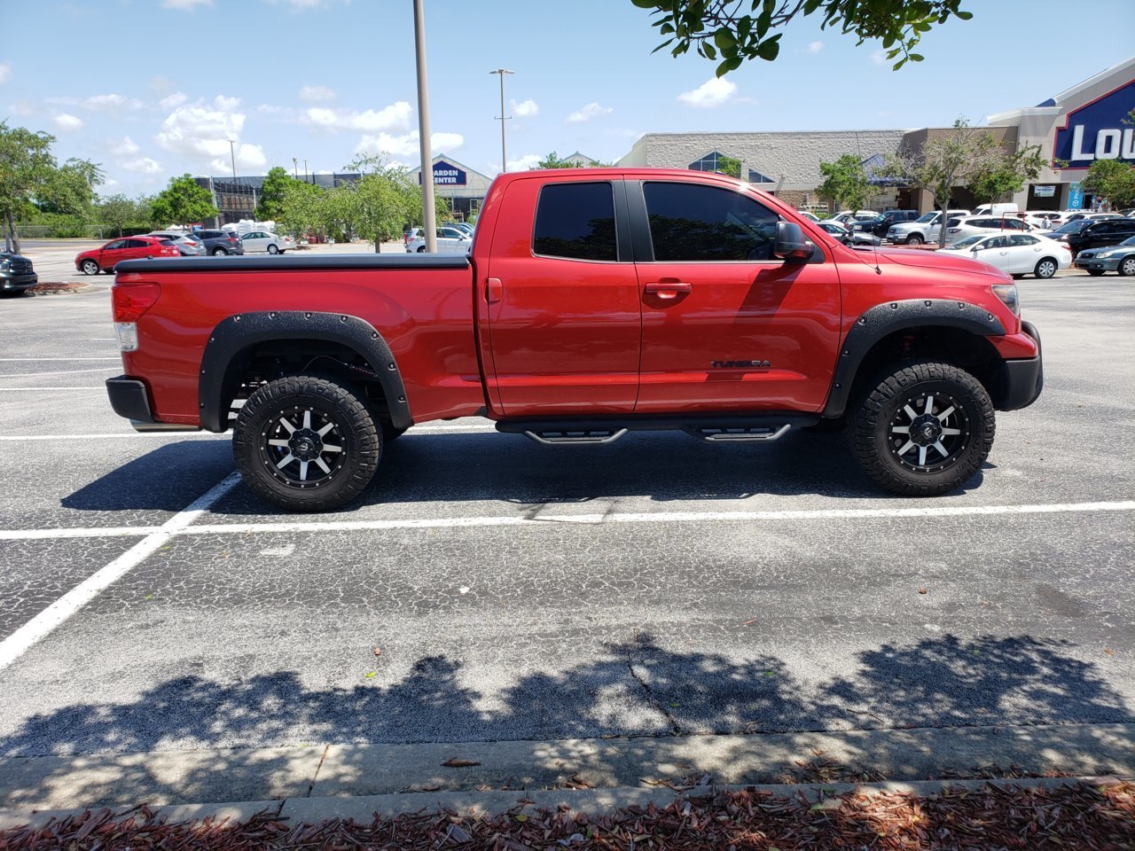

    I have Toytec Alumas set at 3" with 285/70/18 (34's) Ridge Grapplers on a 0 offset. I have minor rubbing on the front liners at full lock. 20200520_115259.jpg

    What wheels are those?

    Fuel Mavericks. Mine are D537. There is another Maverick as well in which the spokes are black. They are D538 If I recall correctly.
