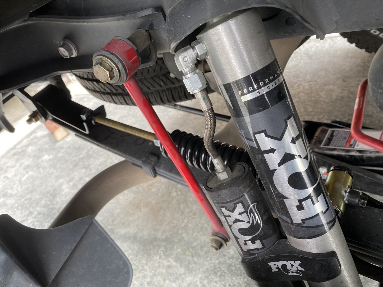

    Everyone need a reservoir shocks once in their life…;)
