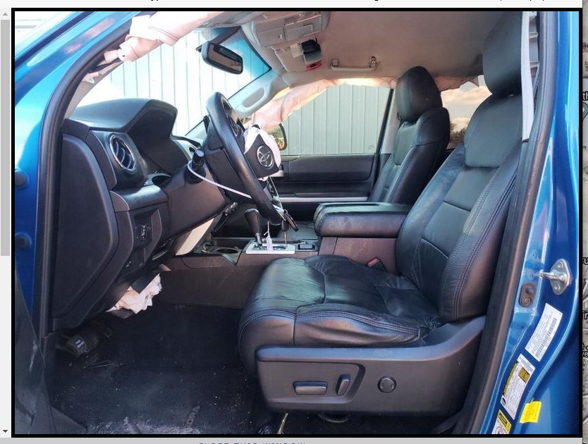

    I found a reasonably priced ($500 for the set) reasonable condition set of leather seats out of a 2016 at a local junkyard. I am wanting to swap them into my 2007 as my old leather is cracked and beyond repair.
    I am really hoping I can make this work. The condition of the seats in my truck right now is the one thing that makes me want to upgrade to a newer model. If I can fix it for $500 rather than $40,000 that'd be a big savings.
    I have a few questions that I am hoping someone here can answer here before I spend the coin.
    1. The truck the donor seats are coming from are coming from a wrecked truck. Some of the airbags have deployed (steering wheel, knee bag, curtain bags on both sides) but not the in-seat bags. Is it reasonable to assume the in-seat bags are still good?
    2. Wiring the seats. From some quick wiring diagram research, it looks like the seats have all the same wires, but some different style connectors. I am okay with salvaging the old connectors and from the old seats to make the plugs fit, but can anyone think of a compatibility issue between the electronics in the seat? As far as I know, the main components will be the electric adjustments, the airbag, the occupancy sensor, and the seat belt sensors (and maybe a seat heater)

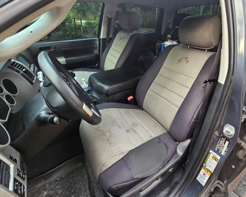

    I got the covers installed today. THey look great and fit excellent. The only small issue I ran into is the driver's bottom is a bit looser than it should be because the foam has degraded so much on the seat itself. The cover is designed for a new cushion, not one that has been broken down over 15 years. Its hard to see in the picture but the loose area is on the door side of the drivers seat where people tend to slide in and out.
    Pictures are of the old wet okole covers (did not last 2 years), the factor leather that was underneath, and the new clazzio covers.
