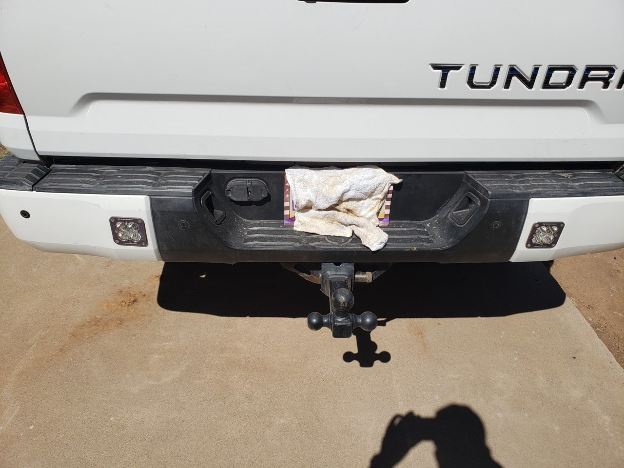

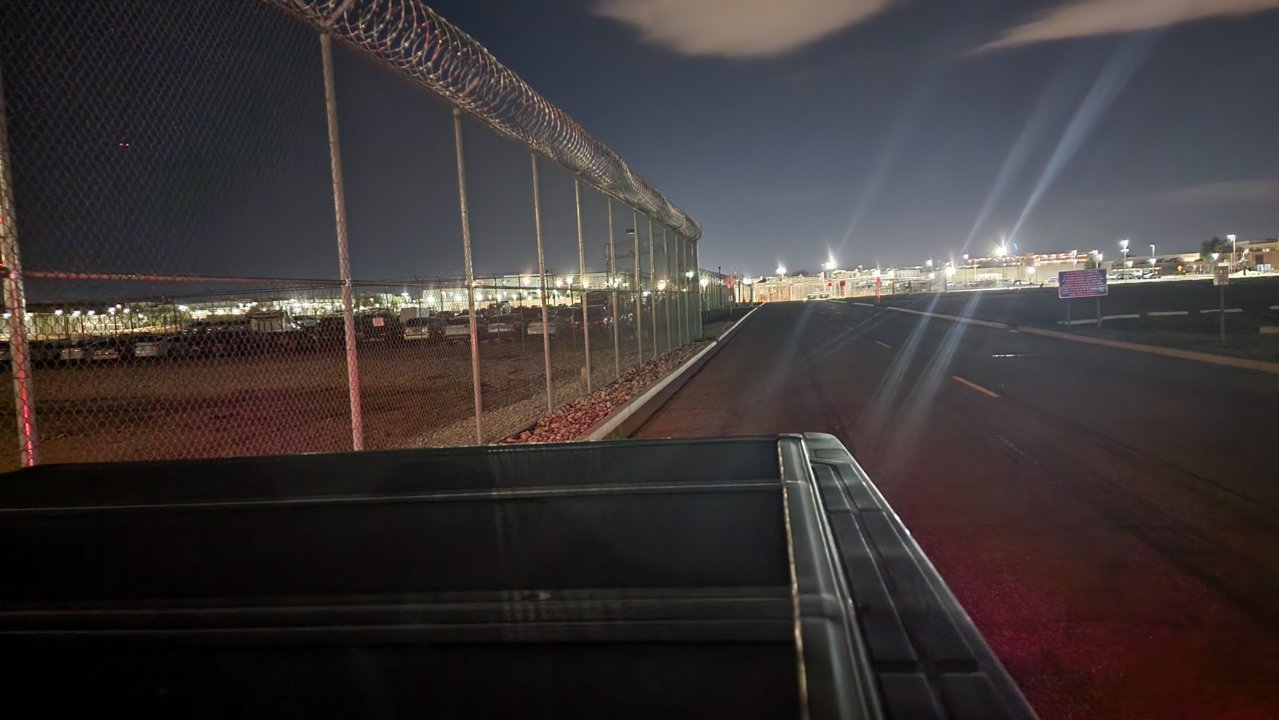

    Hidden 1200# Waren winch, Baja Desgins lights, Switch Pro switch and controller, S&B air box and in bed tool box.
    20210311_133208.jpgThis is what I did Baja Designs flush mount. And yes had to cut the metal, but, definitely worth it.

    I was actually thinking closer to the outboard sensors. Is there a reason other than asthetics that you put them there?

    This area was the flatest spot I could find. I'm using the driving combo lens, but someone could easily change to work/ seen lens. My setup works great for me.

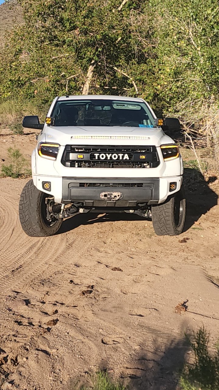

    20230228_225604.jpg 20230228_225604.jpg 20230228_225631.jpgKind of crappie pic, looks better in person but just an example for you

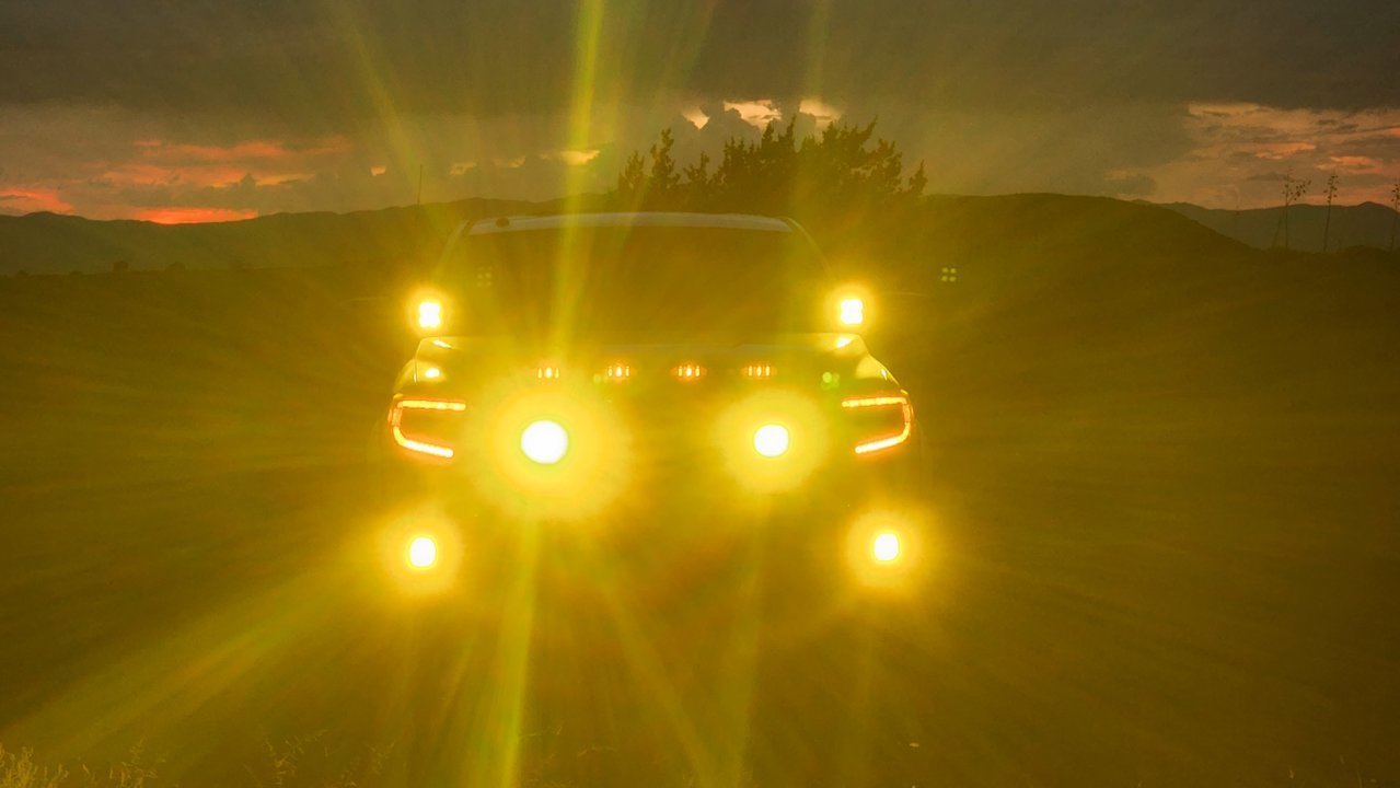

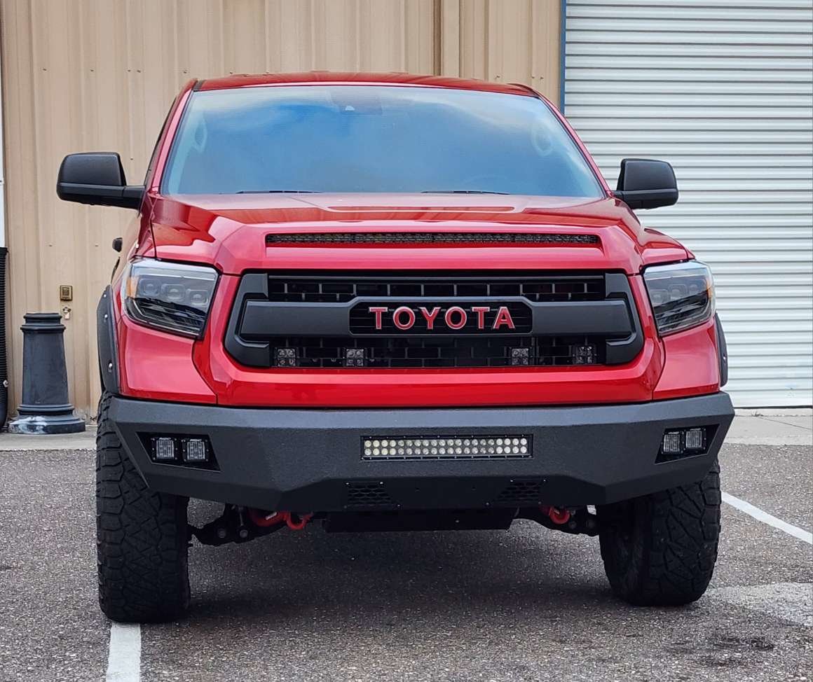

    20220813_193351.jpg 20220806_181851.jpgAll Baja Designs, sae fogs, S1s in grill and ditch. Just an option.

    Nice. If I replaced the 4 fogs then I would have unused Rigids again lol. I just switched to that Pro grille so that I could make a home for the 4 behind it. :D

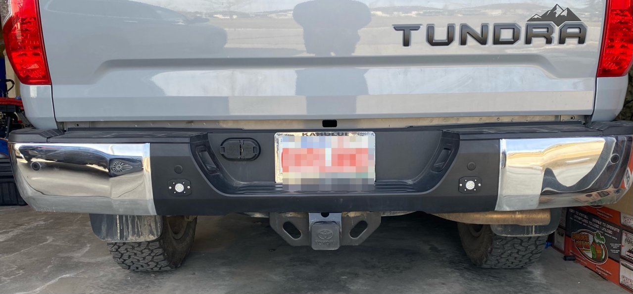

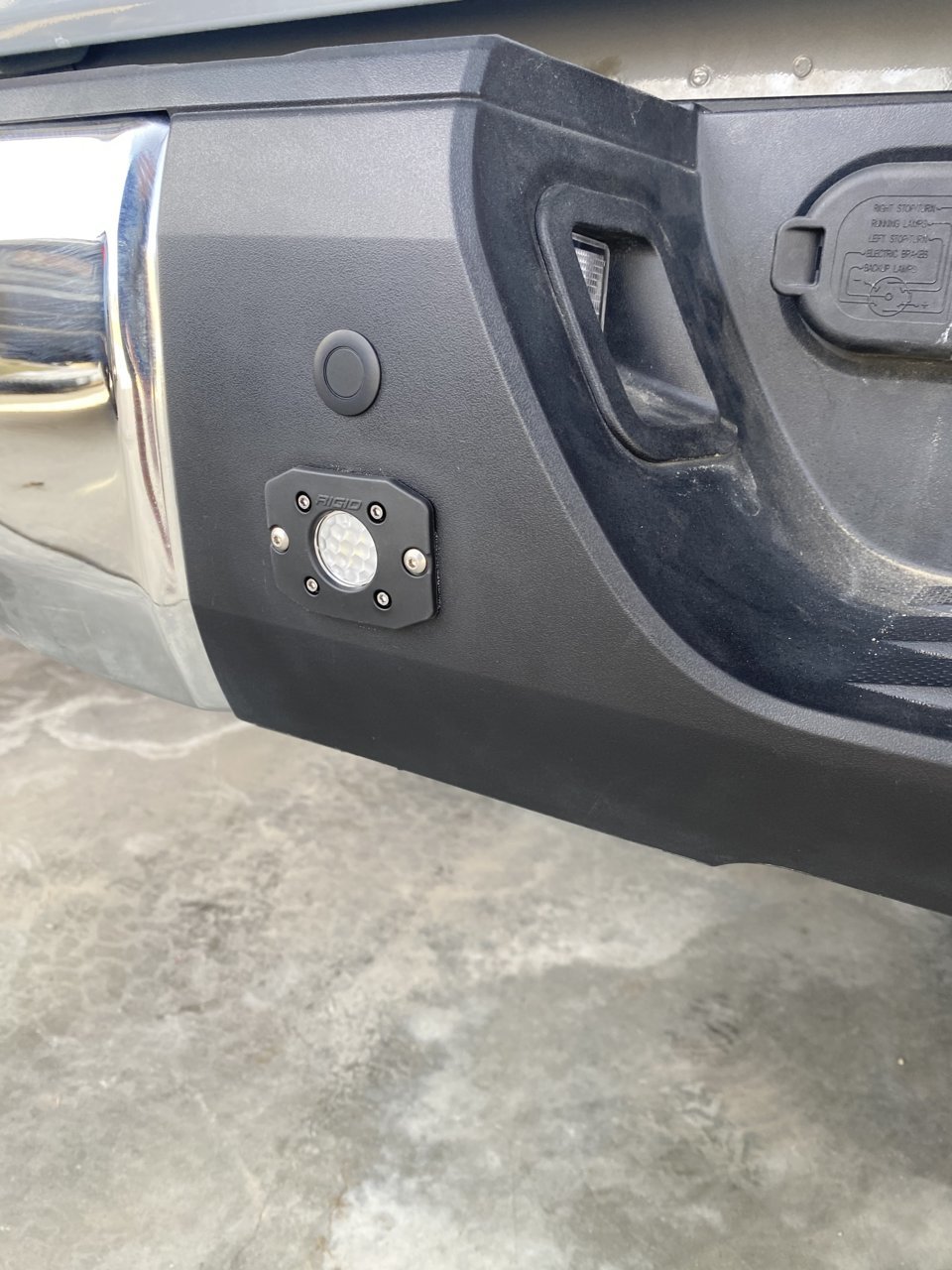

    S1 with wide cornering lenses. Did not have to cut any metal behind the bumper. Just drill the holes and mount em up. They’re little, but the output is damned impressive.
    Not a bad tailgater deterrent, either.

    <Copied from an older post I made about this>
    I’ve got S1 flush lights in my OEM rear bumper, and they don’t have any negative effect on my backup camera. Only good things, as I can really see what’s up back there now.
    Switching is a hair above average, as I like it two ways. They come on all the time when I shift into reverse, but can also be turned on via aux switch.
    To do this, I used a 5-pin relay as follows:
    pin 87A: tie into the trailer light plug’s reverse light wire. I believe it is the blue wire in the center of the trailer plug.
    pin 30: run this to the lights’ positive leads.
    pin 86: run the to ground.
    pins 85 & 87: tie these together with a short jumper and then run to your switched power (auxiliary switch).
    Wiring this way will keep your aux power completely separated from your OEM lighting circuits. When no power is put to the relay via aux switch, the 87A and 30 pins are connected so your lights are part of the OEM backup lighting circuit. Flip your switch, and the relay swaps over to the 87 and 30 pins being connected. Since it pulls off of 87A, you’re now disconnected from OEM circuits.

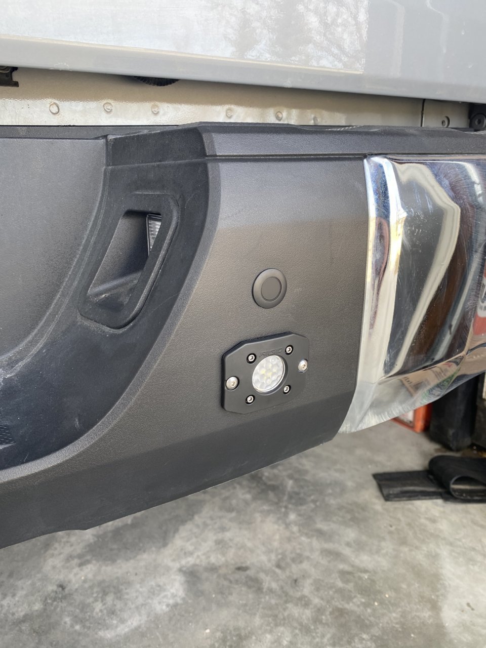

    Late to the party, but I did this. Wired into the cargo light circuit.
