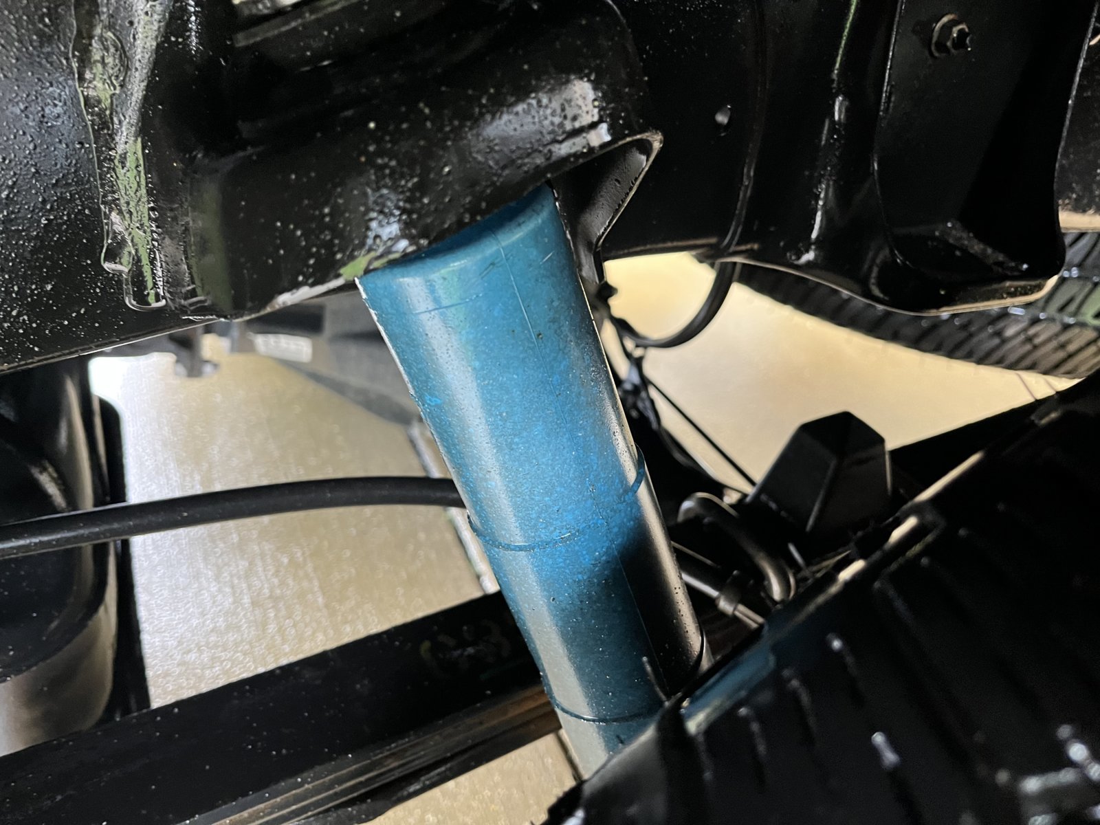

    And no fuel tank skid, and no TRD wheels.
    I’ve replaced everything that came on my TRD package except the wheels - it was $100 option on the Limited in 2017 and got rid of the 20” wheels.
