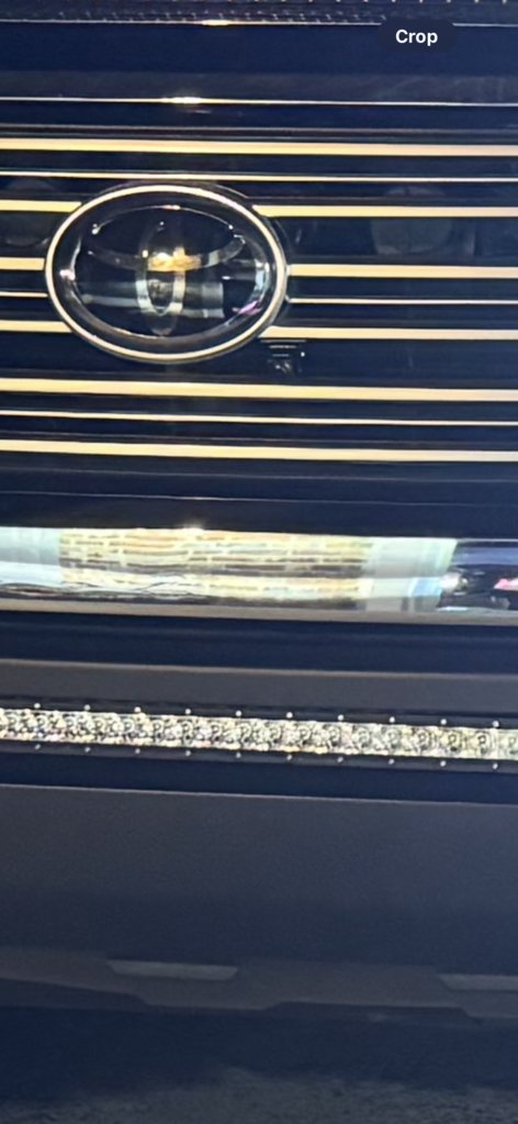

    Hello! So I’ve been searching on here like crazy and I can’t find any info… Has anyone ever put a front camera in the limited grill for the 2nd or 2.5 gen tundras? If so where/how did you mount it?

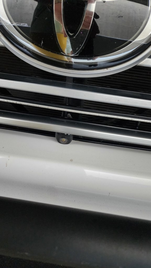

    Installed mine below the TSS sensor in the grill Emblem.

    Nice! Anyway you can snap a pic for me?

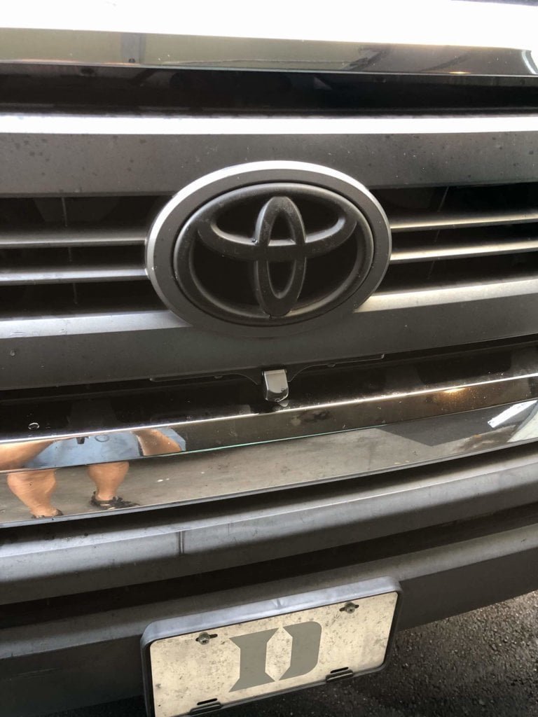

    Alpine camera
    Only spot I could put it without modifying the grill which I wasn’t going to do.

    Tuesday I will

    My TSS emblem is held in place with a black zip tie. You can't tell it's there unless you kneel down to look at it.
    I'm not gonna give a second though about zip tieing a camera to the grill so I can have a front camera.

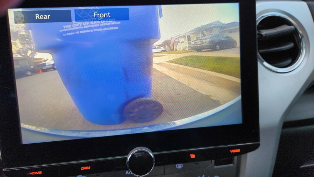

    As requested.

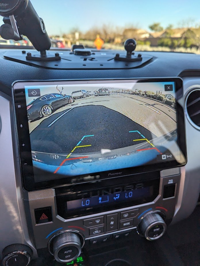

    I used a pic above to illistrate where I mounted mine. Originally I had it mounted in the grill but the parking lines were lined up too far out and it always looked like I was parking too close. Now the red lines mean STOP.

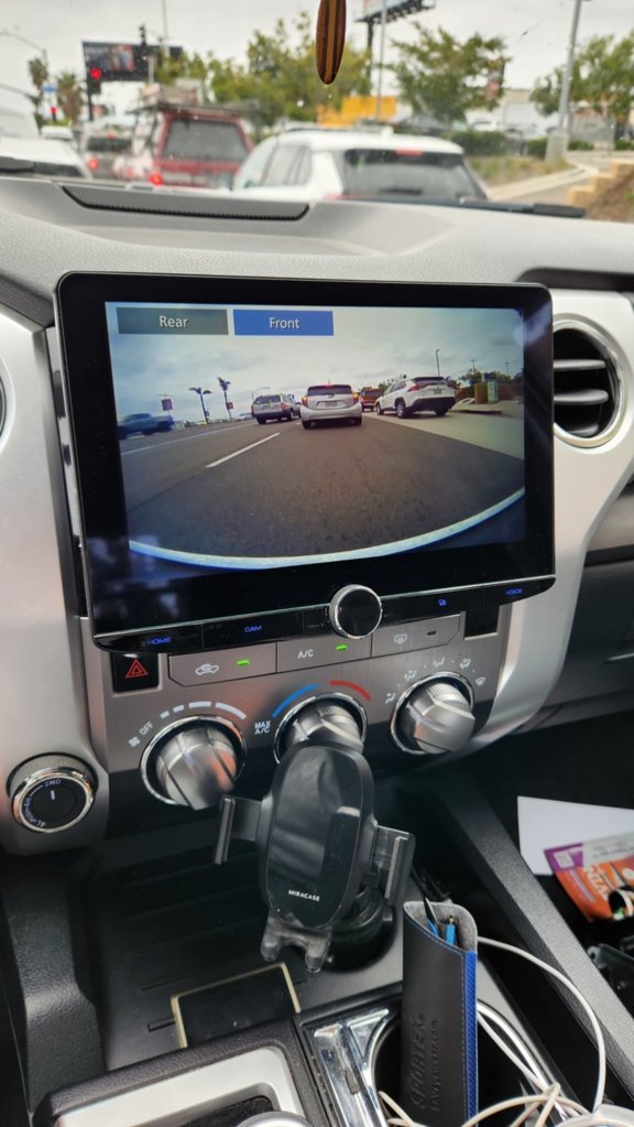

    I'm using a cheapo camera from Amazon. Its garbage quality.

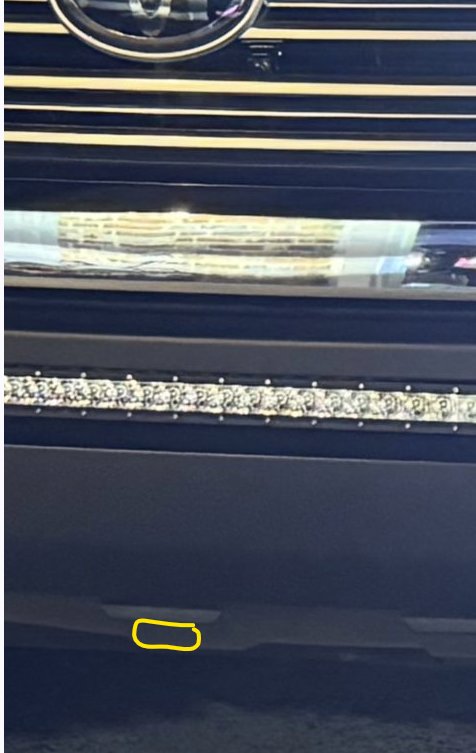

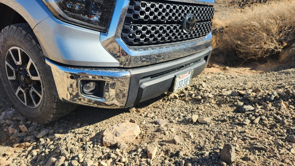

    Mine's an SR5, not a limited, but my camera is mounted WAY lower than the grill... just above the license plate/valence.
    This location works well for my needs, which is primarily parking assistance. Off road is a nice secondary bonus, not using for any "dash-cam" type duties.
    It's good because I can see the edge of the valance in the frame, so as long as I see daylight between the valance and whatever's in front of me I know I'm good. Can easily get within an inch or two.
    Having front & rear cams I've stuffed it into parking spots I wouldn't have even attempted otherwise.
