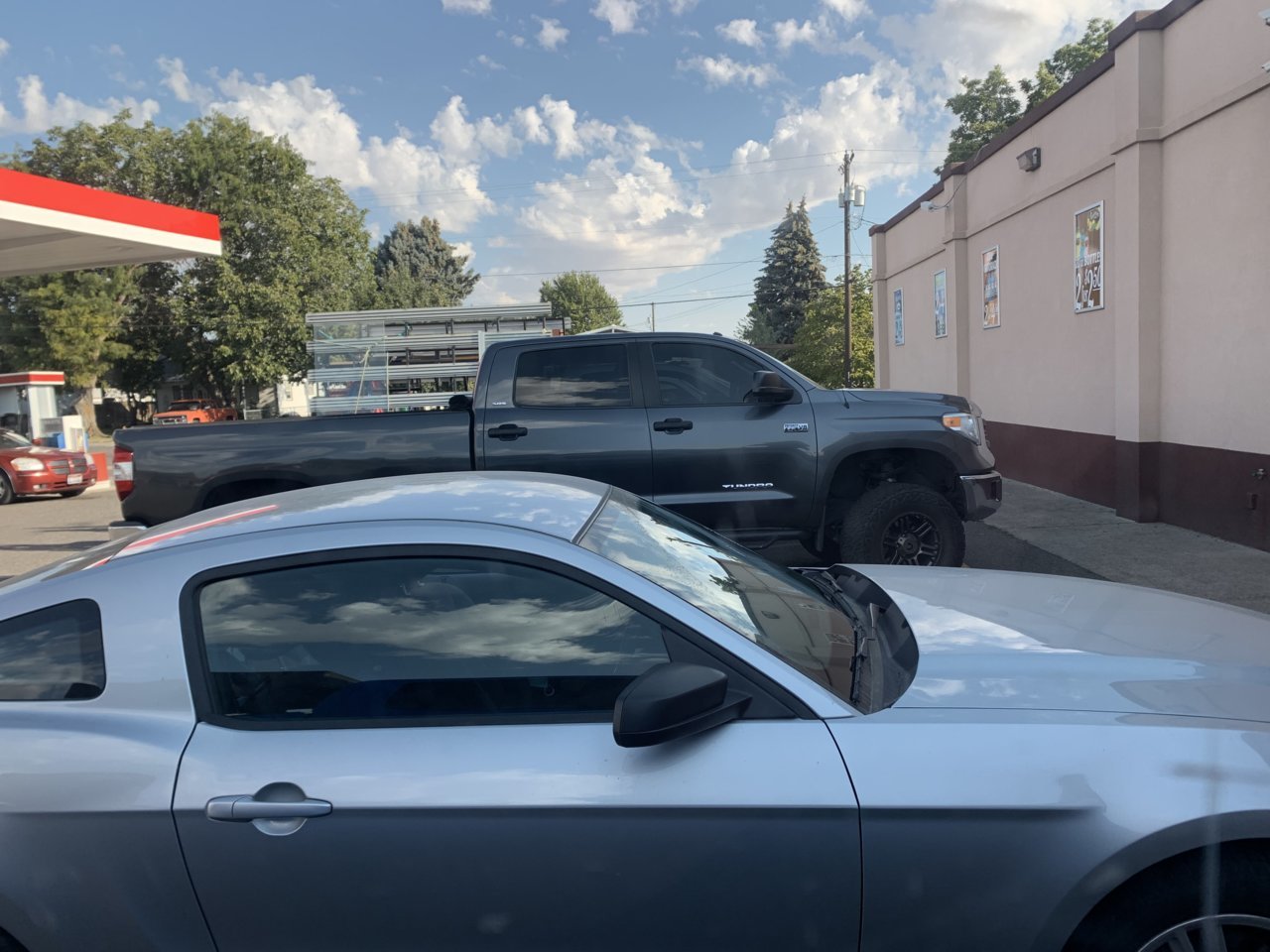

    Bolt on
    They do exist. But it's not stock, has to modded like shown above.D6391B79-8161-4564-AE55-A8409872C0F9.jpg

    This guy did a terrible job by extending a weaker part of the frame. The strength in the C channel frame under the cab is where I would’ve made the cut and extension.
    I’m doing the opposite, cutting a DC frame to shorten it so that I can install a 5.5’ bed. I think adding a 6.5’ bed to a CM would be easier though.
