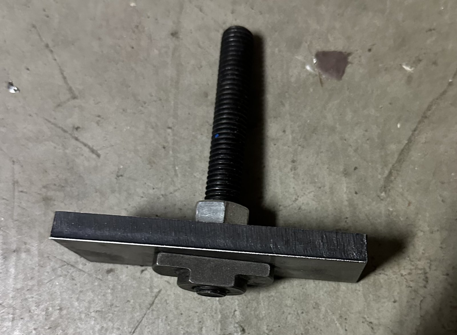

    If you plan on doing the East Coast bushing upgrade; I’m will to send my removal tool out to you to use. I received this tool as a freebie so special thanks to @Editmars
    All I ask is that it is taken care of and used the way it was designed to be used. When you return the tool, you must include something local to you; a cool sticker, beer, or beer(unless you’re from Milwaukee, I don’t want any milky beast!) or anything you feel like sharing.
    Only request the tool when you’re actually going to use it, not for an upcoming project in the months to come (incase someone else needs it sooner). Have your parts ready to go for when the tool arrives.
    PM me with your address and contact info. Happy clamming!

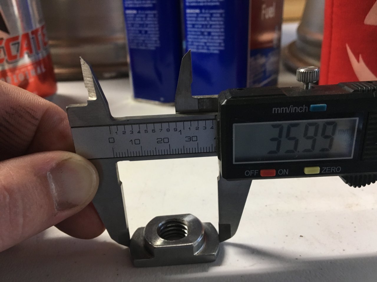

    At some point will you measure the width of the part that slips into the diff and behind the needle bearing?
    Mater[QUOTED][OP] likes this.
  4. Feb 17, 2024 at 7:09 PM
    Mater
    Mater [OP] New Member
    Feb 23, 2019
    #26579
    3,469
    Nick
    SD
    2016 MGM Platinum
    Call it 42.2mm

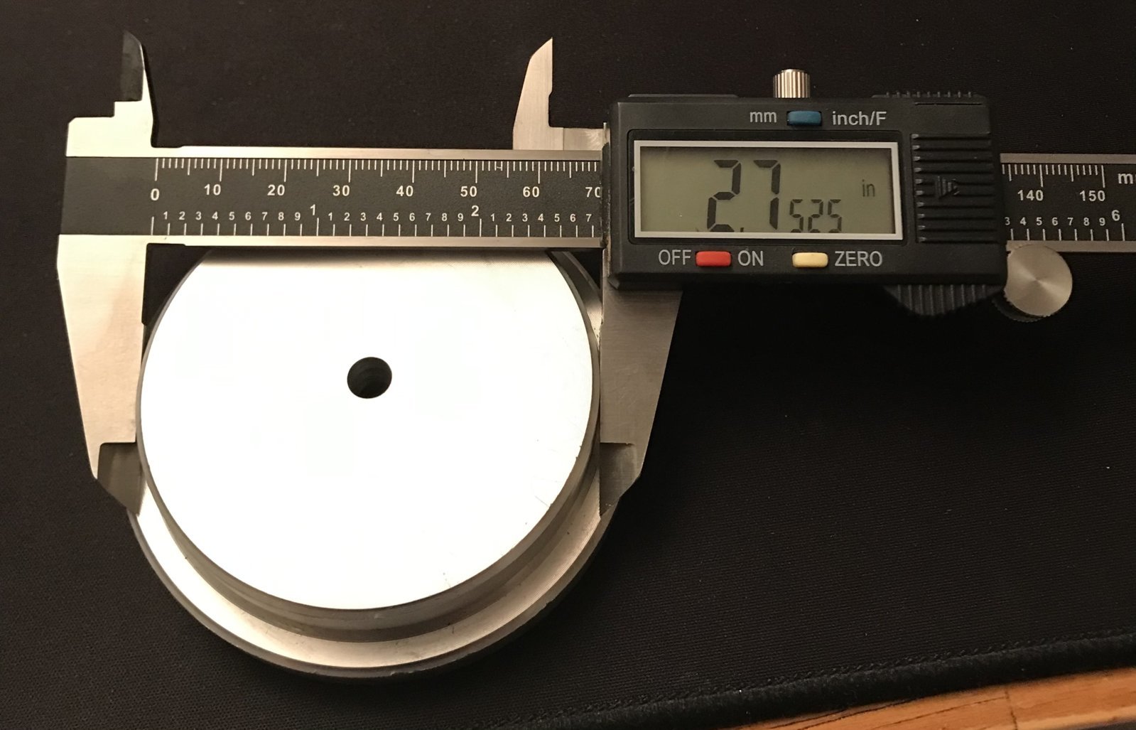

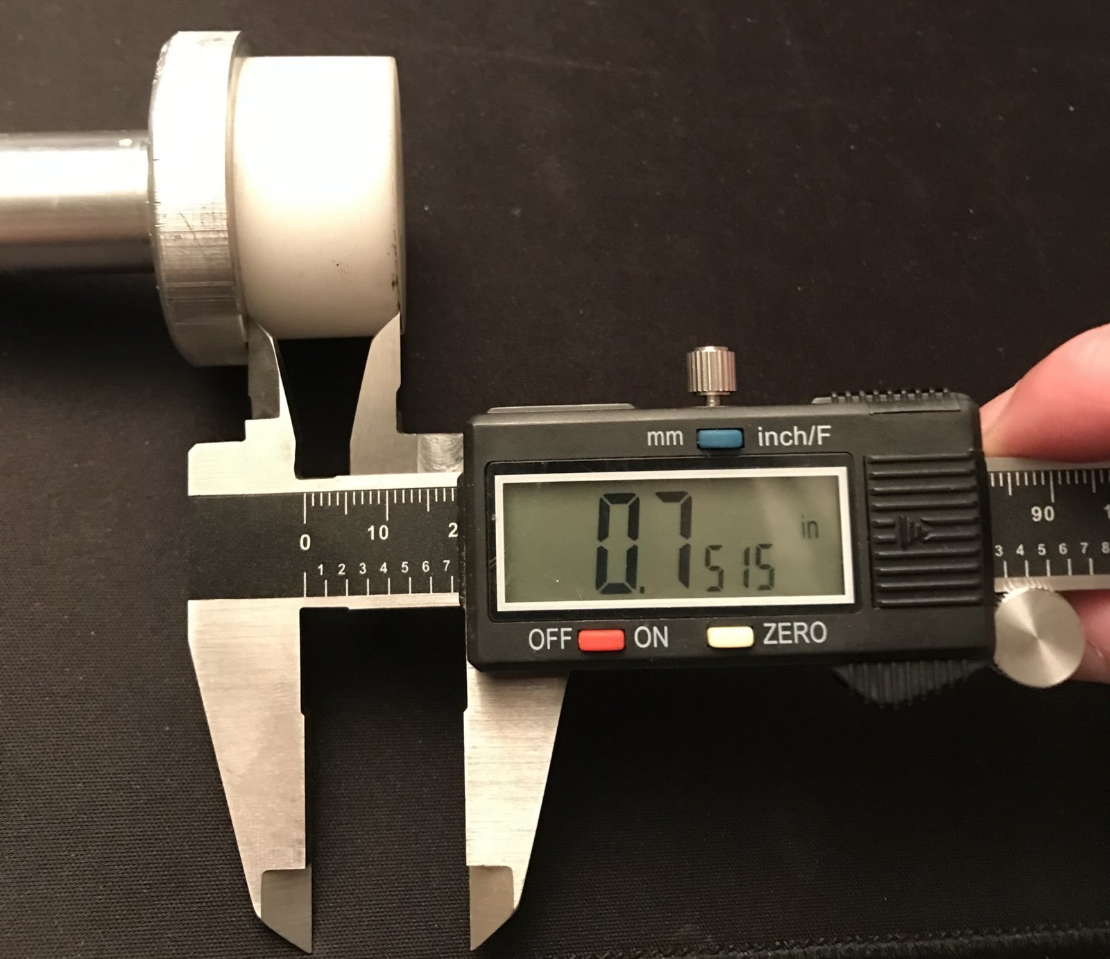

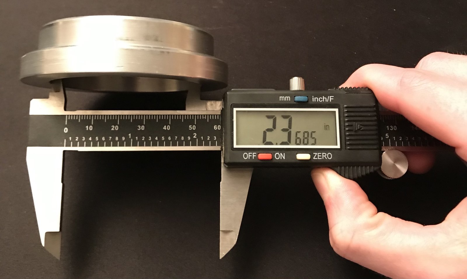

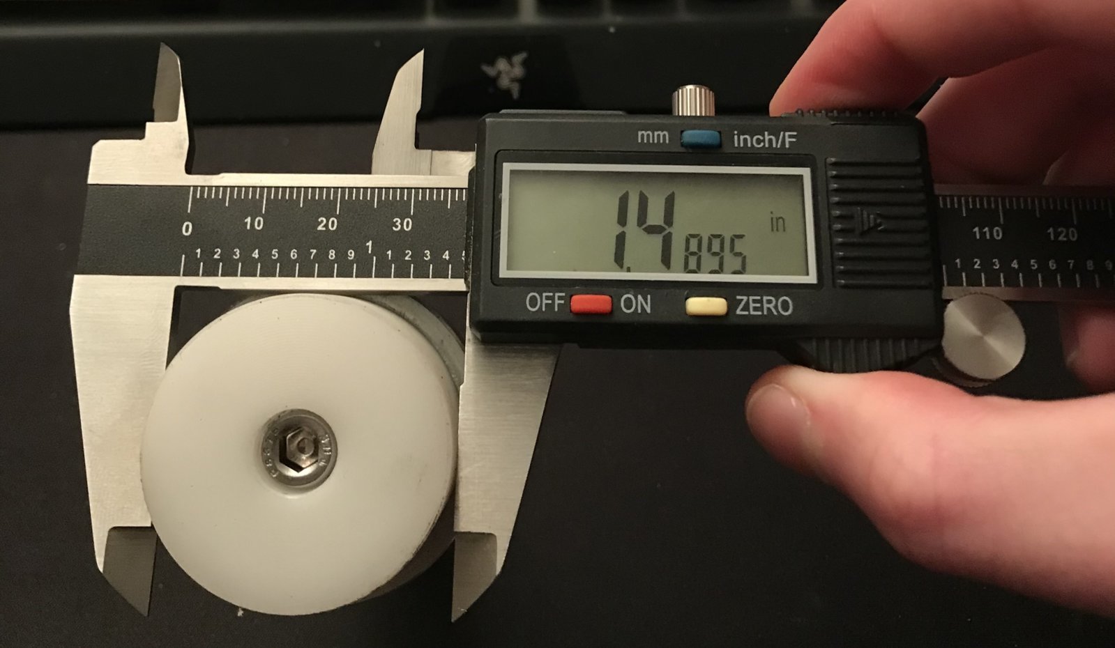

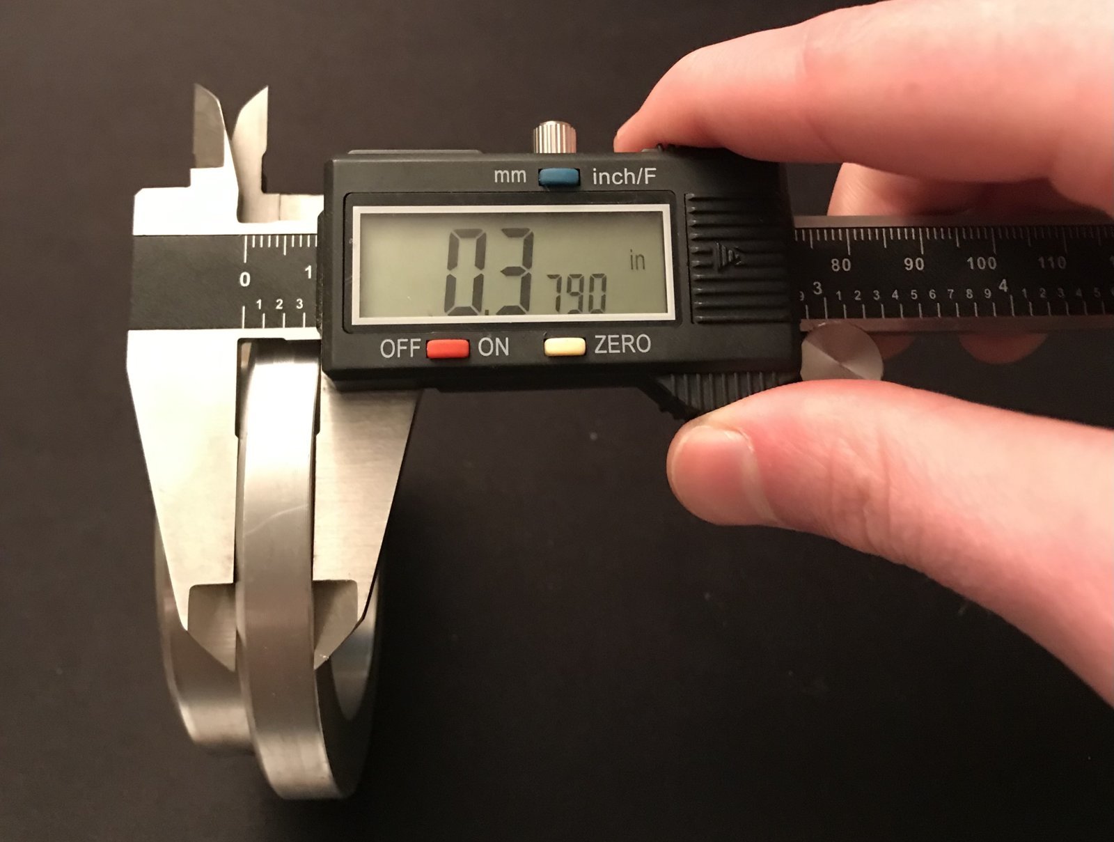

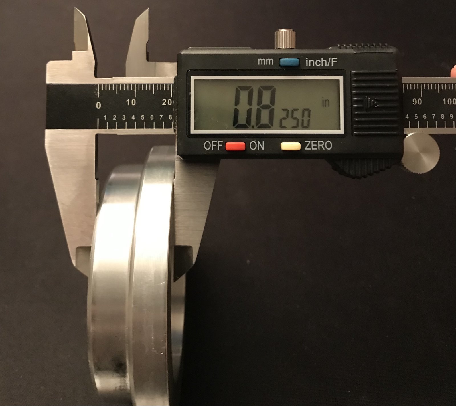

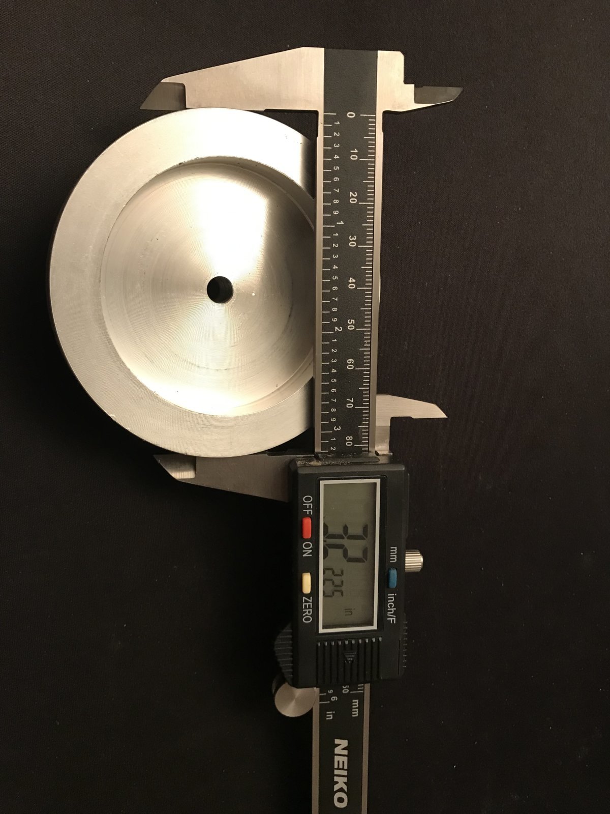

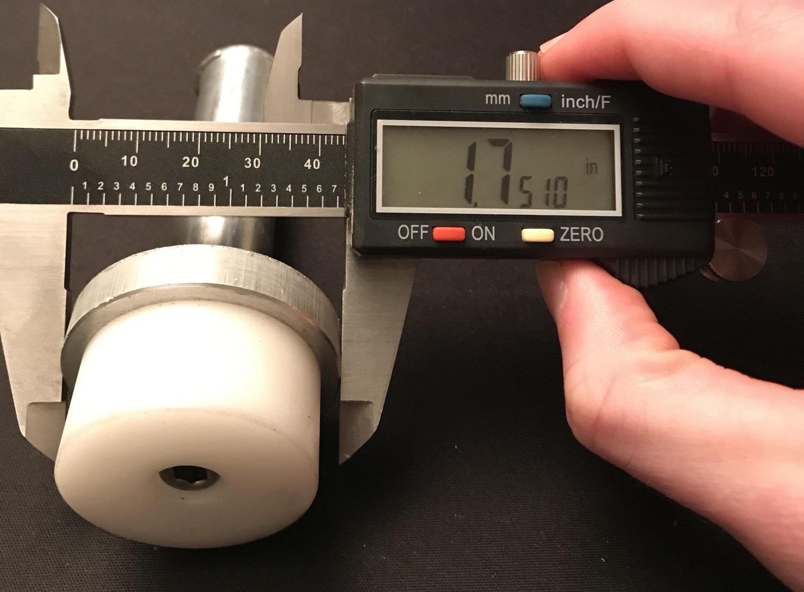

    Alright @dittothat and I suppose anyone else who wants to make their own install tools.
    Bushing installer:
    Seal installer: The depth as near as I can measure it at the moment is .375in
    FrenchToasty and Mater[OP] like this.
