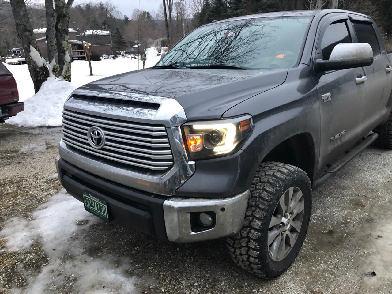

    I am running 33's on factory 20's with 2" Hub centric spacers. I had to remove the front flaps. otherwise no rubbing unless at full steer lock.lights 2.jpg

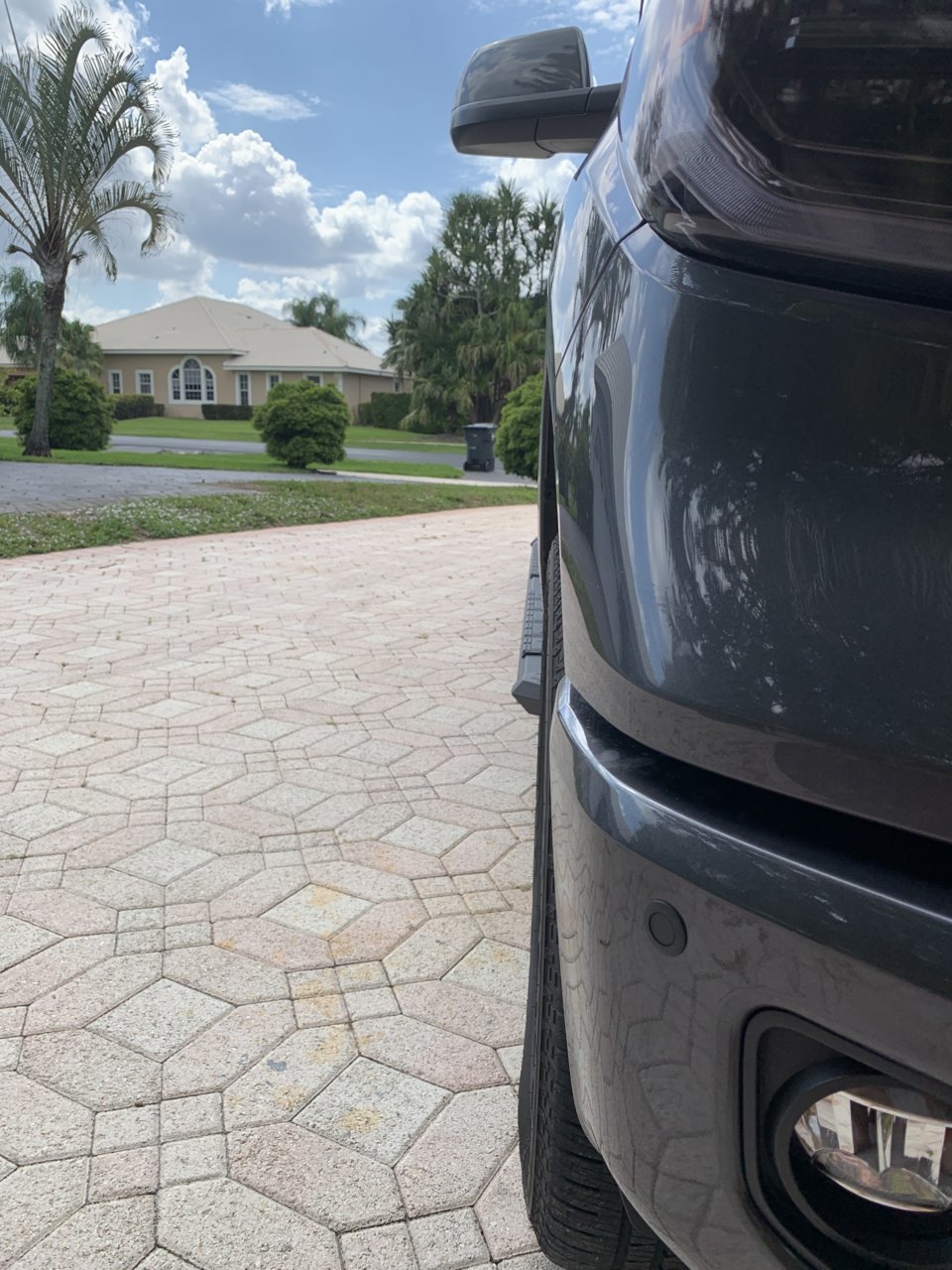

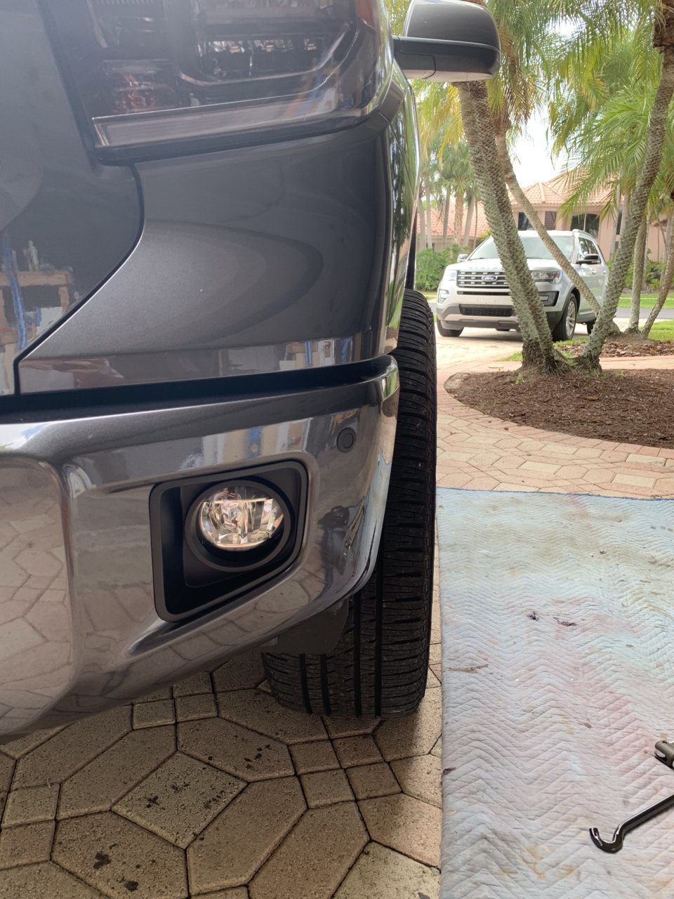

    8B1FEB99-A69F-4B97-B15B-363882BC3BA1.jpg E9BA3AC8-899D-4749-B9E1-5C3414400A2B.jpg Spacers arrived and are installed. No rubbing at all!!!! Tires are 1 3/8” out. I am experiencing a little of steering wheel wobbling around 62 mph

    Did you re tighten them after 5 miles. And I think they’re supposed to be torqued to wheel specs

    I have not. I installed them today and rode 20 miles. Have not retighten them. I will after 100 miles.
