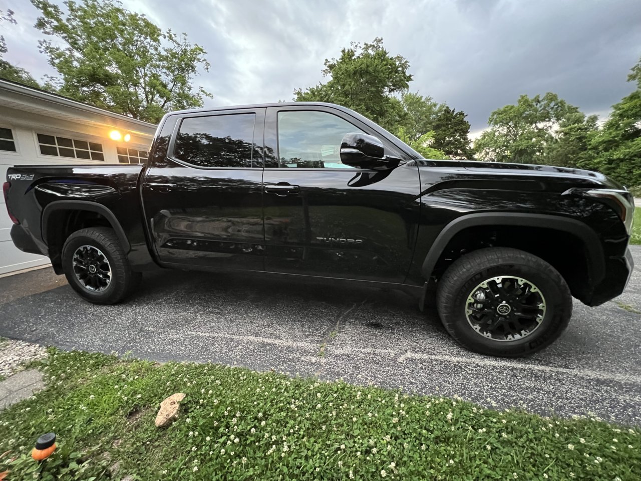

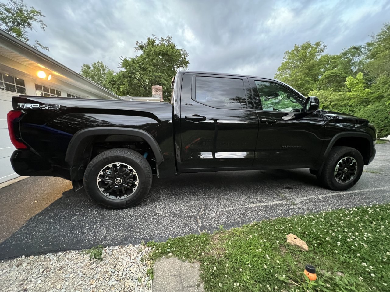

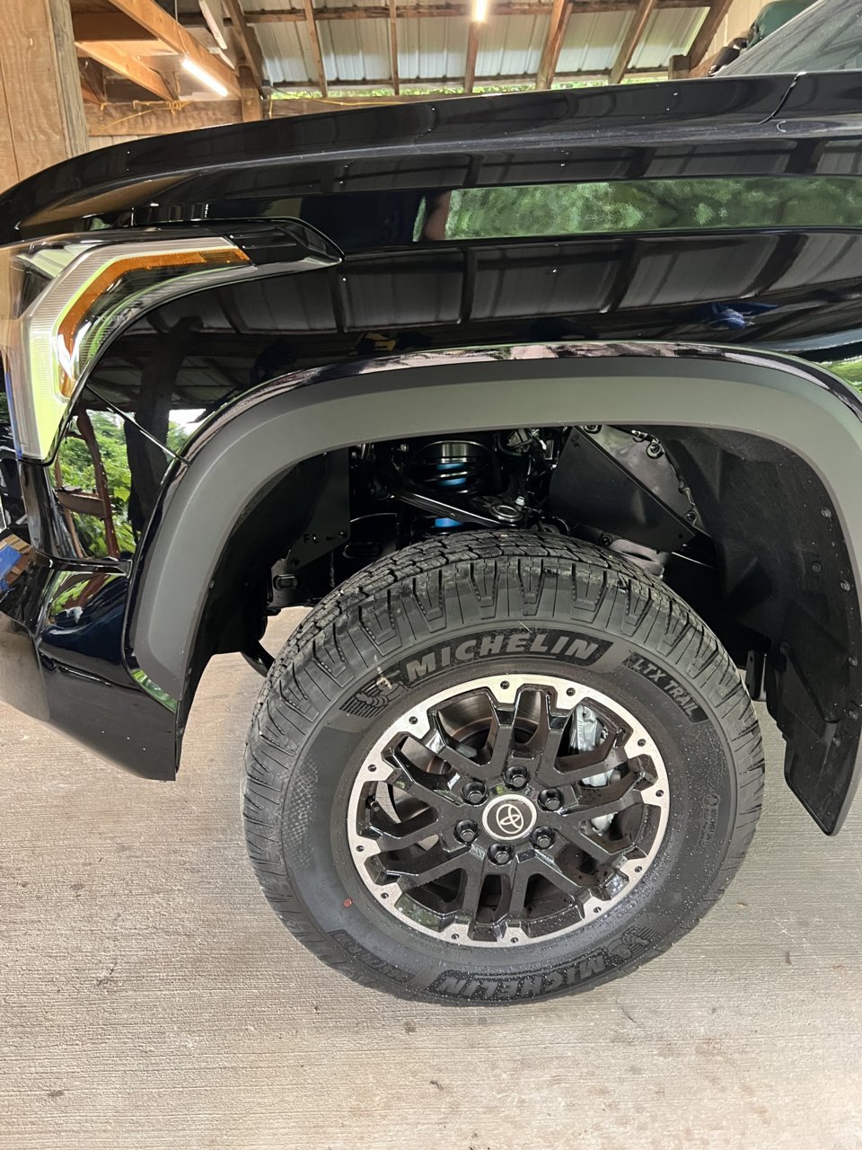

    Just got a 2” front, 1” rear spacer lift kit installed from Cornfed Suspension.
    After install I drove it 240+ miles home and I honestly BARELY can tell any ride quality difference. Very happy with the ride quality. Just a tad stiffer/springy which is expected (I haven’t done an alignment yet). This lift kit has a two piece spacer for the front, one being a preload spacer (which can be seen in the first pic). And one spacer for the rear. Can definitely feel the truck sitting taller and it has a nice stance. I like the 2”/1” setup so it still keeps some rake for towing but still looks pretty level…and it’s not overly aggressive.
    My drive home was mostly highway and was over 240 miles I avg around 19-20mpg after the lift which wasn’t any different from before the lift on my way there. I’m going off the computer though and didn’t do an actual manual calculation.
    Now all I need are some bigger tires. Anybody know if 295/70r18 will fit the factory OR wheels I have?
    here are some pics. I’ll take some better pics in daylight when I get a chance.

    So it has two spacers in front? That is, one preload puck and one that sits on top of the strut?

    Yes, the preload spacer goes on top of the strut and spring. And then the second spacer (very thin like a shim) goes on top of the whole assembly/top hat. Does that make sense?
    edit: the spacer you can see in the picture is the preload. And the second spacer is thinner that goes on top of the whole assembly which is hidden under the four bolts holding the whole assembly to the top

    That tire should fit fine

    I'm running the 295/70 setup and dig ir. Wheels have +25 offset.

    Yes 295/70-18 will work fine on your setup and stock wheels. That likely means moving to E load tires, so the ride will firm up considerably. You will notice the ride difference more from the higher load tires vs the spacer lift. Something to be aware of.
